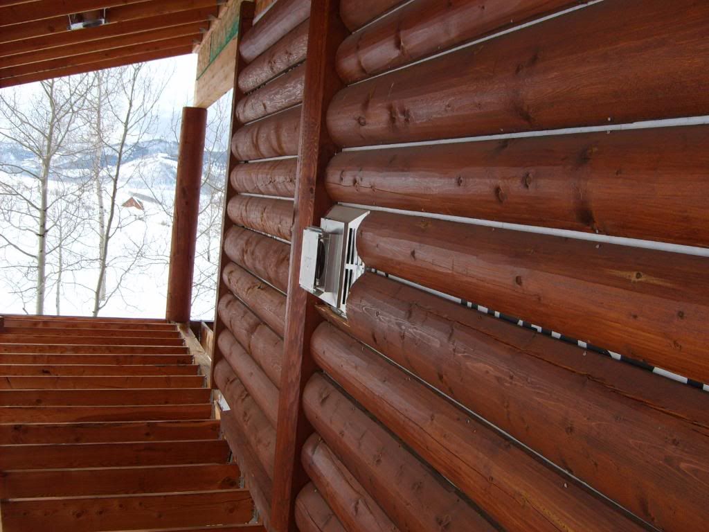

It would be a good idea to post some photos to give us a better idea of what the heck your look'n for......

As far as photos, here is a pic of the cabin, garage will be to the left there.
