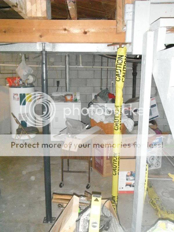

This is the attic area above the wall I'm taking out.  The roof has a 4 in 12 slope and the 2' on center trusses appear to have been built on site.  The bottom chord/ceiling joist consists of two 12' 2x4's, so the truss does not clear span the width of the house.  This became obvious the more wall studs I took out.  The roof is supported by the center wall which is supported by a girder in the basement.
I bought some floor jacks to jack up the ceiling/roof structure in order to pre-stress the truss I'm going to build in the attic.  Technically I'm not pre-stressing the future truss, but am allowing for sag to occur after building it in place in the attic.
But I soon discovered a structural issue. If you look closely, you can see the string line showing the sag in the wall plate.  The sag was there (near the front of the house) before I started removing the wall.
My house inspector had noted that the girder was not supported correctly in the basement, but until I started removing the wall above it, I didn't know how bad it was.  I jacked up the girder and put in a 4x4 post as a temporary support.
Something that both I and the inspector missed was that several of the floor joists had tilted between the front wall and the first support post.
So the combination of the girder sagging plus the joists tilting made for a sagging load bearing wall that I am now trying to remove.  d*
Again, if you look closely you can see the string line showing the upward bow in the ceiling.  I ended up putting a stud back in under each roof truss with shims of different thicknesses to support the raised ceiling until the new truss is in.
I'm making one floor jack semi-permanent at one end of the future clear span.  This is at the end towards the inside of the house.  Note that I added compression plates to chase the roof/ceiling load down to the jack.  There will be a direct load path through the end of the new attic truss into the future timber post that rests directly above the jack.
Not a great pic but trying to show the other end of the clear span.  (It's a better pic of one of the new glass block windows) I'm attempting to chase the roof/ceiling load directly down to this jack and away from the front wall of the house.  The joist tilting issue carries all the way forward into the rim joist, so I'm reconstructing a stub wall on this end which will not only move the load point away from the front wall but also cut down on the clear span of the attic truss (from 16 to 14')
The future 6"x8" redoak timber beam under the existing wall plate with two 4"x6" posts and bracing will be my safety factor for the roof load.  If I build it correctly, the resulting clear span will only be about 8' at the ceiling, but about 14' at the floor.
I realize this all may be hard to follow, but so far it makes sense to me, but I'm happy to answer questions.  If I do this right, the house will be more solid than it is now.  Except for this one area, the house has stayed pretty level and plumb for 48 years.
BTW, the timber beam, posts, and bracing are at the old rehab house where they were scheduled to support the center of that great room.  The big difference is that the '57 house has real rafters so the only load for the timber beam was the ceiling. That was about the only thing about that project that was looking easy.

Since you asked, here's a small update.  The weather is cool enough now to get back into the attic to construct the truss to support the roof and ceiling so the load bearing wall below can be totally removed.
The timber frame that will go below the truss is mostly for show and safety factor.
The first step in truss construction are the horizontal spacers near the bottom of the roof trusses.  The next update will be further progress on the truss construction.  Confused yet?  ???
