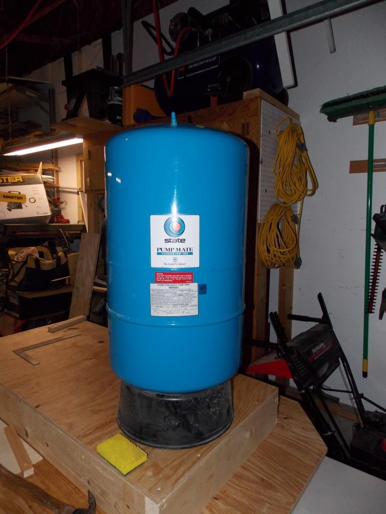

Does anyone know if I did a well point dug well if I could use an electric pump to suck up this water and pressurize this water to have running water for a sink or shower? Or at this low depth there is never enough water for that. Any well pumps I have looked at are very expensive to not even be able to be used.
waggin
I have springs on the property, so the original water supply was a gravity feed from one of those.  Later, someone set a 3' diameter concrete pipe on end in the spring depression and put a 1" PVC pipe flowing out from about 6" above the bottom.  That ran to an old water heater tank as an accumulator, then there was a filter, a pump, and a small pressure tank after that.  Now, I have an "official" dug well that is 15' static level below ground, and it is simply 3' concrete pipe stacked end to end vertically.  There's an in-well pump, and I have a pressure tank under the house.  In my area, some folks have drilled several hundred feet and come up dry, so to speak.  Can you do a dug well where you are?  Do you care if it's permitted and registered?
