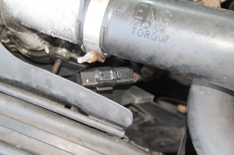

I went out to start the white beast (F250 PS Diesel) saturday to run an errand
No start   -- starter spun the engine great but nothing close to a fire -- spent most of saturday charging the batteries etc etc check fuel filter, check fuses, relays
sunday more of same
finally found an electrical connector dangling down by the serpentine belts not conected to anything
took a pic and posted to the Ford truck forum -- in a few minutes they told me it was the connector to the radiator fan clutch -- sure enough the wire was shredded down by the fan
So today I get to talk to the shop owner that changed the clutch 739 miles ago... not happy
