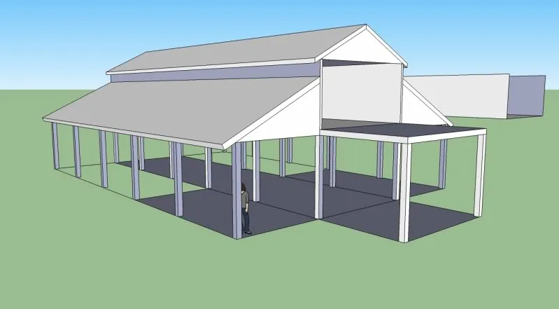

#5
I have been doing a little sketching, this is what I have. The center is 16'x 60'.  I have laid out a simple 1bed, 1bath and open kitchen/den floorplan.
26 footers with 16'posts -  not sure what size?
16'x72' concrete pad
main floor is 16'x60'
each roof is 24'x60'
there are 2 walls 5'x60'
maybe 25' of internal walls
planning on sheetrock and laminate flooring
Is this enough info to start getting a basic materials cost?
saltwater redneck
this is some basic costs that I have figured, please tell me if you think I am way off anywhere
20,000 for closed in structure w/  shingles, sheetrock, laminate flooring, deck and stairs, doors and windows
plus
elec wiring, plumbing doing as much as I can=2000?
cabinets/hopefully used=500?
appliances<stove,fridge,dishwasher,hood-microwave,=2100
bath, tub, toilet, sink= 800
16x60 concrete pad=?
central heat and air unit and ducting=?
