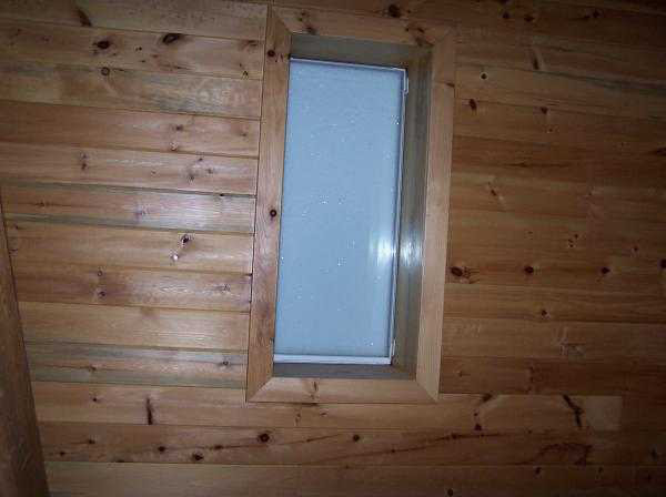

I neglected a picture of the skylight!
The outside is a typical house exterior.  Vinyl Siding, Conventional Shingles, Aluminum Soffits.  I must admit I do like the fact that the exterior is fairly maintenance free.  No need to weatherproof the outside every few years.

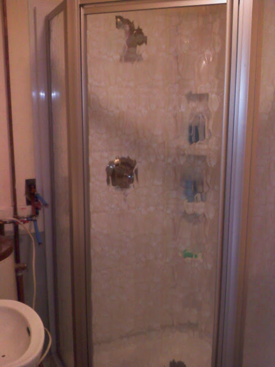

Halfway through summer, before a big weekend with friends and family coming to visit, we addressed the bathroom situation.  It was just too awkward to use, and didn't fully take advantage of the small space.
We ended up installing a corner shower stall.  I had to relocate the drain a few inches, which involved me renting a jackhammer to chisel some  of the concrete slab.  Even worse, I had to sweat copper fittings.  I know, I know, no big deal, right.  For me? WRONG.  If I wasn't such a stubborn know it all, I would have watched a video or looked for "how to" instructions.  Not me.  I need to make it up as I go.  What should have been 5 minutes of work, I turned into 4 hours.  I'm not exaggerating.  Every time I found my fitting leaked, I had to drain the entire system, because I happened to be working on the lowest point, right next to the water heater.  To compound the situation, I am not patient, AT ALL.  All of this led to what I believe to be a near perfect storm of verbal pyrotechnics.  Common expletives weren't enough-they needed to be combined with one another and merged into something far grander.  I don't know that I have ever been so ticked off, but at least now I can laugh about the problem caused by my own idiocy.  It wasn't the first time, and definitely wasn't the last.  I really need to be more patient, but I digress.  Ultimately I struggled because I wasn't properly cleaning the fittings.  Somehow, I chased down all of the leaks.  The next week I watched a 5 minute youtube video on the proper way to sweat pipes, and have since learned to love working with copper, even though I still prefer pex.  Here is the new shower.
The bathroom was just too cramped for even a tiny vanity, so we put in a pedestal sink

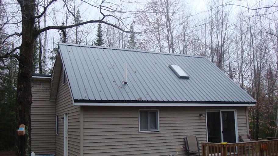

Back on topic.  Below are some pictures of the shell.  As you can see, we had a metal roof installed over the existing cabin.
A critical eye will notice in the picture below, that the siding width on one wall is not the same size.  The contractor had access to some for the wonderful cost of $0.  The color is identical,  and saved us a great deal of money.  It is on the less obvious sides of the addition.
View from the driveway
One awkward part of the tie in is where the addition roofline ties into the existing overhang.  Siding was used here.  It looks ok, and I understand why the builder did it, but it just looks a little funny to me.  I'm a bit of a perfectionist though-so I am probably being too critical.
