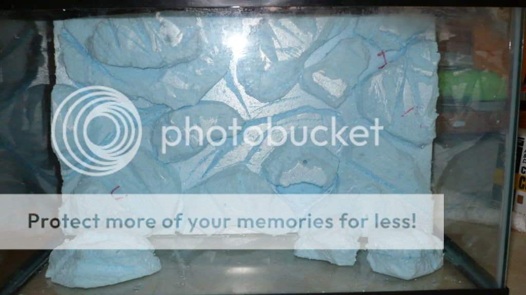

What I started with. That was 2" foam with several cut out rocks gorilla glued to the face. I also glued some to the bottom of the tank.

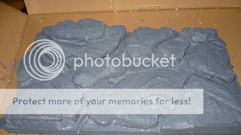

First Coat ( kinda ugly)
Dark coat goes on first. Dryloc was made for lining cisterns, and after MONTH of PH testing and heavy metal tests everything was GREAT.No dead fishes. I mixed several batches of dryloc mixed with the concrete coloring.The dryloc has a sandy texture to it, so it really helps the rock look. If you want smoother rocks, sandpaper works well.

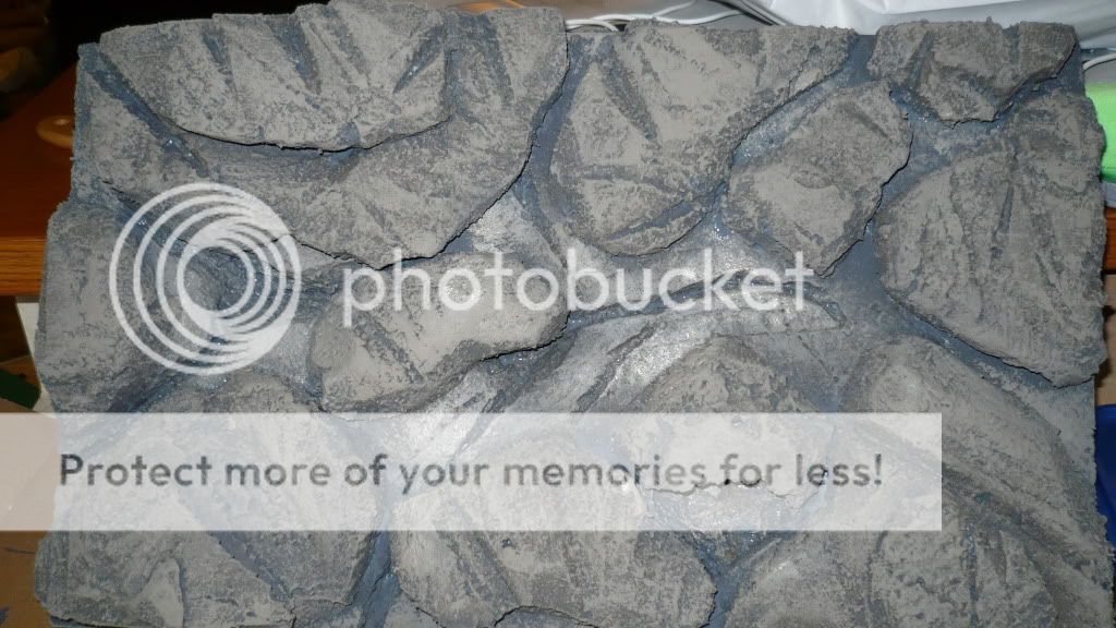

Start working up with lighter colors. It's really fool proof.
