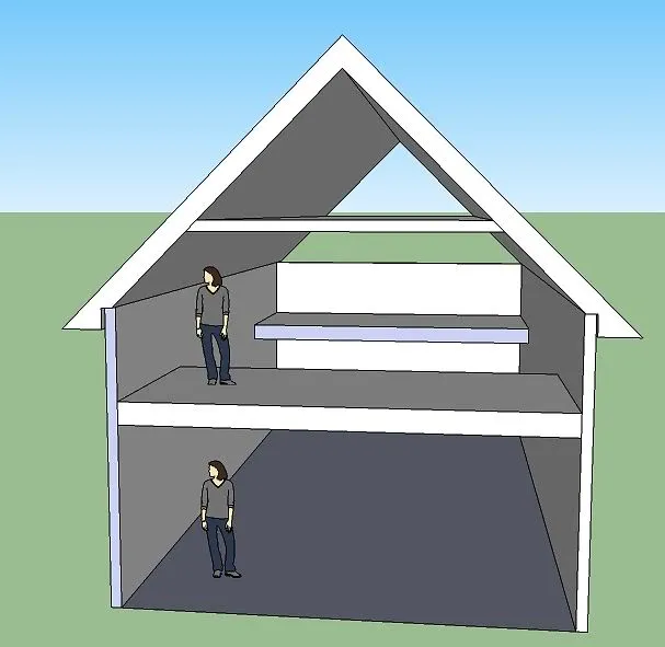

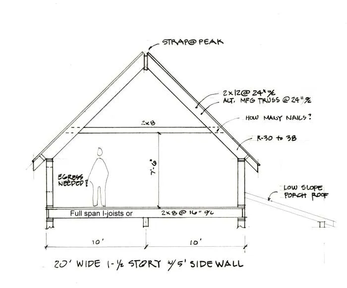

If you do a full loft plan without the tall walls in an open cathedral main floor section then you can you can have higher sidewalls in the loft and set the trusses on that. A 4' or 5' sidewall gives a nice wide loft with lots of options for dormers and windows.
Here is a diagram I'm working on for such a loft that can be stick framed.
John, the answer to "How Many Nails?" is in table R802.5.1(9)... but I wonder what happens if you design it out to the limit of prescriptive , 70 psf snow load, at which point engineering kicks in anyway. The widest acceptance for 1 plan.
For a 20' wide, framed 2' oc, 70 psf, rafter in lower third is 9@ 16d commons. A connection strength of 999 lbs Assuming they probably going to shoot it with 3"x.128" nails, 14 gun nails per end... 111lbs and 73 lbs/nail capacity respectively.
2x12 rafters work at 70 psf. A 2x8 ceiling joist works.

Thanks for helping out with that section design, Don. Good ideas all.

John, Am I interpreting your statement correctly that this modification (a 4' or 5' kneewall) can be used with your site-built trusses?  I ask because your diagram includes a ridge board.  Also, is the "hinge joint" effect not an issue with this design?  In past discussions on similar designs you (and others) seemed to be opposed to such designs.
IF the rafter ties are in the lower third of roof height and the connection is made according to the heeljoint table (read the footnotes) THEN a ridgeboard is fine. IF each pair of rafters cannot be tied in the lower third of roof height THEN a ridgebeam is needed. So yes if you take John's gusseted rafter pairs, what you are calling trusses, set them on a 5' kneewall and drop the rafter tie to the lower third of roof height, it works correctly. The code and engineering violation occurs when the kneewall height requires that the rafter tie be raised above the lower third of roof height for headroom. When that happens you need a ridgebeam and the ties are then not needed. If the rafters hang from a stiff ridge, assuming the ridge cannot sag, the rafters can not shove the walls outward. The trick is to make a rigid triangle or hang the rafters from a stiff ridge.
This is what is happening when untied or poorly tied rafters sit on a balloon framed kneewall and there is no ridgebeam;
Now think about it, if there were a string across the rafter feet the rigid triangle would restrain the rafter thrust. That tie can creep up 1/3 of the roof height and the forces can still be safely restrained. If the tie is raised above that the connection forces get out of hand and the rafter gets into one of those combined loading situations we were just talking about in the stud thread.

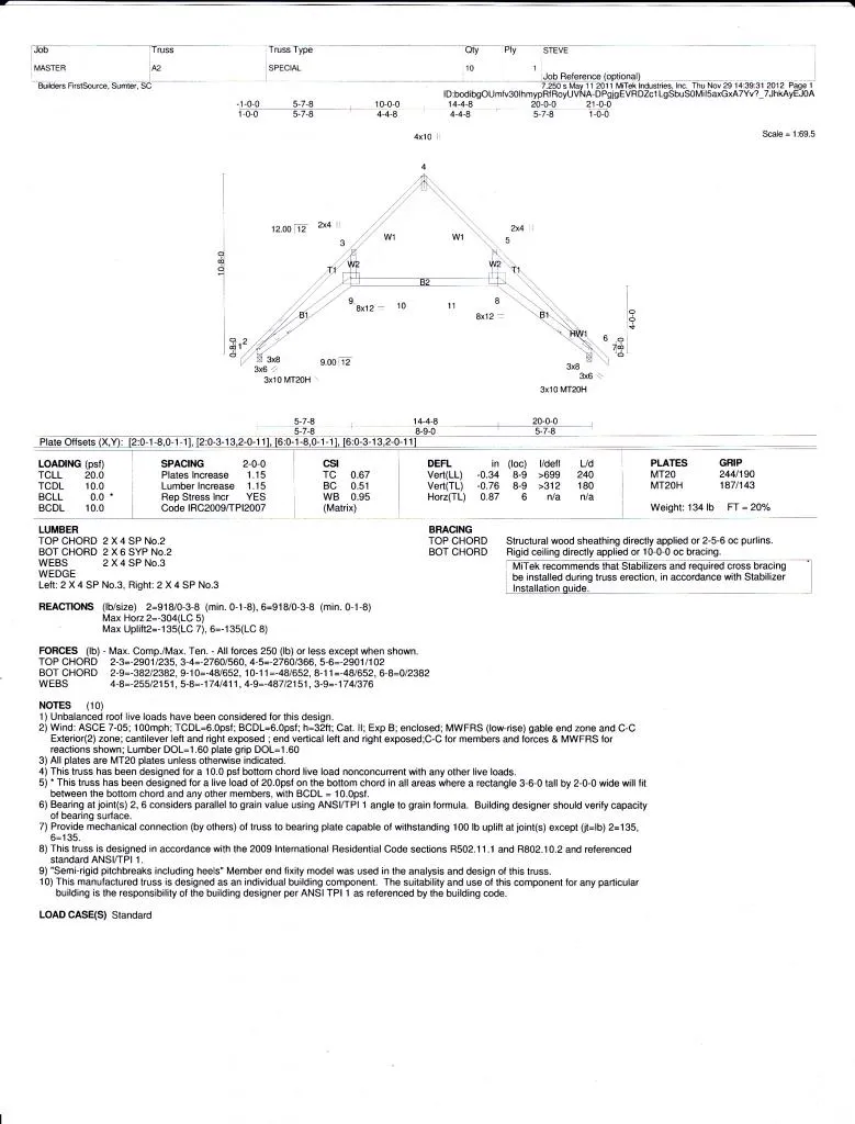

I went to Builders First Source just yesterday to price out some materials to start the build... when I asked about roof trusses he actually directed me down the hall to the engineer in charge of designing them.... I explained my house concept with dual opposing lofts and the large open living area in the middle being the 20x20 space, and this is what he came p with for an idea
There would be two different engineered trusses for the house....
the first set being a scissor design which will run 2' OC above both loft areas giving the most headroom possible
the second set being more of a vaulted ceiling truss running 2' OC across the living area made most of 2x6 #2 or better
The vaulted trusses seemed to have the cross bracing about mid height in the trus or so.... working on the theory that the firsst floor is 8' and the secnd floor knee wall is 4'.... he said the vaulted part of those center trusses would be 16' above the floor level.... now thinking the stock plan said the total height of house with 12 on 12 pitch is 22' tall...

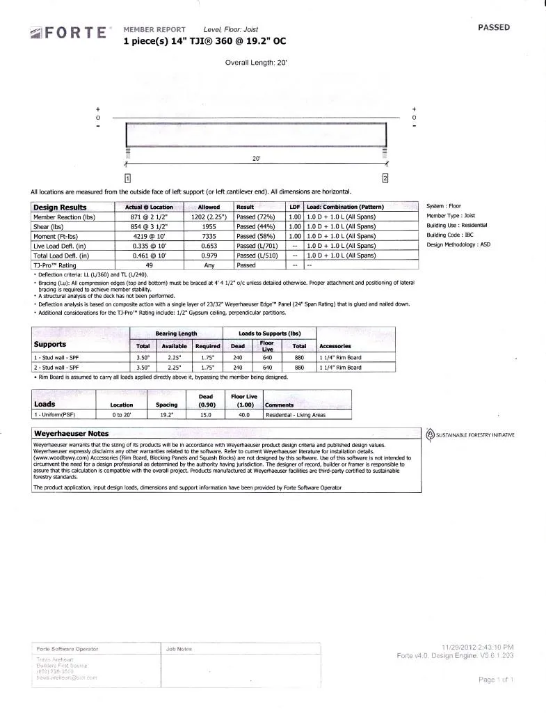

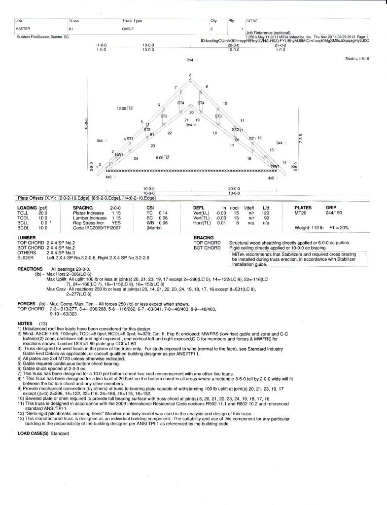

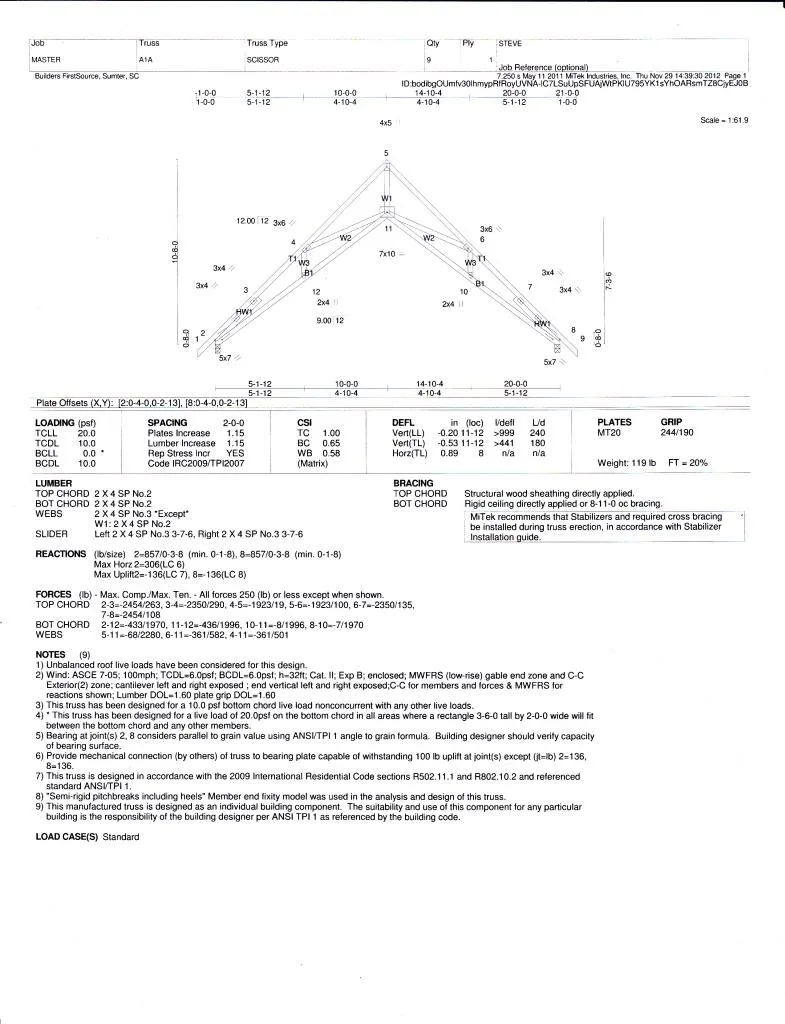

Almost forgot I had a scanner here at home.... here are the printouts for the trusses and the I joists I had mocked up for the build that we are talking about here
Could you kindly check them and see if they are suitable, safe, up to code, and feasible?

Complaints on a quick first pass thru, if you look at the deflections for both, under full load the horizontal deflection is about 13/16" and reading the reactions that amount of motion is accompanied by >300 lbs of horizontal thrust at each truss. I misspoke, these scissors do thrust a fair amount. It appears W1, one of the internaal webs is not shown on the drawing, they run from 4-9 and 4-8, the labels are there but there should be 2x4's drawn.
alternatives as I see it
1) satisfy yourself that this is acceptable... I'd want an engineer to say that if I went that route
2)Have the truss co beef the design and cut down on the horizontal deflection and reaction
3)The loft truss level ceiling chord is about 10" higher than if you were to stick frame this to code. In other words is allows you to lower the kneewalls (and the height of the house) 10" to get the same headroom in the loft. If saving 10" isn't a big deal then a stick framed roof would work.
4) But that option won't get you a vaulted greatroom, posts at gable walls and loft ends with beams at the ridge would allow the rafters to hang from the peak, no thrust and no ties needed. You could stick frame the lofts and use a ridgebeam over the living room.
I have a personal thing with 19.2" centers, I prefer 16"oc and think it washes out in plywood cuts.
Just for educational, look at the forces in the members, these are the forces the connection plates are resisting. For those thinking of building a homemade truss or maybe thinking they have built an adequate truss, notice that with those raised ties some of the connections are resisting over a ton of force at full load. Plywood and an 8d is good for about 75 lbs off the top of my head. Don't skimp and the members might need to be upsized to hold enough nails. We've had folks call some creations trusses that are kinda lightly connected looking.
On a wall thread I mentioned that wood can take wind loads better than long term loads and we are allowed to adjust the allowable loads 1.6 times for those loads, you'll see that DOL, duration of load, increase for the wood and the truss plates.

I would say that number 2 is my choice.... go to the truss company and have them beef up those trusses.... I am looking for more of the plug and play feel with just having trusses delivered and not having to build a rood on site myself, as this will be mainly done by me and a friend
I will repost the beefed up truss sheets when I get them..... assuming they beef them up, you see no issues with them sitting on a platform framed 3' to 4' knee wall atop a 8' high first floor?

Sure, if they can limit the horizontal deflection to keep it within limits... less than 1/180th of wall height. Being conservative 1/180th of 36" is about 3/16" deflection horizontally from the trusses. I think balloon framing it would be better.
