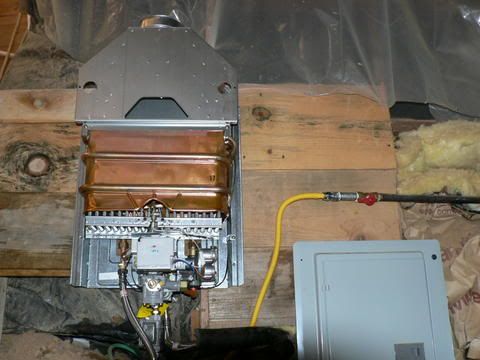

I installed it today - legal for "0" clearance even on combustible walls- it simply hangs on two screw/nail hooks provided with the unit.  Sheetrock requires a backer board of wood and a spacer to level it to support it on the studs.  Hanger spacing is 13 1/4".  It will supply 2 minor fixtures or 1 major one at a time.
Here is the unit with the cover off.

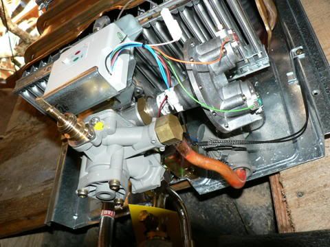

Here are the guts-- the generator - no wiring to do just hook up the gas and water lines.  This thing wants a 3/4 gas line up to 40' -1/2 up to 10 feet - over the 40' they want 1" line.  I wanted the generator model as a pilot burns est. close to $100 propane per year at todays rates.  This heater takes a 5" vent below 2000' elev.  6" above 2000' elevation.  I'm not currently running one as it vents into my greenhouse and the plants like the CO2----If I had many plants there.

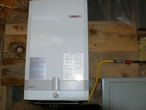

Here is the unit with the cover on and incandescent particle shield -I think that means spark catcher- on the bottom.  A little on and off with the water to reset the pilot and purge air along with an adjustment or two of the heat control knob and things were working great.  Test for leaks with soapy water before lighting up.
