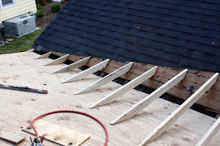

Next I found these folks blog, http://1110wataugastreet.blogspot.com/2008/05/robby-rocked-cricket.html
they did a huge cricket and followed a slightly different method than the stick framing above, but one I am intereested in following.  They did horizontal 2x4 members to create the surface structure of the cricket between the existing valley.  Something like this
(this is one side)

You could use 1/2"  ply or  7/16" OSB , although  3/4" would also work , it would just be a bit heavier to work with.  More $$ to buy
In re-guard to the single crossing "rafters" I think you'll have some trouble keeping those in plane with each other , and you'll have to do it twice going down both sides of the cricket.  If I where doing it I'd do it with 1x6 valley runs and jack rafters like the roof I tied in was done, you'd be looking at maybe 3 or 4 jacks to cut in.
But the way you show it could work, I just see more problems getting things to plane in , and as you nail them off they will want to slide down the roof , going out of plane on you.
You'd still be cutting a long slight angle and it would have to , or should be,  cut on a angle,    so a long compound cut to make either way .
But you have the basic idea and your brief process description  is pretty complete from what I see.
