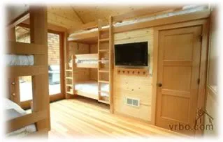

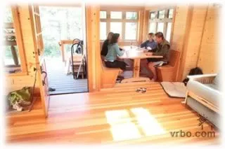

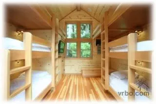

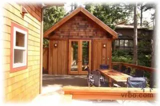

Thoughts-from-Jules
These thoughts and discussions is exactly why we are here......to gain excellent perspective and ideas on how to do this as smart as we can.  I so appreciate everyone's input.  We are thinking hard about what to do and how to do it.  Thankfully we are still in the planning stages and haven't gotten too far into it yet.  We have options, lots of them and I like that.  We worked on a plan that got us down to 1440 sq foot but I found it hard to get excited about it, there was little character and it just looked like a manufactured home rectangle with an addition of two bedrooms.  I want to be excited about whatever house we build, I have to find a way to do built-ins or something to create that custom home feel and make it more usable.  Another idea we had was a bunkhouse similar to this awesome rental house I found http://www.vrbo.com/238668
This would work well for our boys....I think they'd love some version to this and we could do it detatched (but what about heating and cooling?)   We plan to heat our home 75% with wood, only when we are gone or it is super cold would we use the backup heat pump.  Do we put in a small woodstove for the boys (they will be old enough to stoke it etc by then) or just do a wall mounted propane heater?  It just makes me nervous not having them in the same building envelope as the rest of us.  I guess we could built it onto the house so the heat and other issues wouldn't be a problem.
Also that rental house has a neat eating nook that could save some serious sq footage but I don't like how you can't get out to grab something if you are on the inside...not a huge deal but everyone complains about that and I would agree that would be an issue for us.
Anyway what do you think of some of these ideas?
Julie~        "The Future Comes One Day at a time."
