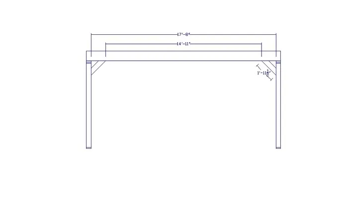

Jimmy_Cason
#4
Because I added 6 feet to my house and built an "L" shaped stair case
the area above my living room has a  beam span of 17'-8"
I have used 3 2x12s with the thought of "feeling it out" when I install to the tongue and groove plywood.
I am prepared to add a decorative support post or beefing it up with another 2x12 added to the existing beam.
Another thought is using 45 degree gusset beams attached to the two supporting columns to reduce the unsupported span.
The area directly above the beam will carry no weight other than foot traffic.
Standing on the beam at this time I get no bounce.
But I am afraid sagging over time might be an issue.
jraabe
#5
Yes, the Universal Cottage plan has both full span I-joist floors and standard joists with a beam running down the center. You can use either one (or even mix the floor systems).
My beam calc program allows me to choose a grade of wood, set up a span length, put a load on the beam (determined from the roof or floor above), specify how much deflection I will tolerate, and then set a width for the beam. Then when I hit the Calc button it gives me the required depth of the beam to meet those conditions.
And, as usual, Jimmy C. has some good suggestions. You will likely be fine with the loft loads on the beam you have. You might, over many years, get a bit more deflection than wanted but this is not a safety issue and you would really have to load up the floors to get that.
