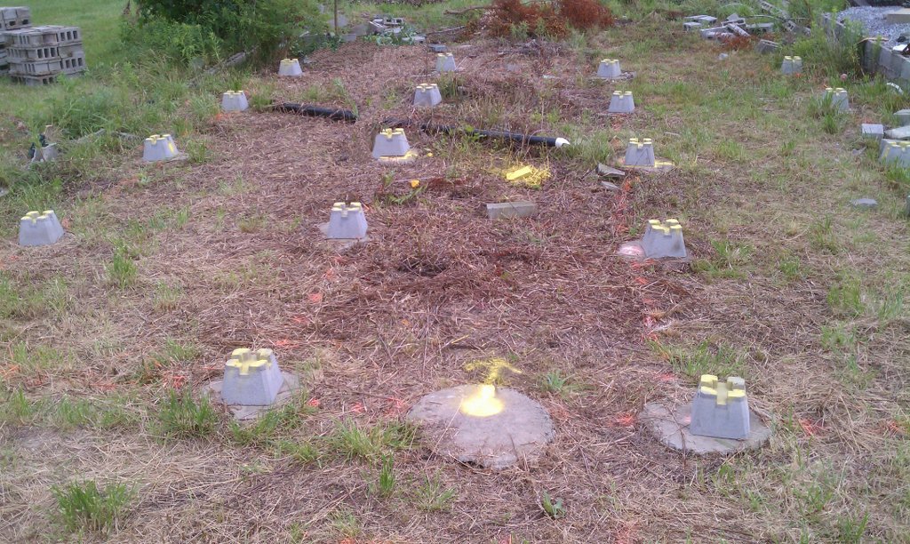

Actually, I have a total of 20 piers in my 24 (east/west) x 32 (north/south) section.  They are spaced every 8 foot  going east to west, and every 6.5 foot going north to south.  I wasn't going to use all 20 originally but now I think I might.
This would mean I would run 4x10x32 "wood" beams down 4 rows, 8 foot apart, down my  24 foot depth.
I would then run my floor joists on top of my beams with 12" centers.  Also, once the deck floor is built, we were considering anchoring the deck into the ground, much like you would a mobile home with bands, and anchors drilled down into the soil.

Texas Tornado
How about a picture showing what you are saying?
interex
It's messy as we're still cleaning up storm damage from the tornadoes...
Squirl
Ok, Let me see if I can work through the description with the picture.
First, if the concrete under the deck blocks is sunk 48" and is 2 ft around you are in great shape.  I would have just drilled into that and epoxied a bracket into them.  It would have been the strongest solution.  But I wouldn't worry about frost heave if that is what you are building over. In a high wind storm area, I would want as much as possible secured from the ground up and would not simply rely on gravity to hold the deck blocks in place over the concrete it is on top of.  Hopefully some on here more experienced with high wind can give you more detailed advice on that.
From the picture it appears that there are four spaces between the blocks going from the front of the picture to the back.  I assume this is the 32 ft direction in the picture.  This would mean that there is span of 8 ft (32/4=8) between blocks along the 32 ft wall.  I don't know what kind of roof you plan, but over a 24 ft span a gable roof is the most common.  That means there has to be a girder along the 32 ft span to carry the weight of half the roof, half the loft, and depending on how you run the floor, part of the floor, the proper safe sizing of that girder can be found in the chart I referenced above.  Most lumber sizing/span charts in the code are developed by the American Wood Council and should be used as a minimum standard for building. From the left to the right of the picture I see 3 spaces between the 4 deck piers.  I assume this is the 24 ft direction 24/3 = 8 feet span.  Under the code chart 2-2x10's or one 4x10 does not qualify for those spans on a 24 ft wide building.  Please reconsider your girder sizing or amount of piers for safety reasons.
I know you are not here to question anyone's intelligence, and I don't think anyone would interpret your questions as such.  I came here a few years ago just getting started myself.  Through the help of the others here, lots of books, code reading, and a little building I understand much more now.  Proper beam sizing is one of the least understood concepts from new builders that come here.  I recommend reading the guide on how to use the published data in the building code on them (give a man a fish/teach a man to fish).   There is a lot of great advice from the administrators of this website and professional builders in that thread.
interex
There are 20 blocks total,  4 rows of 5,  not 3 rows of 5.
If you look at the top far right of the photo, you can see there are 4 rows,  in the pic it's just hard to see the row on the far right.
From where I am standing, looking at the picture we are pointing to the 32' direction.  The blocks on the far right, and on the left run the 24' direction.
There is a row of 4 piers looking this direction spaced from top to bottom at 6.5 foot apart.   Now from the left side of the image to the right side of the image we are spaced 8 foot apart.
Here is a simple paint mock-up of how it appears in the image above...

Above I said there was a row of 4 piers spaced 6.5' apart,  I meant to say 4 rows of 5 piers which are spaced 6.5' apart, with 8' space between each row.

I still don't understand the math.  There are four spaces created in between the five blocks that the lumber would have to span. Four spans at 6.5 ft =  26 ft.  Are you calculating the size of the blocks into the equation?  If so, are you resting the entire beam on the block?  If so, are you planning on pressure treated wood?  I thought you said you were going to use a bracket, such as the examples you cited above? Or are you planning to leave the beams unsupported by 3 ft on each end?
interex
Oh crap, you're right, add in one more pier/block to each row.  That makes 4 total rows of 6 piers, making 24 blocks/piers total.  I didn't calculate right, sorry been a long morning.
There is right around 6.4-6.5 foot between each block per row... and 8 foot between each row.   Now we have it measured correctly.
