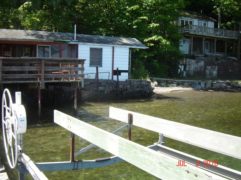

Well.... Where to begin..... Long time reader, first time poster.  I also share the common desire to build a cabin / cottage.  Late last year we went off the deep end  d* and decided to purchase property on our local lake (Cayuga Lake in the NY Finger Lakes wine country).  As with most water frontage, it has really increased in value and this has been a financial stretch for us.  So, our project will take a few year's to see completion (detail to come).
The entire property is 1.5 acres and only 98 feet wide.  Our house is at the top of the property (newer timberframe home).  To make our budget work, I remodeled the basement into a 1 bedroom apartment this fall.  So far so goo, we currently have a solid couple renting.
This leads me into the next part of the vision for this property.  The lakefrontage is an absolute abortion and is the worst looking section of beachfront for 40 miles.  I've fished the lake for all my life and hope to be a stuard to her by turning this property around.  The long term goal is to fix this area to the point we can use is ourselves the bulk of the year and rent it out a few weeks a year.
SO.......... Here it is d*
n
As you can see we have our work cut out for us d*.  At this time we are working on the garage sized building hanging out over the lake.  We have to level the building by a foot.  I have sank steel I beams in concrete and we will be attaching C channel horizontially to support the floor joists.  Quite the project in of it's self d*.
Our local county is working on an application for a sea wall permit.  I hope to complete this next winter.  There is 75 feet of lod railroad tie seawall that we hope to "reface".  We have a seperate small wood lot with large black locust.  The plan is to mill as much as we can into 8x8's and 6x6's for the wall and suppliment the rest with pressure treated 6 x6's.
Any way I'm struggling with what to do with the cottage.  It was once a camper that the prior owner took apart.  He had the frame left and sank 4x4 posts around it, put a plywood floor on the frame and put a pitched roof on the whole thing.  It does have a tiny shower, toilet and kitchen sink.  The unit is 10' wide by 40 feet long.  As you can see by the pix, I don't have much room to work with.  The road is right up to the back side and there is 4 feet of space to the sea wall on the lake side.  I can nly guess the prior owner did this to avoid taxes???
My options are to 1) work with what is there.  2) rip it down and modify a cottage plan on this site (help and advice needed)  3) rip it down and wheel in a park model camper (if we can get it down the steep, tight access road.
Water is supplied by a beach well, there is electric, but the sewage system needs help.  For now I hope to put the blackwater in a current holding tank and put in a grey water system.
Well, what are your thoughts, Thanks a bunch.......Love the site and projects!

before iron work
after
after
