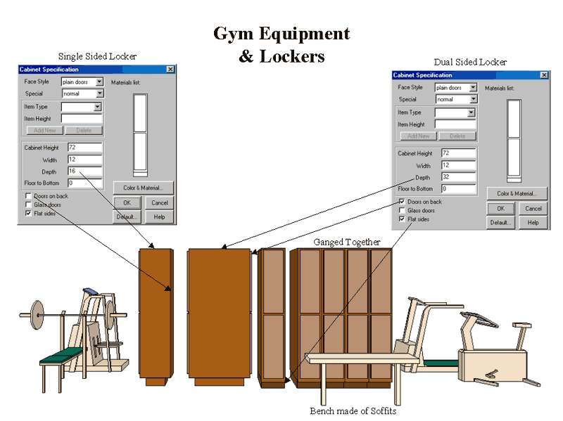

Gym Lockers
Even though this is 3D HOME Architect, you can create cabinets used in light industrial. There are very few limits to how you can modify your cabinets to create rarely used objects. This shows some Gym Lockers. Single sided and doors on both sides.

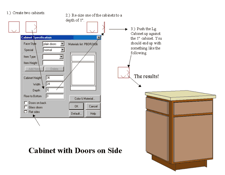

Cabinet Side Doors
You can place cabinet doors on the side of a cabinet by making a very thin cabinet attached to the side of another.
