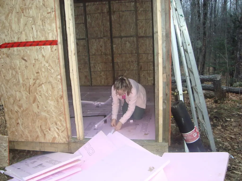

Patty worked on insulating and finishing the floor:

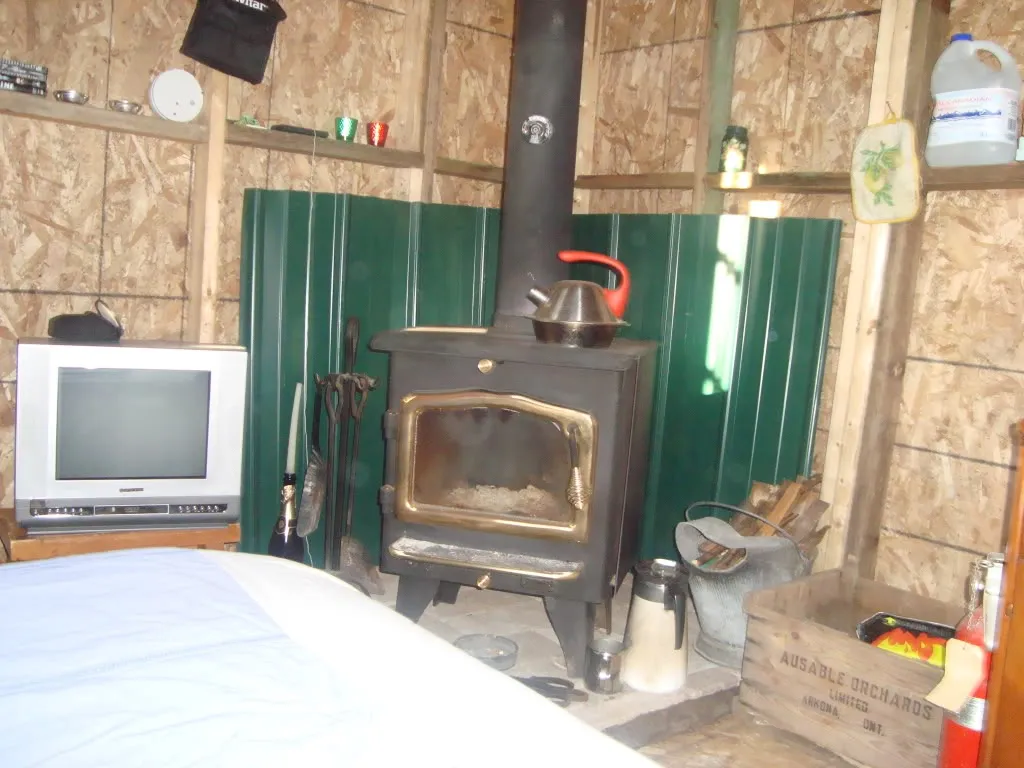

The fireplace was brought up and put in place:

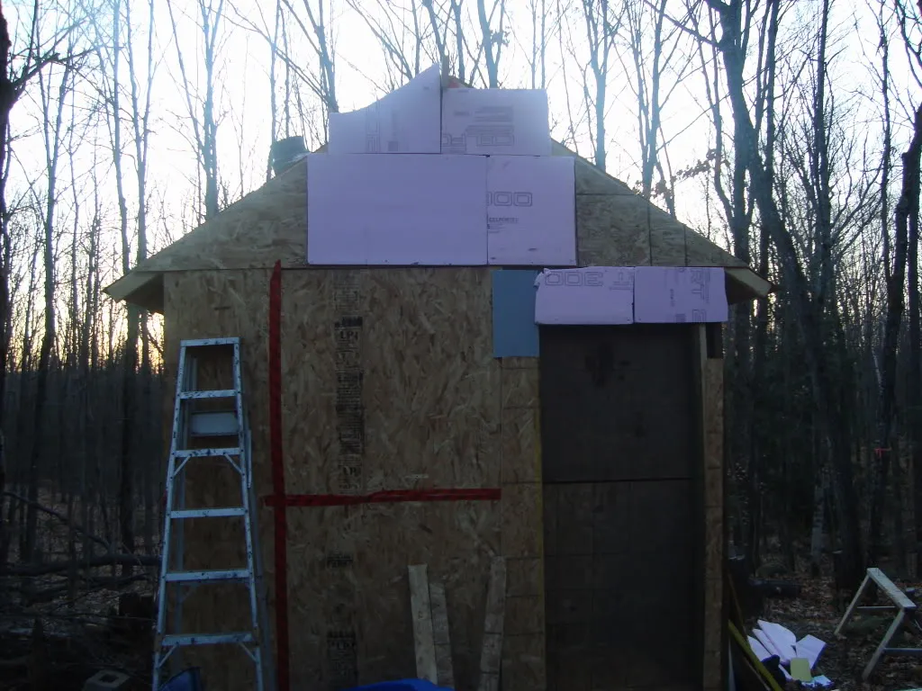

We enclosed the openings temp, so we could stay:

We installed some metal around the stove:

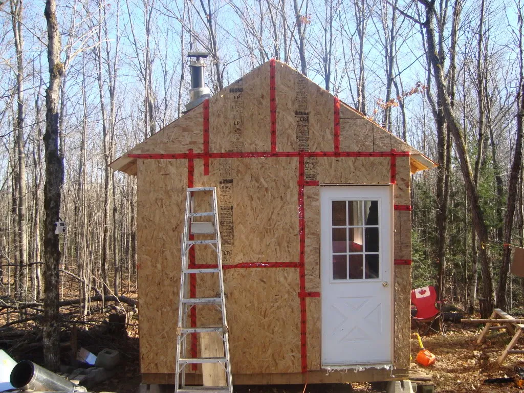

Picture from the front, with the door installed and the gable end closed in:

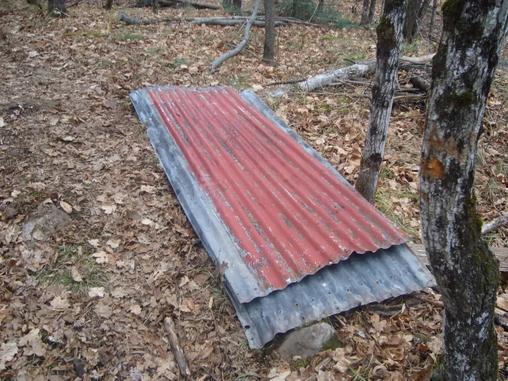

Reclaimed metal for the roof, it was on a historic building in our town at one point:

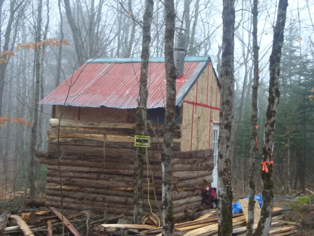

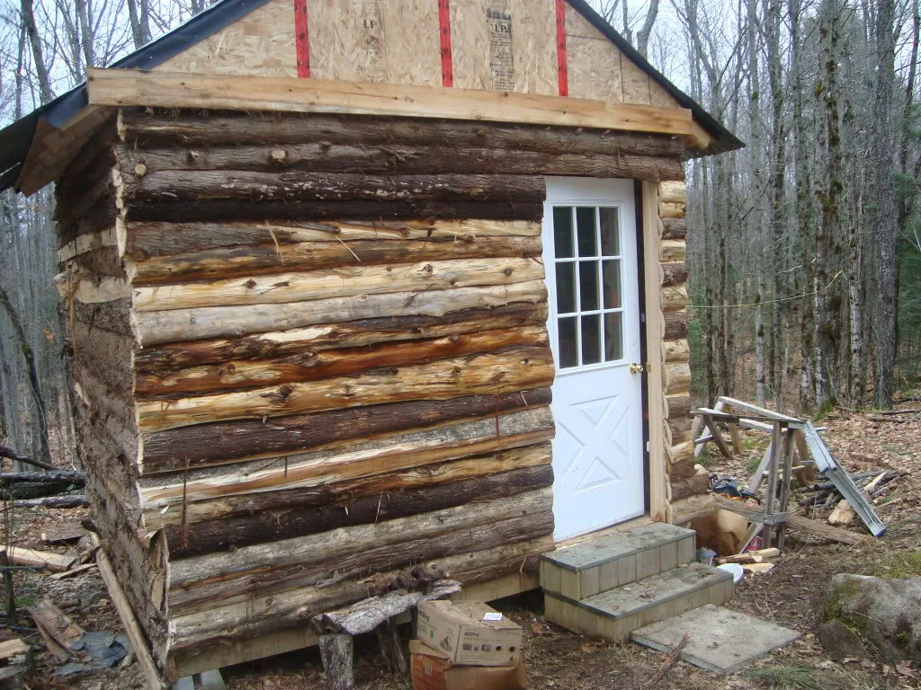

We managed to get the siding started:
Picture as we left for home:

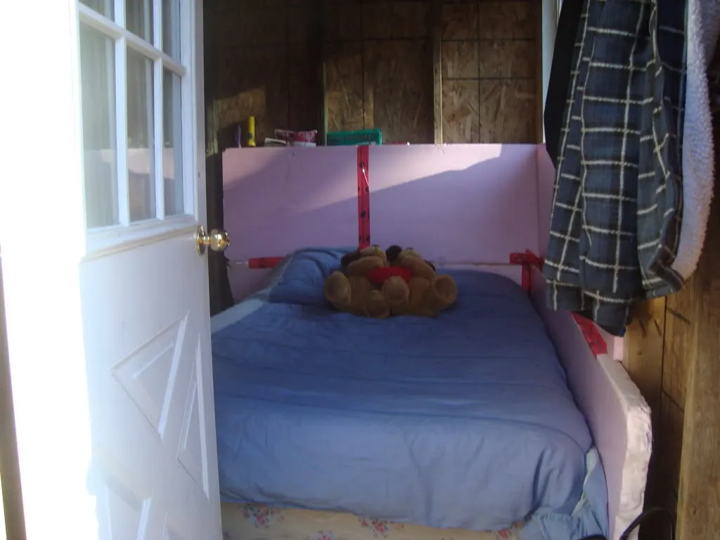

Here are some pictures of the inside... We didn't work on the loft, as we concentrated on work outside, but it was cozy and with each day of work the cabin really seemed to stay warmer and warmer...
We really had a lot of fun getting the cabin this far. Hopefully some insulation inside and some more siding will get completed in the next couple of weeks.

One thing for sure ... with that stove ... you won't need to worry about being cold.

We are planning on siding the entire cabin with the cedar slab wood, as well as a lot of the wall coverings inside will be done with it as well (peeled before putting inside though).

Here is the outside...The flat board is where the porch roof will attach...

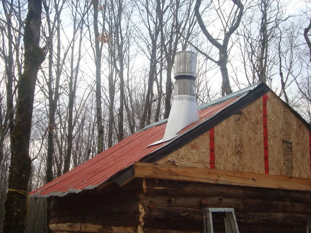

Finally found the right fascia for the stove pipe I had...

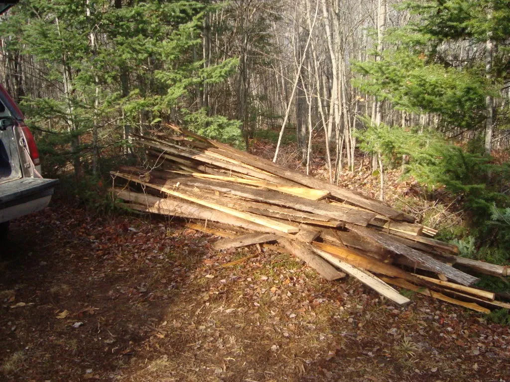

Pile of Cedar Slab wood...

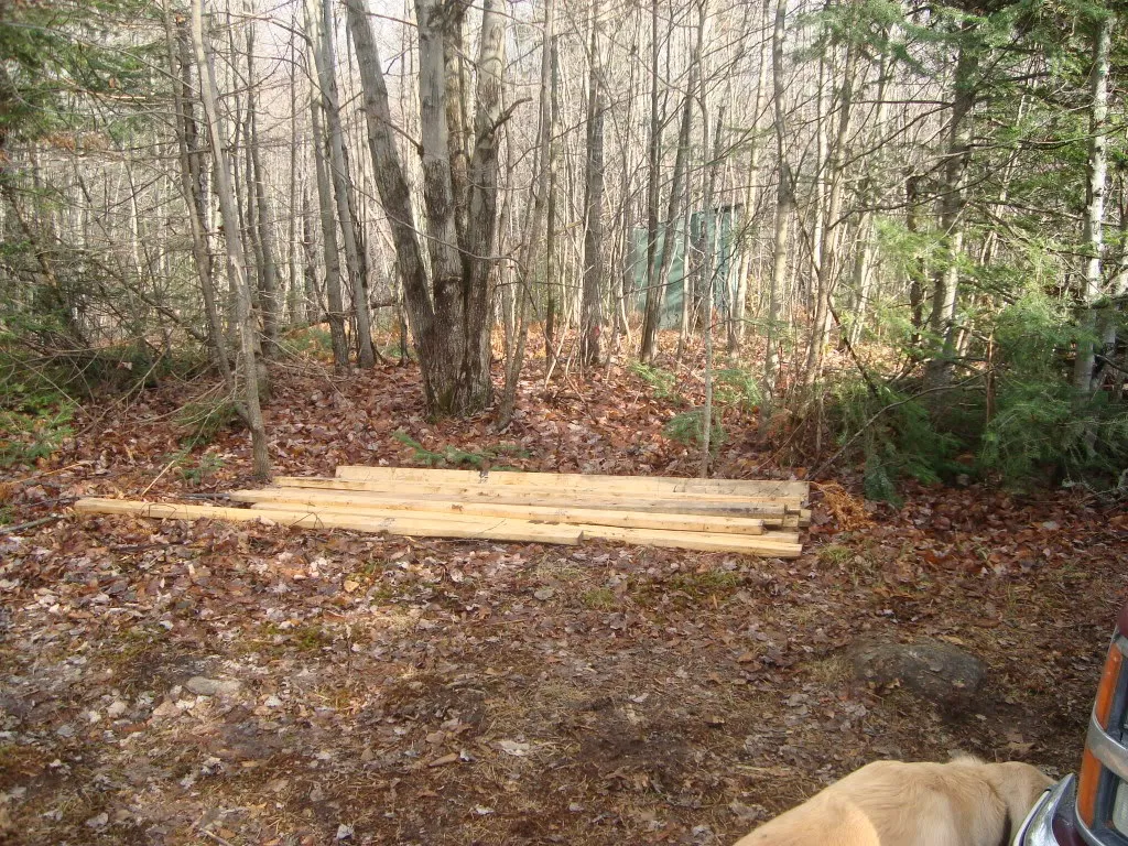

2x4 pile is getting low!!!

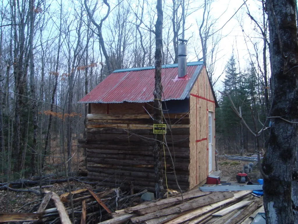

Can anyone suggest how I maybe able to extend the roof over the gable ends? Seems that I miscalculated this part of the roof  d*... Or do you think it will be okay as is... ???

I would extend the gable ends just to help keep the weather off the main structure.  I would basically build a ladder out of 2x lumber layed out like your rafters one for each side of your gable end.  Then nail them up (screw them or lag them) through your sheathing into the rafters, just make sure to spaced them down so you can continue your roof sheathing.
This is probably not very clear, but someone will come along and explain it better. d*
this might help
http://www.tpub.com/content/construction/14044/css/14044_70.htm

Thanks RDzone, that actually makes perfect sense... Another thing to add to my list of things to do lol...
I appreciate the input and suggestion.
Back to the drawing board ;)

I know it is way too late in the process for this to make any difference, but was there a reason you did not use a weather resistive barrier between the log slab siding and the OSB? It seems that water will find its way behind the log slabs to some degree at least.
