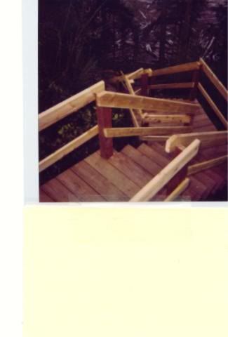

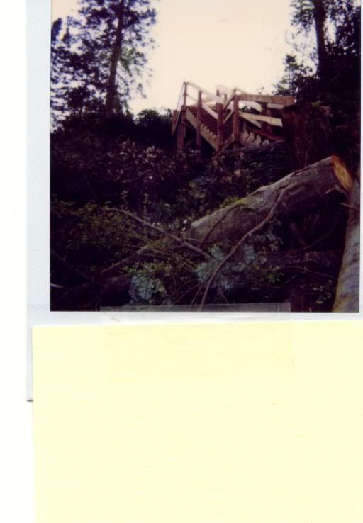

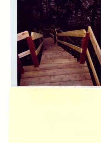

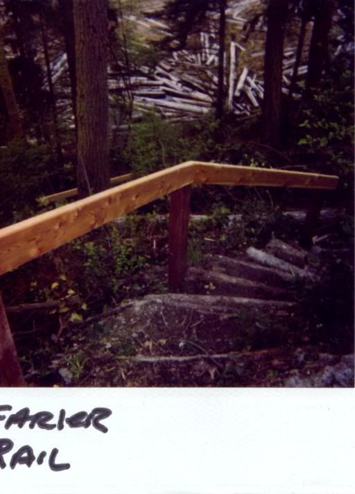

  Here's that beach stair ,
 on the steep part I  used stairs to landing on less steep parts logs to form treads  nailed in with 16" rebar spikes.
All landing post where 4x4 PT in the ground 30" or so , with 1 1/2 bags of redi mix on average per post.
Tough work , today at 50 years old , my price would be higher!
 PEG
That looks like some rough terrain!  Nice job - must have been a challenge to figure out what you had to do & then do it!
by-the-way, you sure are moving ahead in your computer skills - I guess I'm just lazy, I ask Glenn how to post pics & stuff so I don't have to figure it out...   :-/   He's been into computers for years...
That was quite a project PEG.  Some can do it--many won't attempt it. :)
