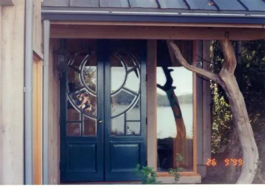

That's why I like building with trees, PEG - they grow crooked so I have an excuse. :-/
QuoteThat's why I like building with trees, PEG - they grow crooked so I have an excuse. :-/
 How about this structural post?
Now a question about it - obviously it is not graded and stamped - obviously I would use it if I wanted to - obviously it is big enough to replace a 4x4 - will a building official give you a problem with this or does an engineer have to approve it? :-/
QuoteNow a question about it - obviously it is not graded and stamped - obviously I would use it if I wanted to - obviously it is big enough to replace a 4x4 - will a building official give you a problem with this or does an engineer have to approve it? :-/
 Don't ask ,don't tell  ;)
 Just kidding  :)  I refurbished the doors in the back ground ,  made a new jamb , reglued those door from pretty much the trash heap . Micro soft money on a San Jaun Island . I wasn't the contractor, just a sub we did cabs and the door restoration , wish I had before pics of those doors , really trashed quite a job to restore them , but $ where everywhere :)
 The post did pass a inspection by the local building dept . I asked the contractor and he said he didn't see a problem , and to my knowledge there was none , problem that is  ;)Peg

About the post - thanks - that's what I thought -nice job -- once in a while you find inspectors with enough common sense to let something like that pass. :)
In fact --extremely nice job, PEG -- those doors are beauties -- they look like one or only a few of a kind at least.
Thanks Glenn  :) I think I got it still in the send typing mode the font is back to like before,  Preview is larger.   8-) 8-) Thanks again , PEG
QuoteIn fact --extremely nice job, PEG -- those doors are beauties -- they look like one or only a few of a kind at least.
 The only two like that I've ever seen . Well worth the $ to the client as they came out  of a old famliy glass business in the Seattle area IIRC. The client had passed thur them many times as a kid , they where very pleased , to say the least :) Some times I love being a carpenter/ builder / cabinetmaker / luther / furniture maker.   Well I have repaired one guitar , so I'm a sudo luther :-[PEG
