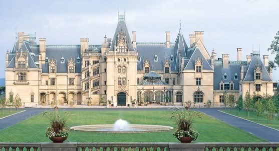

I like for stairs to have a landing partway down. I took a trip down a set as a kid, sure wish they hadn't been a long straight run  :) Structurally an articulated section can strengthen a building if done right. I know I said spirals can be tight to get up and down, but not always, 4 stories and room to pass on this set. You'd think they had enough room but even here they went for the bumpout stair tower  ;D
