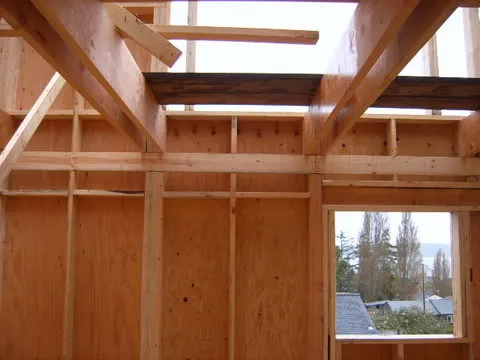

Is that a 2x4 going left to right, notched into the wall studs holding up the joists?
Thanks,
Chris
It's a 2x6 , and yes it's let in 1 1/2" . Here's the link to the total thread which you should read IF you are getting a permit and following IRC 2003.

I just read the link from PEG688 and am wondering about notching the 2x6 walls 1.5" for the 2x10 band joist. Manhattan42 said it was not allowed in the International residential code to notch deeper than 1 3/8" in a 2X6.  Is this correct?  The Victorias cottage plans are drawn this way. Just covering all the bases.

Yes Ollie that's what it sez , the job I did had engineering that over rode the basic code , the prescriptive code.
The way around it I see would be to run a 2x thru a surface planer and thin it up to 1 5/16" to satisfy the gestapo/ building official .
 Or use a 1x 6 or 8 , I'd we used that on the next job we did. This , to me , seems to be a wrong way "fix " but it did fill in / make the ledger "fit" into the STUPID prescriptive code :-[ >:( :(
You can see the 1x6 ledger in the upper left corner of this photo , the same techniques where used , the depth just changed and it fits the code ::) Which I believe I mentioned is STUPID! ;D No engineering was required for this structure. Read less $$$ those engineers really know how to charge  :o
