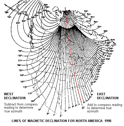

Also remember that when you follow the degrees that they are different from a regular compass.
surveys have there own system. So the degrees on your deed will not match a compass degree.
Kevin
If using a magnetic compass don't forget about the deviation between true North and Magnetic North.
Pala
Also, the USGS topo quad map will have the local magnetic delclination.  If you decide to do it the old fashioned way with analog tools.
