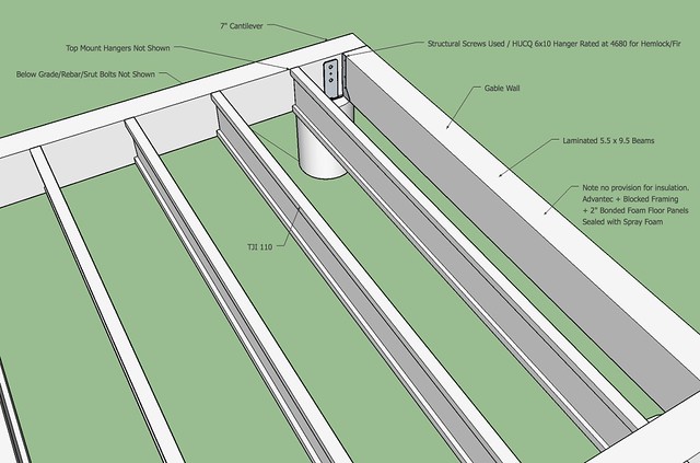

I know that most of these type foundations are built with the joists on top, which certainly makes the floor framing easier, but with 2x12 (or even 2x10) beams, that makes the deck height over 20". I was hoping to use top mount Simpsons (ITS) and 9.5" TJI's within the beam structure, but this has me concerned about gable wall bearing support. The image does not show the hangars installed, FWIW. Further, The use of rim joist and TJI requires the use of squash blocks at bearing walls, which the gable end surely is.
Also not shown are below grade concrete, rebar, and bolts from piers to welded, gusseted, 2" steel which will tie the piers together.
Is there a solution here or should I just suck it up and give all of the joists their bearing surface? I've also noticed that a lot of folks tend to cantilever a few inches to give room around the piers for skirting (it also looks better), but again, even a small cantilever on a gable end doesn't seem wise... to not follow a proper load path to the earth. We are on a mountain ridge that has very well drained sandy gravel/fragmented rock with a very high load capacity but a good snow load.
I assume most of these type buildings run the siding down to at least the bottom of the joists, so I guess it wouldn't be that bad but it seems that keeping the structure 1 foot lower would be better for many reasons.
Any advise?

A follow up question, since tying the ends of the white beams together cannot support a vertical load path, should I bother to add them for the lateral bracing, and if so, what would the attachment detail look like?
THANKS!!!

A floor system sitting on top of a laterally unsupported beam is not a good idea, it can overturn. Your way is bracing the girder at every dropped in joist connection. Keep TJI's dry and well out of the ground.

Ok, that was dumb. Here is a revised image with the current plan. My biggest concern is the cantilever and the gable wall being supported by the beam and engineered brackets. For our fir, they are rated at 4700lbs each. My total load with a 16' wide roof and given slope is 32,560 assuming a 90lb snow load. The 1/2 cathedral will be supported by TJIs faced and strapped to a engineered 9.5x14 beam which will rest on a unbroken, laminated, solid sawn column that sits right on the blocked pier.
Now, my question, will the quarter roof load be ok on this corner connection rated for 4700? My calculations say easily, but I may be missing something.
Thanks!!

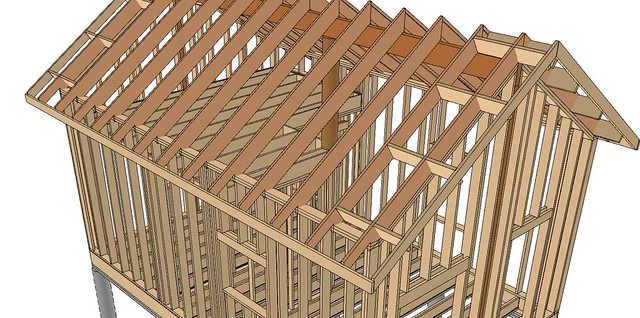

Sure, here is the framing sketch....note that this is an autogenerated foundation in this image, not the revised one shown above. TJIs on the far side of roof will likely be replaced with solid sawn rafters, though I am still contemplating facing them to the engineered beam with hangers and straps for a lower roof profile since I will be using foam sheets to insulate.

 ??? You're zoomed too tight.  What I was looking for was the reason for a gable end girder at all. The roof load is borne on the outer eave walls and the posts under the ridge. The ridge support posts should have foundation under them at which point the gable end rim can be looked at as a continuous beam supported at its' ends and the middle. It is supporting the weight of the gable wall and the overhang. If that rim is single piece, continuous, then that load is divided thus, 3/16 load at the corner connection, 5/8 of the load is on the center pier under the ridge, 3/16W at the other corner.
One more detail I'm seeing, make the lookouts the same depth as the gable subfascia, this will raise the gable framing up to the underside of the correct depth lookouts. That gable rafter becomes blocking, usually all of that is 2x6, subfascia, lookouts, and blocking. I generally use 1x8 for the fascia itself.

To your points, the ridge beam has a full bearing all the way to the center girder, however, since its a flush joist arrangement, the foundation gable girders are pieced in, held with Simpson brackets and structural screws rated at ~4700 per bracket. See first sketch on that. The lower part of that image with green background is the center girder. I figured the end girders would help with lateral loads on the foundation and also be the primary support for the gable wall, but it sounds like the primary support is the ridge beam support member and the eave walls which bear in the outer foundation girders, which are unbroken.
That all sound ok? Also, am I good to bear on that 7" cantilever on the girders?

As long as the center girder runs underneath the ridge support post the end girders are not needed. I would just use a double rim joist there. None of this contributes to the lateral stability of the foundation.
Assuming the girders are sized correctly they can extend up to their depth beyond their support with the load out on the end. Another way, load can travel at up to a 45 degree angle without needing to get fancy. If you start cantilevering beyond that it needs to be looked at more closely.
