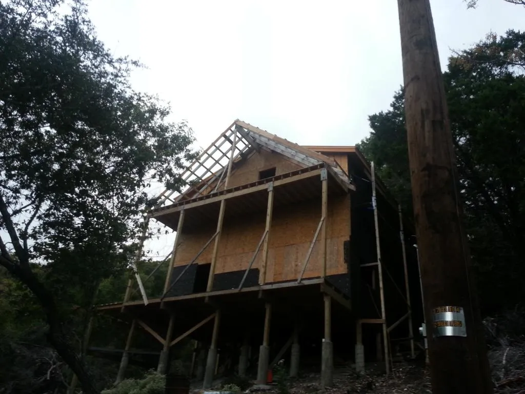

After a lot of debate a year or so ago, I decided on a pier foundation. A dozen big storms and one tornado later she is holding steady. Lost some nice trees though  :( Here are some pictures, in no particular order.

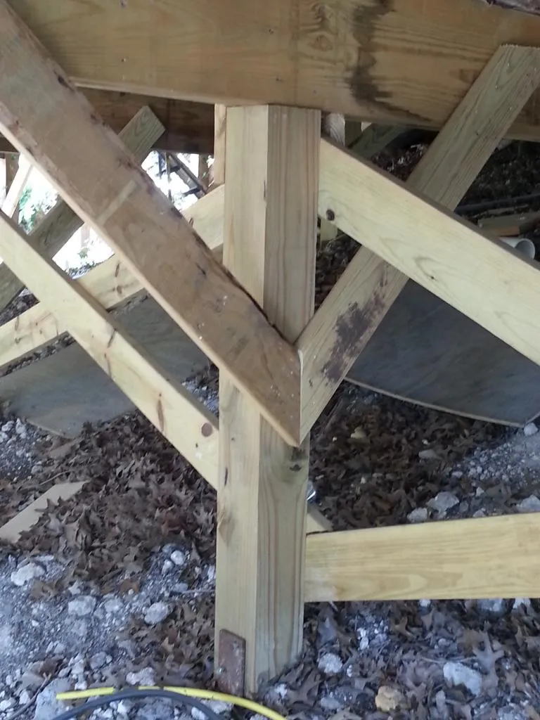

Here are some more up to date photos including bracing and split level detail....even after the split level my post where to high for my liking on the front. I drilled holes in my pier footings and added some rebar, then poured concrete up the post to shorten the post height.
I know that pier foundations are not ideal, but I have a ton of water coming off the hill behind me and I was scared of a concrete wall trying to hold it all back. Any ideas on what else I can do to strengthen my foundation? I have had some crazy high winds and if I didn't have a metal roof I would not have even known it. The structure doesn't move, but you guys had me so scared of pier foundations before I started this, and I was hard headed enough to do it anyway, just want to make sure I am still on the right track.

The front of this building is higher than I wanted, even with the step down. I think I will pour a continuous step footing under the first half of the house (the tall part) above grade and then build a stem wall. That will give me an area for storage, or maybe even finish it out and make a man cave. I can then divert water from behind that with a drainage system and maybe place some shear panels on the remaining piers in the back. After that my tallest pier would only be 4 ft above grade and the entire downhill side of the structure will have a proper foundation. Just to tall for my liking, even with bracing.

That's what I was thinking also, that's a lot of unbraced concrete out the ground and they look small in diameter for that much building above them otherwise I like the landscape was wondering where and how did you get the massive retaining blocks around the driveway? Those are pretty cool.
You've done a great deal of work and the site is both awesome and frightening.
I would suggest talking to a geotech or soils engineer about abating or diverting the potential for water damage. You should also have the foundation looked at by someone with structural design experience on hillside pier foundations.
I'm not qualified to give advice on this project, but the house below is an example of an engineered pier and beam foundation. It uses metal plates and bolts to reinforced the connections and joints where bracing and support members connect. You can see how that adds a great deal to the stiffness.

The front of my house is the high spot that worries me, the post are 8-9' above grade under the deck portion, and 5-7' above grade under the bearing wall of the house. I used 6 x 6 posts attached to grade level 18" piers poured at different depths according to soil condition, some as deep as 8' some in solid rock at 3'. The post is attached with a 3/8" metal bracket embedded 2' into the concrete. After construction the height scared me, so I retroactively drilled into my piers to add re-bar, poured concrete up the post to shorten their length between concrete contact. Still scares me, I don't feel the house move, and haven't had any problems, but knowing the height on paper and seeing it in person, two different things.
The 6 x 6 post at 8' has an allowable compression load of 25,000 lbs, at 12' it is only 17,400 lbs. It's amazing how strong the post are. But that does not take in affect, water, wind shear, soil shifting/heaving. That is why even though I am well within the limits for my post, the height worries me. The higher you go the more those variables come into play, especially wind shear.
My wife says I am being a worry wart, since we rarely have high winds, and are no where near earthquake country. But man that dang thing is just tall, even with a solid concrete slab under it, it would make me nervous, from ground level to tip of roof is 38'.

How is that beam attached to the top of that 6x6 post?
I don't think compression is the problem here.  I'm much more worried about a side load.  Is there anyway a car or truck could roll down the hill and take out a concrete column?  What about a rock?  Like you said, that house makes one impressive lever arm working on those concrete columns.

list me down in the scared camp !...thats dam tall !
the triangulation looks like 1x material, but hope its 2x
are the blocks blocking the flow or diverting it ?
it looks like their just blocking...

It looks to be water errosion between the foundation and the scafold, I think that need diverting further away from the foundation..
Same picture looking from down hill it looks like the left hand side of the building has the lowest side and drops both down and away from the property. to the left.

dablack..the post where just toe nailed and 2x6 side blocked until my brackets came in. Had some 1/2" plates fabricated. I know the Simpson strong tie stuff is rated for this, but I just don't trust that thin stuff for some things.
