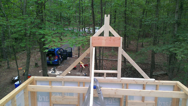

Ridge beam day.

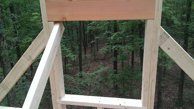

Nice view from the bedroom window.
2X12 ridge beam.
p2536142
Took a little time to figure out how to measure the rafters... each one it like a snow flake... 100% different from the last. Custom haha
