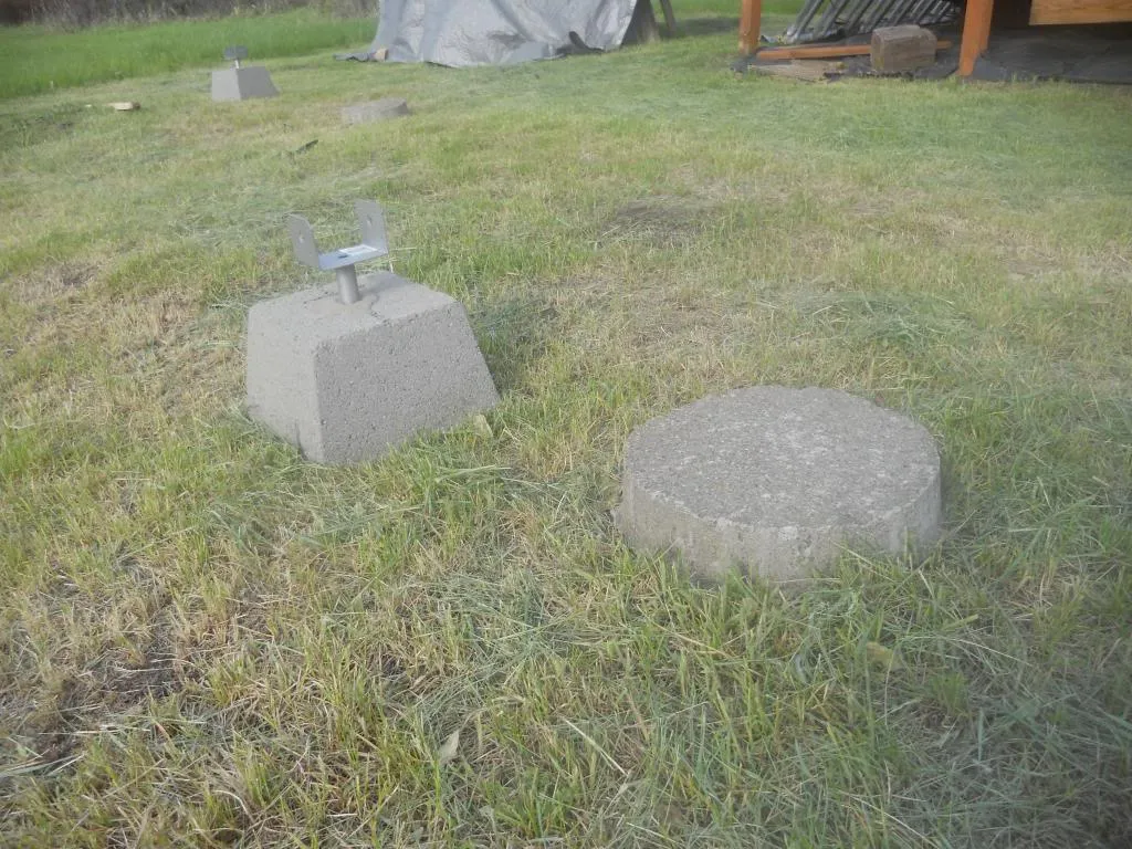

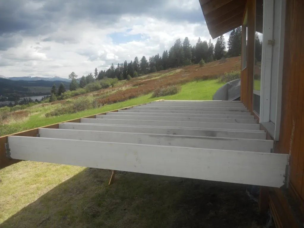

Had been given a couple of rough-cut, full dimension 10' x 2" x 12" planks that I decided to use as a beam for a deck.  Bought enough 8' x 2" x 10" planks (primed white) at the local Habitat Restore in Olympia to use as joists for the deck.  Also picked up several round concrete pads there that made good footings for pyramid blocks to attach posts.

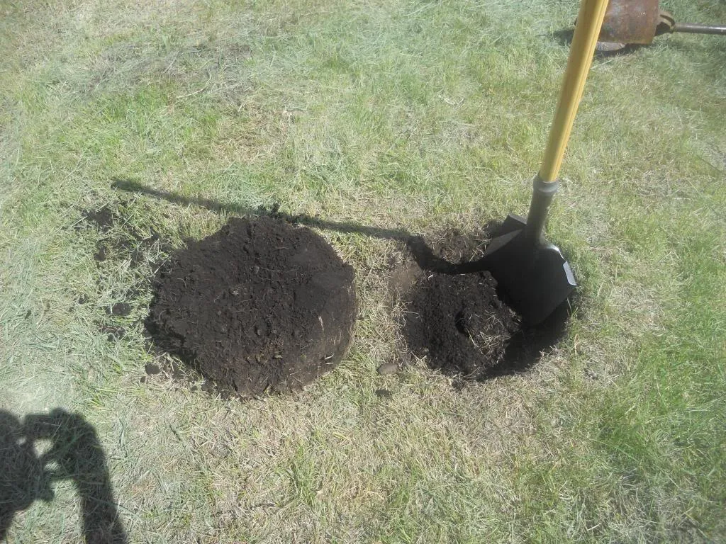

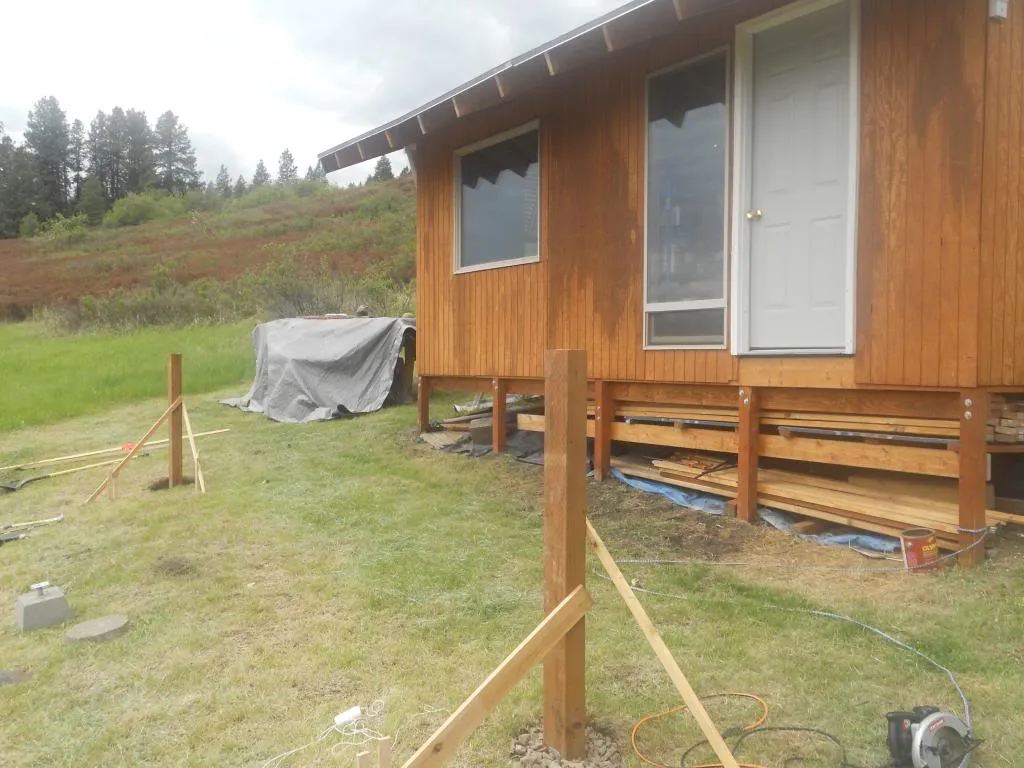

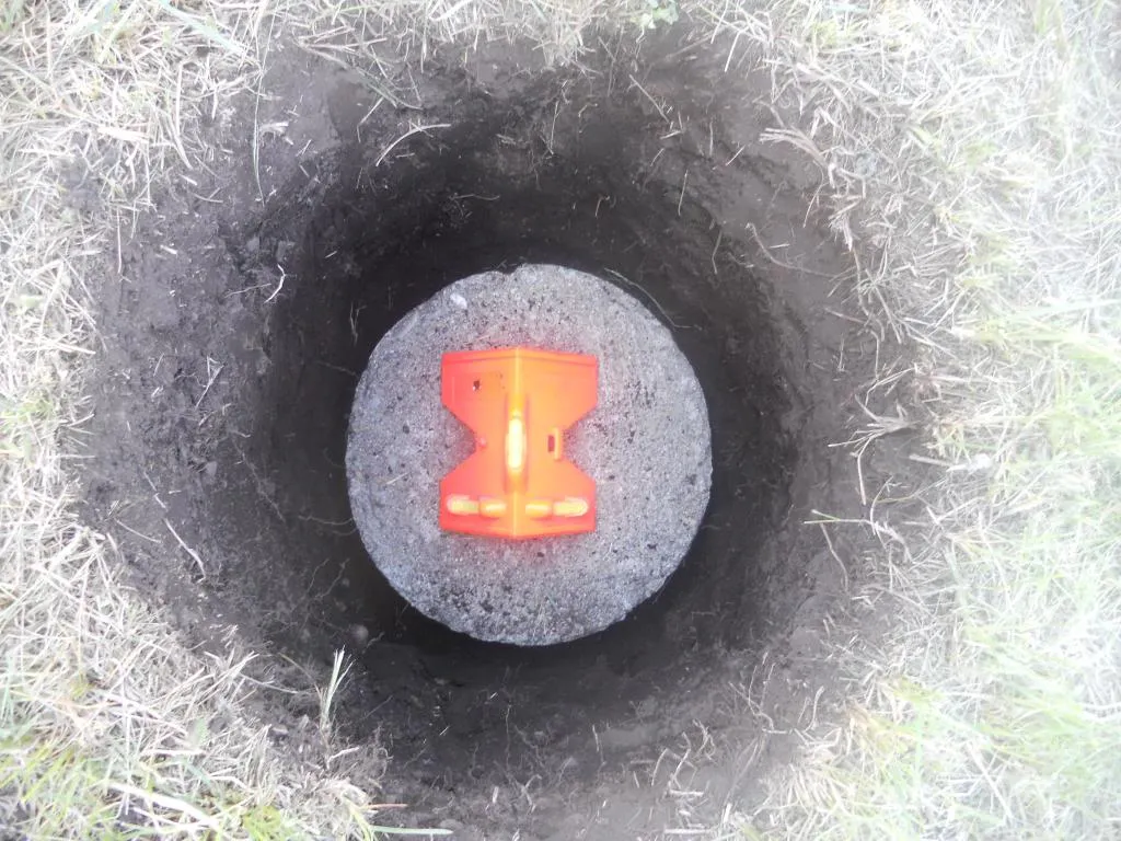

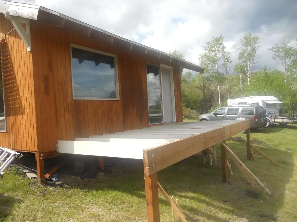

Measured out from cabin and then checked diagonals to establish locations of two end posts.  Then dug  18" deep holes for the footing pads, and installed them level.

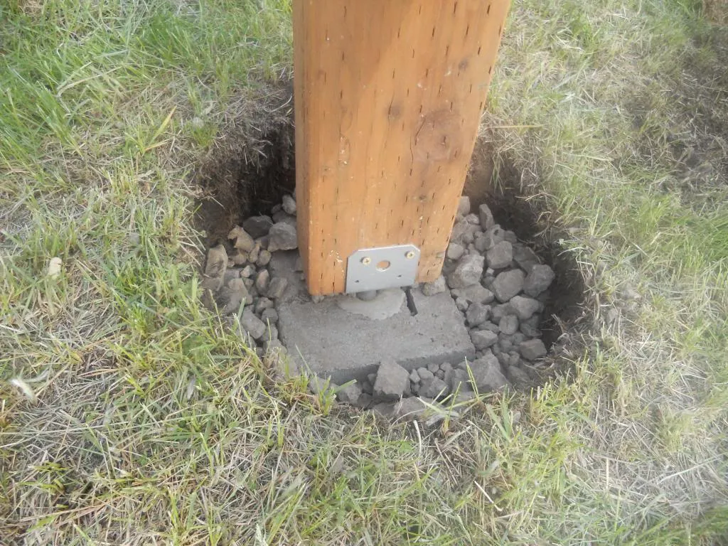

Next installed pyramid blocks, screwed upright 4" x 6" treated posts onto brackets of the blocks, and braced them plumb.  Filled holes with crushed rock.

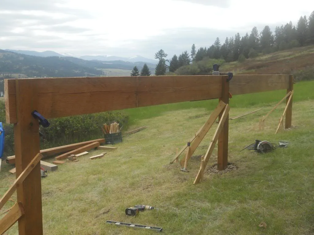

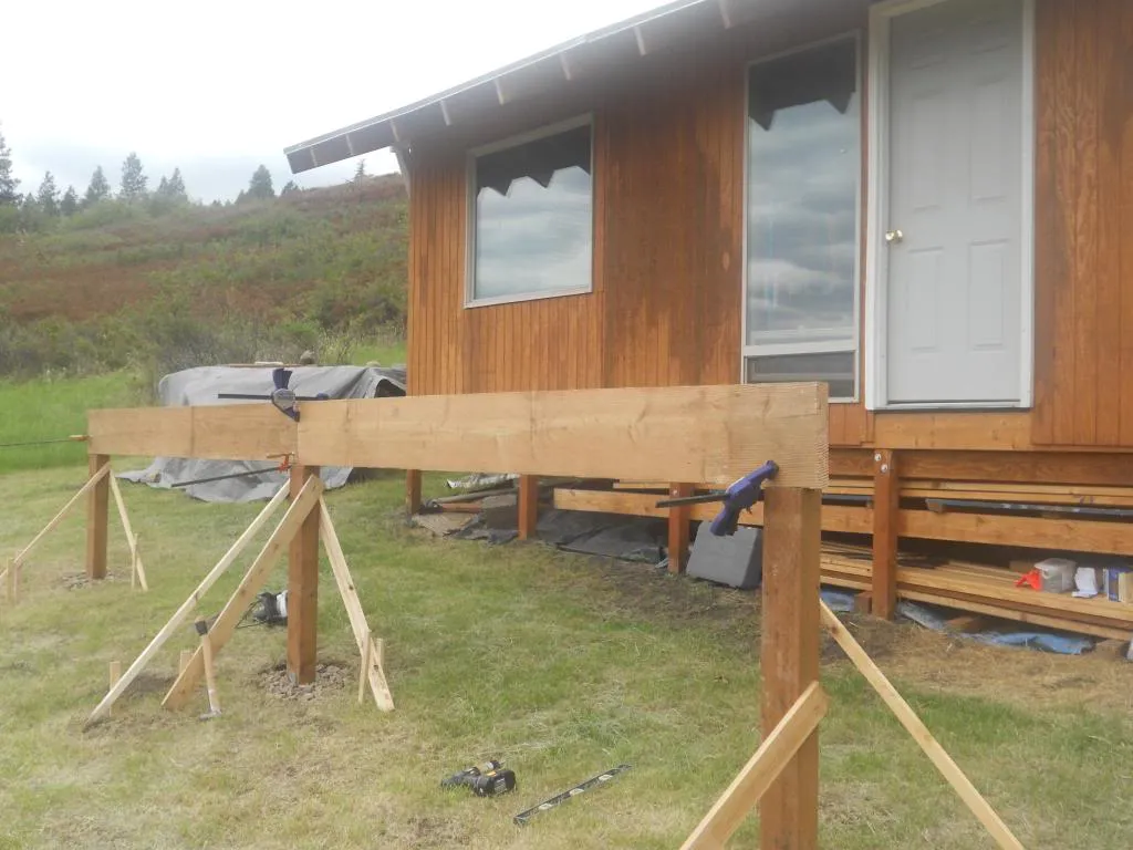

Ran a string between the posts to locate center post, and then installed it in same way.  Cut all posts to proper height, notched the tops, and bolted the two 2" x 12" planks on to form a beam.

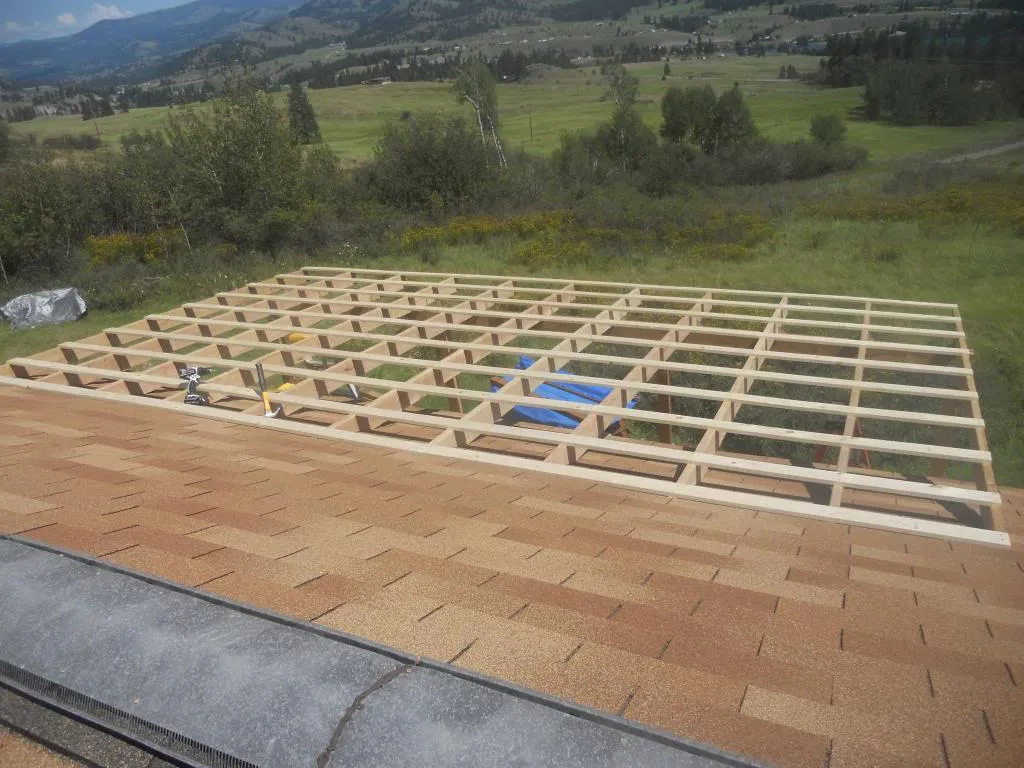

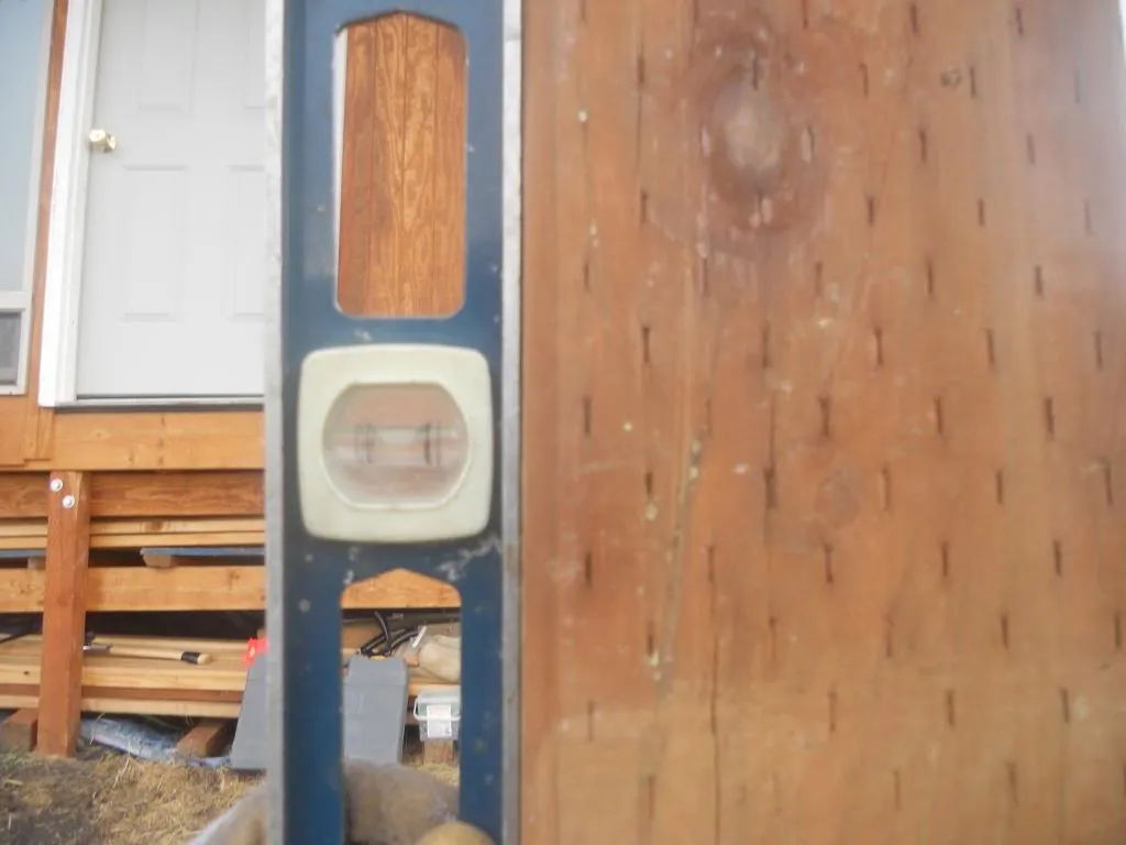

Next I installed joist hanger brackets on cabin side of the beam, and onto the T-1-11 siding/sheathing of the cabin.  Then installed the joists.  I planned to use 8' cedar decking, so every 4' I installed two joists with about 1.5" between them.  This allows screws for the decking to be held back an inch from the ends to minimize cracking.

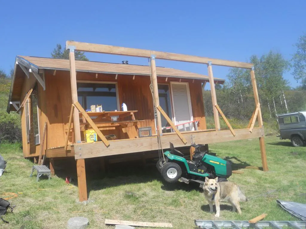

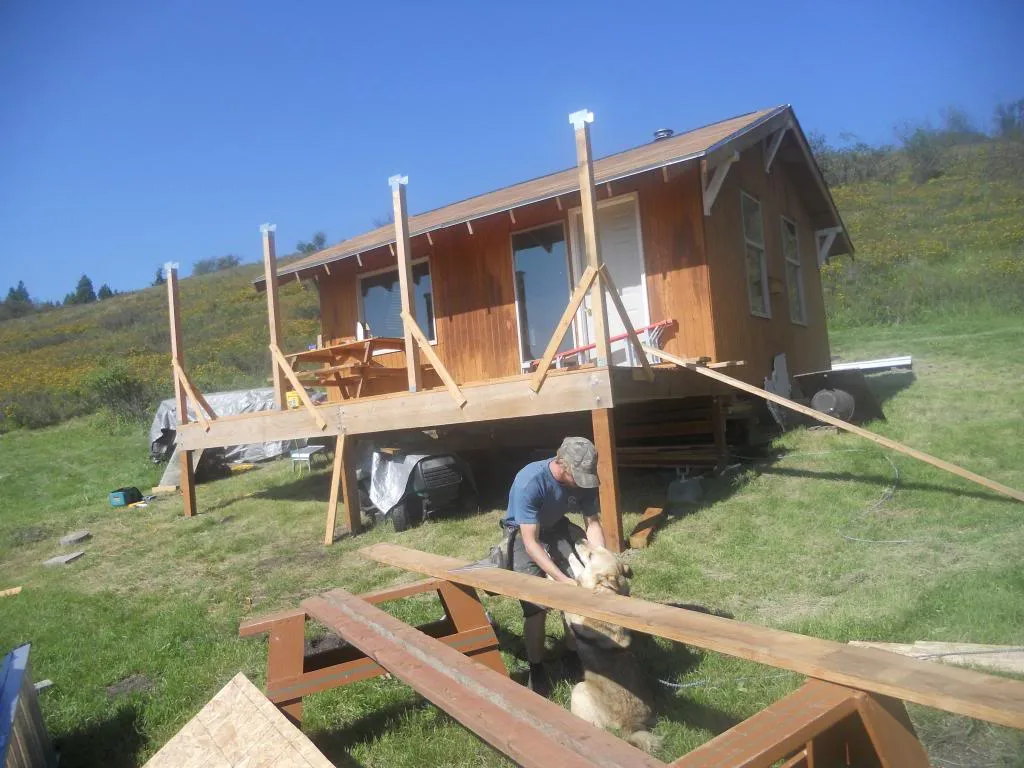

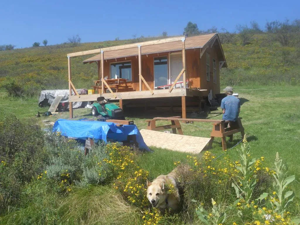

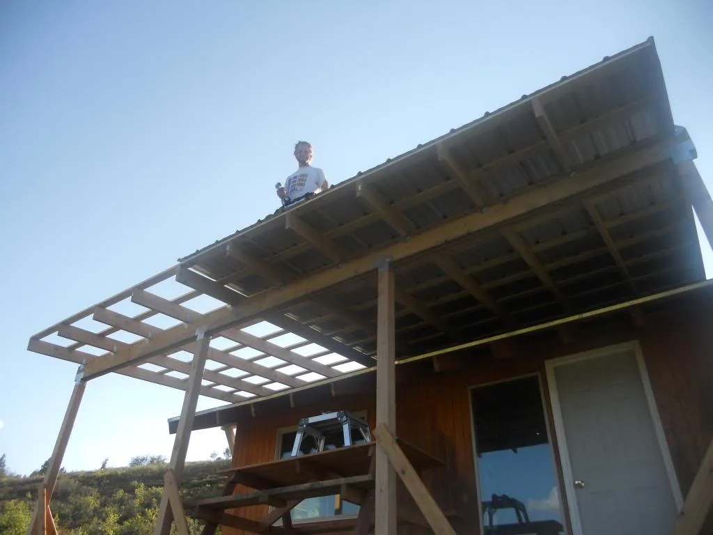

I hired a young guy with building experience to help me with the rest of the build.  We installed four posts on the deck, with metal brackets top and bottom.  Then we built a beam and installed it atop the posts.  One of the planks we used for the beam was twisted some, causing a post to pull up a little, but we tweeked it by hanging the riding mower from the beam...
Security officer for the build knows where the shade is...

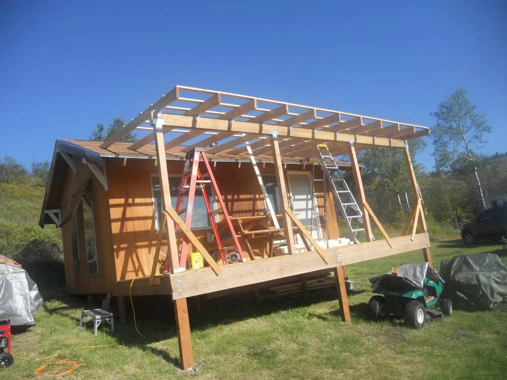

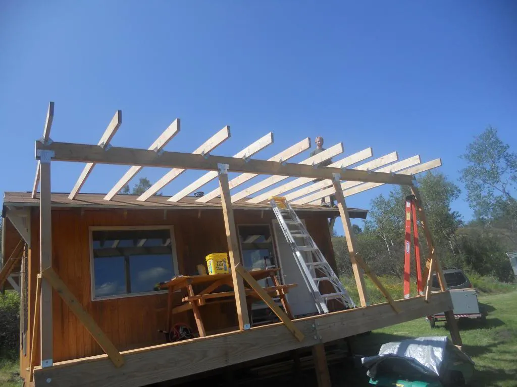

Then we cut rafters long enough to accept 12' metal roofing, with the proper angle at the upper end to screw through the roofing and into each cabin rafter.  Height of the porch upper beam was set high enough to allow a good view of the scenery from inside.  Rafters were secured to the beam with brackets.  Purlins (1" x 3") were then screwed on top of the rafters every 2'.
Finally, we installed the metal roofing and a flashing strip across the upper end to direct runoff from the upper cabin roof onto the porch roof.

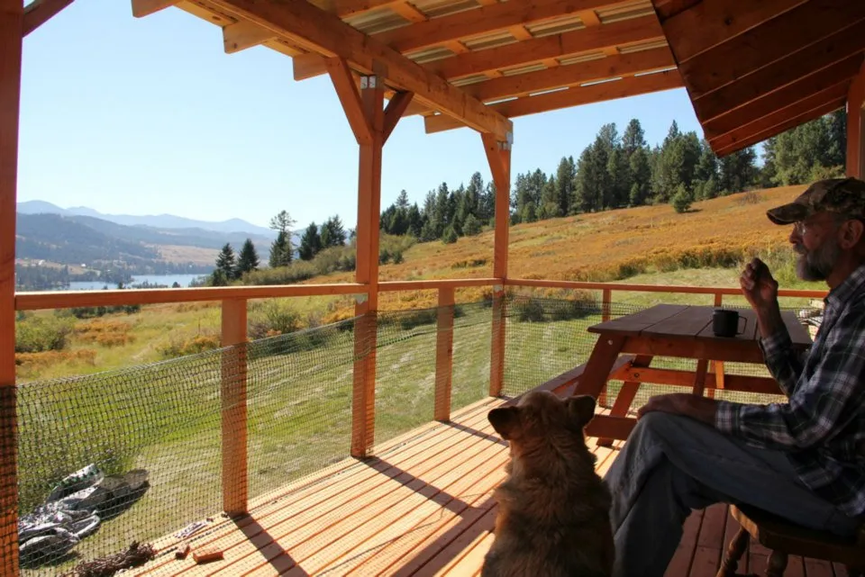

Installed some temp plastic fencing to the minimal railing to contain the dog on the deck.
Second morning of the season, I shot a nice 4 x 4 whitetail from the porch.

The "single thickness" beam is rough-sawn fir, so a full 2" x 12" - plenty strong for this application.  I see my original post had it as 4" wide, which I've corrected.  No ledger is attached to the T1-11, hangers were used at both ends of the joists, and were nailed through the T1-11 into the rimjoist attached to the ends of the cabin floor joists.  The deck is only 8' wide, and seems very strong.  Keep in mind this is a 3-season cabin in the mtns, with no electric or plumbing.  It will not be used year-round, and there won't be any dancing keg parties on the porch.
