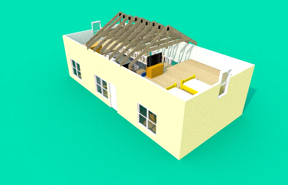

Been drawing up ideas over several months now as I am a month or so away from the very start of my build, and looking for input into my idea and concept here of a remake of the 20x30 1.5 plan here on the site.... I have had answer in other posts that I am trying to factor in here into my build, so I have tried to take all of them into account
Pictures say a thousand words, so let me show you the pictures first, then explain my idea with the pictures as a visal reference for you
As you can see the downstairs would be one bedroom, one bathroom, a small half walled in office area, the living room, and kitchen that fully opens into the dining room.... you will see the wood burning stove in between the kitchen and dining area as the wifey does not want it as a focal point and I think it only adds to the charm of the kitchen area
Near the front door will be a full flight of stairs coming up to a catwalk which will lead to either of the two loft bedroom upstairs
Been to the truss company a few times now and going to go with a cathedral style truss as it adds lateral stability to the house, and the math says it will offer 8'1" of headroom on the second floor at 5'7" away from the front and back wall of the house.... roughly 6' of headroom at 3' away from the front and back walls in the lofts
the first floor will be 8' tall using the called for 2x6 studs, then the engineered floor joists for the two loft areas, then platform frame a 4' tall wall as the second story of the house which the engineered trusses will sit on.... the idea being more livable space in the lofts but not the extent of a whole second story workwise or pricewise
I considered balloon framing as the plan has it, but really desire more liveable space in the lofts, even with using the 12 on 12 roof
the floor joists and roof trusses, both engineered, will meet or exceed code to hold the house laterally... and as added security, the addition of a "plant shelf" by way of doubled up 2x12 running between the first and second floor horizontally in the open area of the living room, both front and back wall, will overdue it
The 17' long by roughly 4' wide catwalk will be made likely out of 2 additional engineered floor joists being supported by the two walls at each end, then covered with 3/4" T&G and such
I am doing as much work and labor by hand as I can as the budget is extremely tight... so my approach on building this house this way holds this value as being important
It would seem pretty straightforward.... build the 8' tall first floor, then add the floor joists in, then platform frame the 4' tall second floor, then have the trusses delivered and install them.... hopefully I will have friends helping me as much as I can..... of coarse throwing in rough plumbing and such during these stages
I am no engineer, or master builder by any means.... so please add any thoughts or concerns you may have seeing the pictures and reading these thoughts
I am striving for the simplest way to build this, but trying to add some charm in too hopefully with the open living area and catwalk
Please add any thoughts or concerns or ideas here

rwanders
Have you considered using 12' 2x6 studwalls for the first floor? It eliminates the potential hinge joint resulting from building those 4' pony walls in the loft areas. What are you going to do for your wall framing in the open area? I built a 24x36 1 1/2 story in Alaska a few years ago.  Plan similar to yours but with only a single 10x24 loft with a 4' wide by 14' long catwalk from to door opening onto the upper 10x24 covered porch. The 12/12 roof extended to cover the two stacked 10x24 porches. The heated footprint of the cabin was 24x24 on first floor and 10x24 in the loft. I didn't use trusses but did use a 6"x16"x36 foot glulam for a ridge beam so did not require rafter ties. A 3"x12"x24' glulam formed the edge of the loft area along with one 4x4 support buried in the interior partition walls carrying the load down to a footing.  I found it very difficult to draw a comfortable floor plan in a 20' wide format. The staircase was particularly hard to scale in without eating up a significant chunk of the first floor. The extra 4' in width was of great value. I used a single landing on staircase after trying to use a winder design--very difficult to get code and/or common sense compliant tread design on a winder. Looked at spiral but getting furniture up and down is impossible with a spiral. Also headroom is a problem if you try to place top landing near a sidewall---mine was landed at the catwalk which was in the center.  I found that drawing scale drawings using 1/4x1/4" graph paper revealed a lot of interference situations during the planning process and avoided the dreaded "aw shits" during construction.  If you search forum for rwanders you can find pictures, etc.   Recommend your consideration of 24' wide plan. It will require some adjustment of spans, etc but will make an amazing difference in livability. I also found that going from 8' deep porches to 10' was not much more in $$, but made them much more comfortable. An uncovered deck or porch in a snowy climate is unusable too much of the year and just adds a lot of shoveling to your life. [if you want a porch at all].  Good luck--I found the design process was great fun. It took lots of pencils, lots of graph paper, lots of time, but paid great dividends during construction and in the finished product.

I would like to just go with 12' sidewalls and make a 7'6" first floor height, but from all I have read, this sums it up the most....
" The maximum height of an unsupported and non-engineered wall is 10'. This is what limits the wall height in a partial loft partial cathedral situation. "
I "must" try and keep the house as simple and as easy to build as I can, as I am doing almost all of the labor involved, and this is my first house build.
I would love to go to 24' wide and open it up more, but the money and engineering would kill me
I have designed and redesigned this floor plan at least 50 times and this seems to be the best layout for our needs, as well as being the most cost effective layout

I might be misreading your understanding but what they are asking for in that support is something stabilizing the wall "out of plane", in and out. A floor at the 8' height level connected to a 12' tall stud wall is supporting that column agains buckling out of plane, the wall sheathing provides support "in plane" against the studs buckling along their weak axis. If the plant shelf is designed as a girder to support a wall with less than 10' of height on either side of that shelf, it too would satisfy the requirement. This would actually be stronger balloon framed but does require fire blocking to seperate the floors. You can platform frame the floored areas, it is no different to frame that at 4' than at 8' tall which is what we would do if it were a 2 story. IF the roof is framed properly the walls don't need to resist its' lateral thrust. (We do see alot of roofs improperly framed and they are sending lateral thrust at the kneewalls. This is not a good thing to do. If the kneewalls must be loaded that way it is an engineer's playground and I can tell you, he'll do plenty not to play in that sandbox. Code calls for a ridgebeam in that situation)
But, I don't think your trusses are out of the woods yet. I'm seeing ~7/8" lateral deflection under full load. You can check the allowable deflection of a wall, l/120 comes to mind... 1" in 10' of height. you are looking at ~1/2" in 4' of height, you're pushing a mighty lenient(poor) code requirement.
The "engineering" on a 24' wide is no big hill to climb, it would actually simplify some of this. Things are easier on paper or on a screen, don't be frugal there. Just messing around I've sketched parts of several houses tonight. Spend that time up front. That wasn't really directed to you Steve just a general good idea.
In speaking with the man who is designing these engineered trusses, he says that code actually allows for 1.25" and when I mentioned I wanted less deflection, he said ( maybe this is normal here in SC buildings ) that this would be fine as he already planned
Hopefully a simple question here..... John's plan calls for 10' walls. You are saying that I can swap out the 10' walls for 12' walls and balloon frame the dual lofts and in using a joist on each side of the open living area at say 8' off the ground, this is well within code and would be safe?
Another question if I may.... instead of using engineered trusses with the above question, how hard is it to "build" your own ridge beam roof? I am going with a concrete slab, so how do the vertical beams get "anchored" onto the slab, or are they just secured to the sidewalls?
As mentioned, I am doing all I can do to keep the cost down and working with a very tight budget.... what is the easiest way for almost one man to do this build? Or should I switch to the 2 story model of this house?

Let the truss designer know they are sitting on top of 4' tall walls and ask the question again  ;). He was unaware or oblivious of the kneewall height.
If the studwall is laterally supported at <10' height intervals then it satisfies code, The loft floor diapragms do that and an appropriately sized and secured horizontal beam can accomplish that.
I'm pretty old school so I would more than likely use a ridgebeam on this. There would be a post foot embedded in the slab with a thickened section under that to form a footing under the ridge support posts.
I like something along these lines. A flat plate with hooks is embeded flush in the slab. The knife plate is inserted in a slot in the post, pinned and the post is installed and plumbed, when everything is happy weld the post base to the floor plate.

Don... thank you for all the insight you are giving me here, much appreciated I must say first
I have made the truss company well aware of the idea of the 4' platform framed kneewall upstairs a few times, and on my last visit I was very clear about it as he was looking at them in the program he drew up.
Recap here and a question.... if I take the plan from the site here for the 1.5 story and build it using 12' studs and balloon frame in the two lofts and roughly have a 3 to 4 foot high wall in the lofts and still have the open living area in the middle as in the first post picture and add in lateral support <10' high on the stud walls in the open living area.... can I then use the above mentioned engineered trusses with no issues or work arounds? Would balloon framing solve all the issues at hand?
In the plan, do the site built trusses call for a ridgebeam?

If the truss designer gets the horizontal deflection down to <1/2" total then he is within spec. At that point you can either platform frame the loft areas or balloon them. Playing with the interior and exterior pitches of the truss is another way of stiffening it. It doesn't neccessarily have to be heavier or higher grade material, there are several ways you all can do it. I'd balloon the tall LR walls either way and have the plant shelves we talked about tied well to the lofts. The gable walls should be platform framed... don't put a framing hinge at  4' above the second floor on the ends, we see that mistake too often in pics don't repeat it. Balloon those gables from the loft floor up, again use the floor as a point of lateral stability.
The site built truss is not really a truss. It is a pair of rafters that are gusseted together at the peak rather than being nailed to a ridgeboard, this is fine. If the tie between the rafters is in the lower third of roof height it is able to be adequately tied to prevent horizontal thrust to the walls. If the tie needs to be raised above the lower third of roof height then a ridgebeam should be used.

If I take the stock plan from the site here for the 20x30 with 1.5 and ONLY increase the length from 30' to 42' and increase the loft length by those extra 12' I added, and keep the same open living area as in the plan.... and add stairs running up to the middle of the loft instead of the edge of the loft, would this be fine to do with the site built trusses as in the plan?
In the open living area, I would keep the rafter ties to the lower third of the trusses..... are there rafter ties in the loft area in the plan, or just site built trusses?

The prescriptive solution is to use a ridgebeam in that situation. Do check headroom under the rafter ties over the stairs.

Any of these are do-able if you do it right. Personally I was kind of liking the dual lofts.
The site built "truss" and its' limitations are described here;
http://publicecodes.cyberregs.com/icod/irc/2009/icod_irc_2009_8_sec002.htm?bu2=undefined
R802.3, the gusset in that section describes what you are calling a truss.
R802.3.1 describes the need for a continuous rafter tie, the second paragraph describes the raised tie and points to section R802.5.1(9). In that section you will see the connection requirements and the limitation that the rafter tie be located in the lower third of roof height. Notice at the bottom of all of the rafter span tables in that section an adjustment factor to be applied to the allowable rafter span as the tie is raised up to that maximum 1/3 of rafter height. These are not casual requirements, gravity is unrelenting over the life of the structure.
If we're going to use the term "truss" to describe that gusseted rafter pair you have entered the truss requirements in section 802.10.1 You really don't want to go there. I'd use the proper terminology in any discussions with officials, it would help if we used them here to avoid confusion.
With that out of the way, the dual lofts or a full second floor would work if the kneewalls are tall enough to allow rafter ties to be located in the lower third of roof height. We use the term "kneewall" but the building code doesn't specify any difference in a kneewall and an 8' wall, what you are calling a 1.5 story is structurally no different than a 2 story. The wall can be 2' or 10', it's your job to get the tie in that lower third of roof height. If that cannot be done a ridgebeam is required if you want to stick frame it. Don't reject that option out of hand, I've done it many times.
Going to a full second floor some things do get easier. The walls would be platform framed, you're only tipping up an 8' tall set of 1st floor walls, framing a floor, tipping up 8'tall second walls, rafters and ceiling joists or trusses. It's stout too. Costwise you'll need to run the numbers yourself, but, studs are generally cheaper than longer lengths per lineal foot so there is probably some offset.
I do sense the frustration and appreciate it, we've all been there. Hang in there, we are trying to help. For myself, when I seem cryptic I'm actually trying to leave openings that we can pursue or trying to avoid stepping too hard on toes. When I stepped on the tall window walls it wasn't to say it is something to avoid at all costs but to point out that it comes with it's own set of difficulties, and I'm glad Ndrmyr took my comments that way. Design is very circular, we fix one problem then need to look at what its' implications are. It seems hard hearted at times, nerves can fray, but it is much better then hitting something unintended later. So often one comment from someone can open up a new and good direction to chase down but just as often a "new" direction is one that has been tried before and found to be wanting in some crucial detail. So often we do things a certain way not because carpenters are dullards but because the alternatives have real problems the new builder does not see. "Good judgement comes from experience, experience comes from poor judgement", I've got a boatload of experience  :D.

I hear you Ndrmyr, my Dad's career was the 4/12 ranch house period, mine was the 12/12's, darn the luck. The house with the frying eyeballs problem has a million dollar view out that window wall. There is a reaction when people step inside. They are quite happy with the house, it just came with a cost. Seems its hard to have it all so we have to choose the best compromises we can. Structurally, it has an oak 8x8 horizontal beam with a pair of oak wrapped steel posts up to that between window framing. It has a pretty good "fetch" to the wind and needed good reinforcing. The durecho in July slapped it in the face at about 80mph. It will have harder days before its done I'm sure, it cannot weaken with each blow.
Playing around in sketchup I did this sketch of a 20x42 to the codebook prescriptions in my post above. If the kneewalls are about 5' tall and the rafter ties are 8' off the upstairs floor it looks like this.
I prefer to use a ridgeboard rather than independent gusseted rafter pairs, it makes the roof easier to get straight. The parts are also lighter one stick at a time but either way is by the book. This is not a ridgebeam, I jacked up the kneewall by a foot to avoid that yet, the ridgeboard is just 2x material to nail the rafters to and keep them aligned during assembly.
If we want to lower the kneewalls the rafter ties are going to get into the headroom pretty quickly. If the ridgeboard becomes a structural ridgebeam that the rafters can hang from, then the rafter ties can go away and the kneewall can lower.The useable width will begin reduce as the walls lower and the slope of the rafters gets into headroom. From the inside that 5' kneewall isn't a bad thing, one way to look at that compromise is that for every foot you lower the kneewall you effectively lose 2' of useable width upstairs.
By making the kneewalls ~5' or more and using the rafter ties rather than a ridgebeam there are no interior support posts for the ridgebeam so the interior layout is simpler. The kneewalls in the drawing could just as easily go to a full 8' and the ties could come down... or could stay up at some point in the lower third for a coffered ceiling effect.
