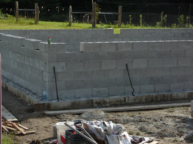

Block foundation wall  is up and being inspected today- hopefully passes for a concrete pour on friday then the fun begins!

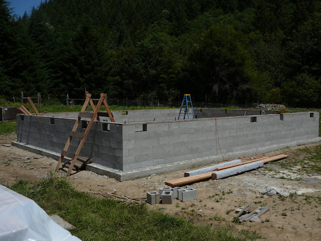

Ok- the block is laid and poured full.  Lots of fancy tiedowns for seismic.  Things are still on schedule so far!

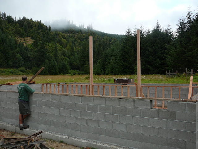

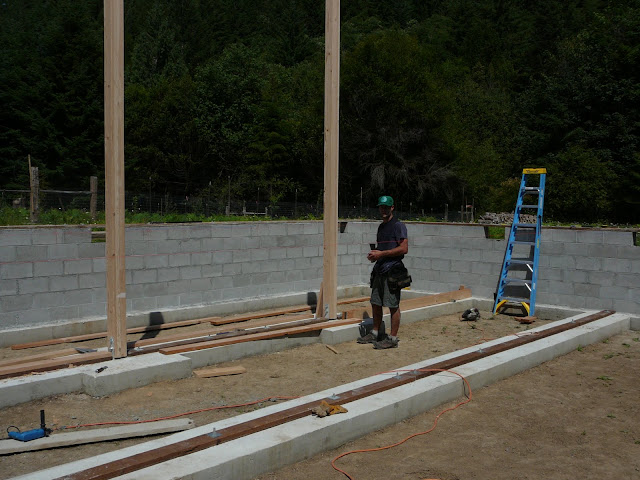

starting on the ponywalls.  THese glulam posts have to extent from the footing up through the floor and to a beam supporting the second story.
high 70's- too hot for Sadie

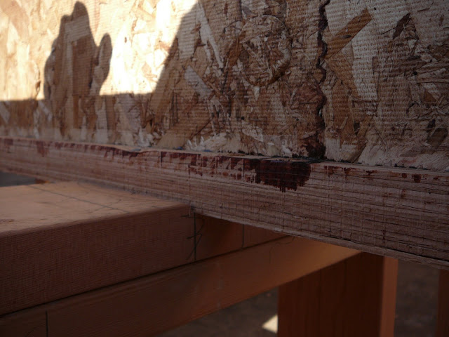

got all the pony walls up but they were a 1/4 to a 1/2 inch too high.  whoops.  So we notched out all the spots where the i-joists sit.  worked well and now we have a flat(er) floor!
Lots of squash blocking
cbc58
Looks great.  I have a question:  what kind of frost depth do you have out there because it looks like the footing for that foundation is sitting pretty high... or are you going to backfill all around??
tristan
12 inches deep is what they require but yeah we're going to backfill pretty high up the block wall.  The house is kinda in a hole now and it is starting to look like a tower already.  The good news is our "crawlspace" is around 5 ft high so it'll make a nice root cellar!

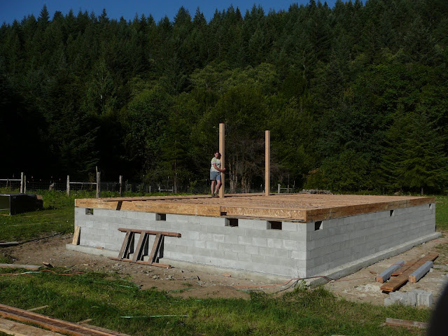

tristan

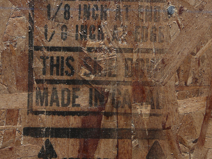

Got the subfloor down yesterday.  I read in fine homebuilding that a good crew can lay a subfloor bigger than this in about two hours where an unskilled crew would take a full day.  They were right on, at least for the unskilled crew!  Joist spacing was not perfect so there was a fair amount of cutting to length.
I don't think we'll ever build anything again without a nailgun- what a difference in productivity!
so......there's a up side and a down side to subflooring.  whoops.  hopefully that doesn't foul us later
ready for a dance party! Walls will start going up this weekend.

Quoteso......there's a up side and a down side to subflooring.  whoops.  hopefully that doesn't foul us later
The "down" side is the smoother side. Especially on roofs this can be important for safety. The other side is tectured and gives better traction.   Another point can be that if something like a roof is sheathed with the stamped side up, then the inspector can not see what the sheathing is if you have building paper or wrap applied. There might be other reasons too.

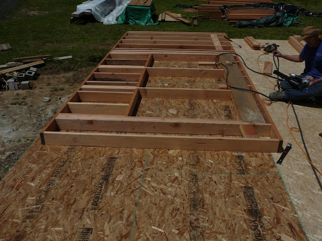

building the walls.  Used a jig to cut a bunch of studs/trimmers/cripples in bulk and it's amazing how fast the walls went together.
we definitely didn't' use any "advanced framing" techniques- there is a lot of wood in these walls!
Had over about half of the extended family to help lift walls.  We'd never lifted walls this heavy so we weren't sure how it'd go.  An 18 foot section with a big header and sheathing attached was no problem for the five strong backs we had on hand.  Many hands make light work i guess.  WE got brave and attached a couple sections together on the ground to make a 24 foot wall and it went up fine.  Who needs wall jacks!  I'll try and find some photos of the raising.  but here's the end result on sunday:
I highly recommend sheathing the walls on the deck.  simply squared the walls, nailed down the sheathing and took a router to the window holes.  The walls turned out plum! I guess that's how it's supposed to work but it still amazes me.

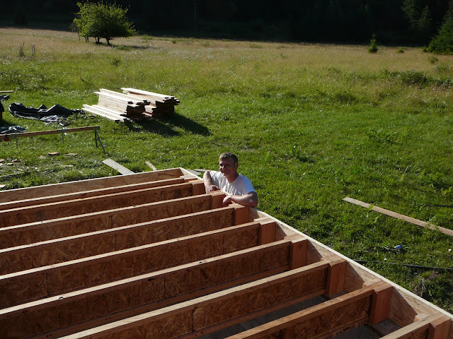

hangers for i-joists went of really quick and once they;re nailed to the beam you just spread some subfloor adhesive into the bracket and pound down the joist until lit bottoms out- no nailing necessary!
where we're at now- almost ready to start on the second floor.  THe interior walls took longer than we thought they would- lots of figuring for blocking, wall junctions etc. Some interior walls are sheathed with plywood because they are shear walls or we wanted a solid nailing surface underneath.
