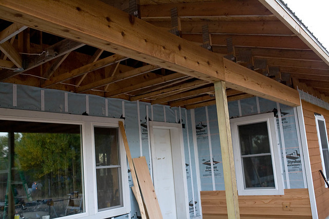

About have the outside of my place buttoned up but I need to get a ceiling in the patio area and am trying to figure out what to use. Any suggestions? How about things to stay away from?
Was thinking 4x8 sheets of something like T1-11 or maybe shiplap boards or drop siding. Whatever it is will be painted white.
Is the 2' on center spacing of the trusses going to cause problems with some options? Strapping it to 16" on center wouldn't be a big deal if need be.
The patio is roughly 8x21.
Here's a shot of the patio:
20111002_003 copy_web by Alan  Gage, on Flickr

If you're just going to paint it you could go with 1/4" AC plywood. People use it for sofits all over around here.
CjAl
You can get bead board.in 4x8 sheets. Its a nice old fashioned look
that beam and siding looks so nice my vote would be for some t&g cedar or some.other species stained to match
BTW. Is that 4x4 post temporary?
Alan Gage
I'd like something a little nicer than plywood and while those 4x8 sheets of beadboard would be nice I'm not that crazy about the look and I know of a few houses around here that it's swelled and buckled badly.
I'm leaning towards some T&G siding. All they have in town is pine. Not a problem if I just paint it. Stained cedar would look nice though.
The 4x4 post is permanent and will be wrapped with cedar at some point. While permanent it's not really necessary. The trusses were designed to cantilever over the patio but I liked the look better with the post in place.
Thanks guys.
Alan
CjAl
Wrapping it would explain it. Lol
i think T&G is the way to go. I prefer stained but its not my house   ;)
I did t&g for a guy on a porch ceiling and liked the look. Honestly, it probably would have matched the house better painted off-white, but he liked the wood grain so much that he ended up staining it later.

A nice V-matched T&G in either  White Pine , or Hemlock given a clear oil finish  would look very nice. I'd go with the W. Pine if it where my choice.
  If you use a T&G solid wood product make sure you leave it outside under cover to pick up some moisture , if it come out of a covered but NOT heated storage barn  you'd be OK to just install it.   But if your not sure how it's been stored you should let it acclimate to the environment you'll be installing it on/ in.
If it to dry and you install it it will swell and may buckle/ heave at a joint.

Thanks. The siding is white pine with the V groove. The lumber store keeps everything in unconditioned buildings but it has been quite dry the last couple weeks. The humidity did pick up today and should stay up for a little while. So far we've been dodging the rain in the forecast so if that keeps up I won't get to the patio ceiling for a couple more days while I keep working on the soffit.
