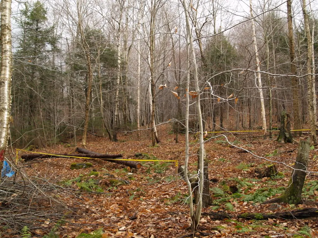

Thought you would like to see my Wee House build site here in northern Vermont
And this is how every piece of lumber will get there
Yesterday I thought I was crazy to even consider building up that high with no road but I am excited and it will be a long, interesting month.

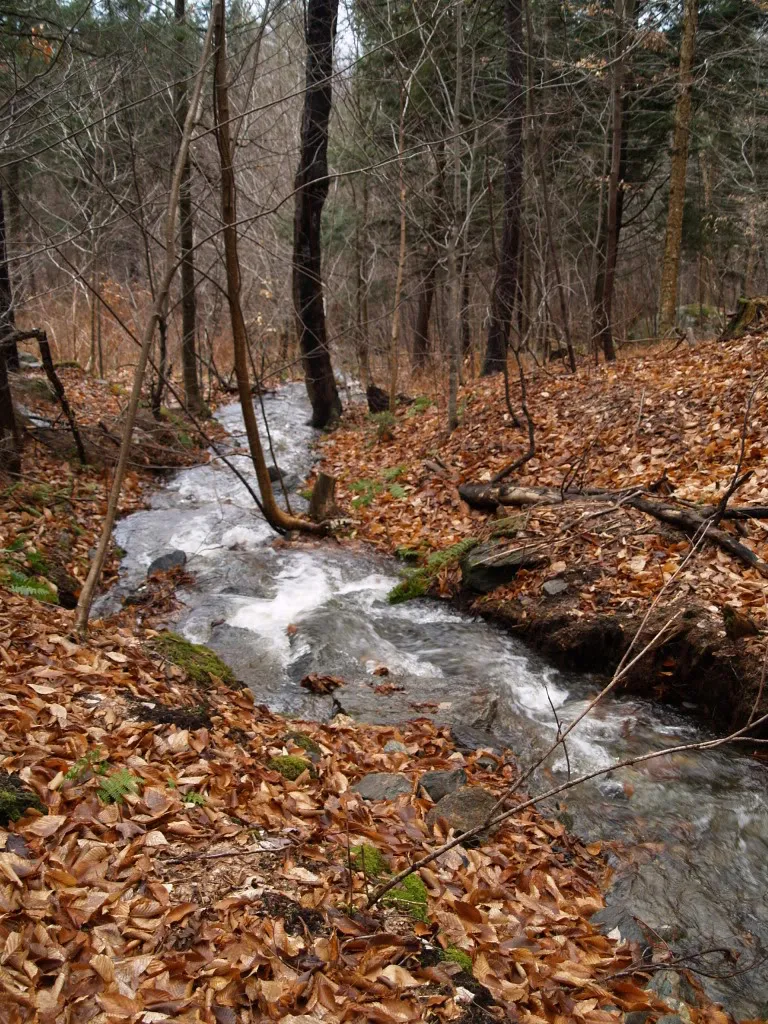

Beautiful looking spot, the further away from civilization the better in my book. Looking forward to more pics/posts. How far is that stream from your house going to be, micro hydro looks promising.  Tickhill

Good start!  Does that creek run yearlong?  With the flow and the elevation drop it looks very promising for micro-hydro if so.

The stream is about 40 feet away in front of the wee house. I wanted the house on dry ground so the stream will be part of my view from the future front porch. I'll have to do some research on micro-hydro.

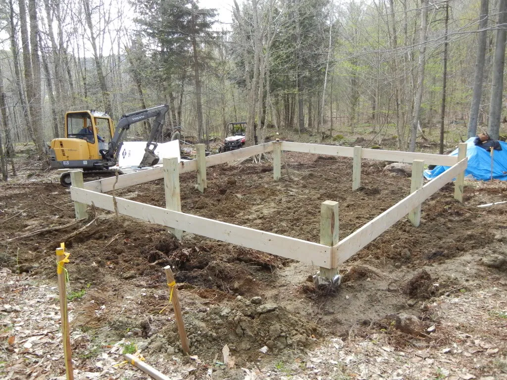

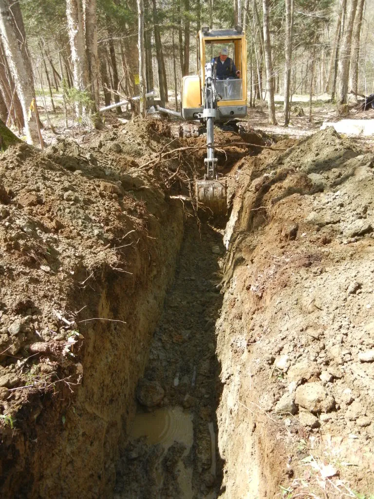

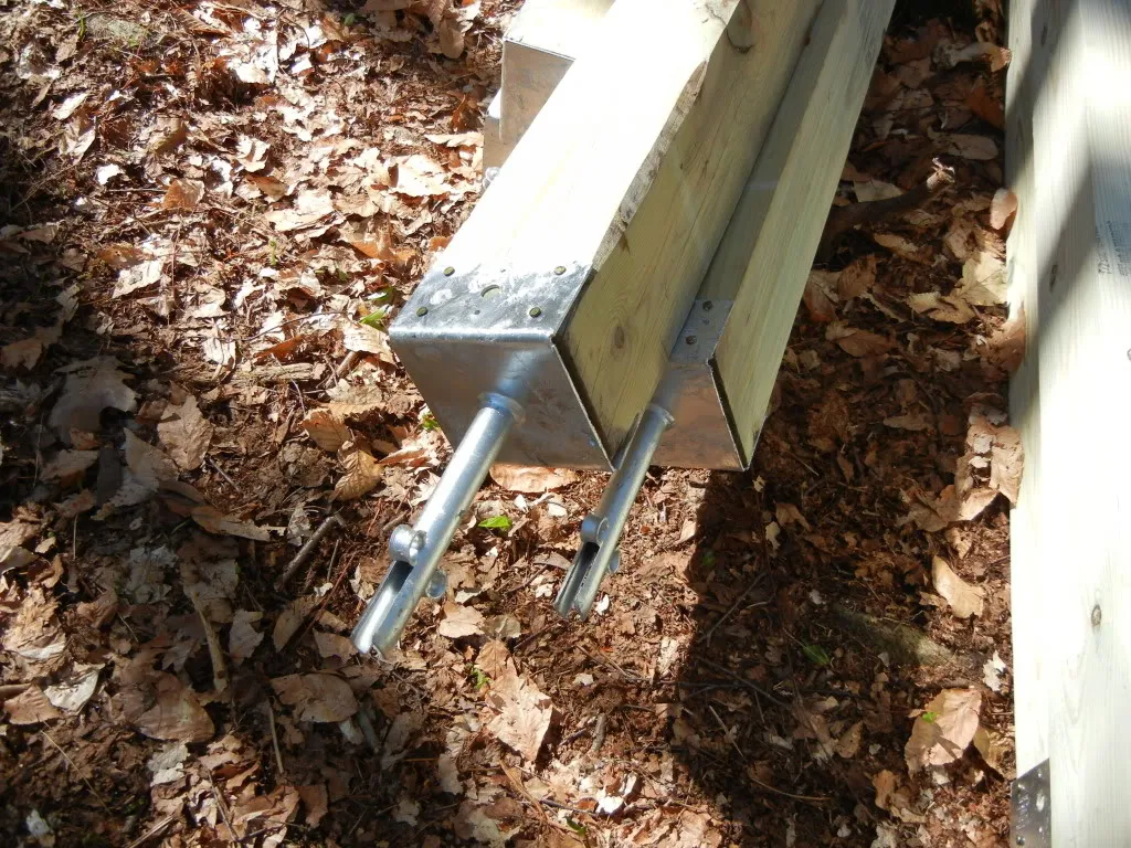

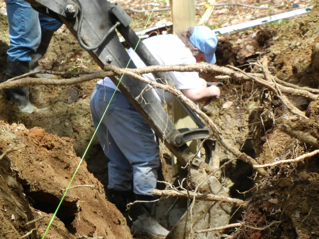

Here are pics from yesterday, it was a long day but the post got set. These are the post brackets
Here is the trench for the posts
This is me using the excavator as an elevator
Here is how I did the post, first bracket then wrapped post in 1/2 foil styrofoam to keep frost away from posts, dropped a bag of cement in each hole and dropped post bracket into cement bag.
And this is the end of the day with posts set.
cbc58
so you just buried the posts... no concrete piers or foundation ??
tlmartin
The only concrete was the unopened bags, thats the way some farmers up here set their posts for pole barns and those barns have been standing for a long time. They tell me the trick is to keep the snow away from the post using skirting of some kind.

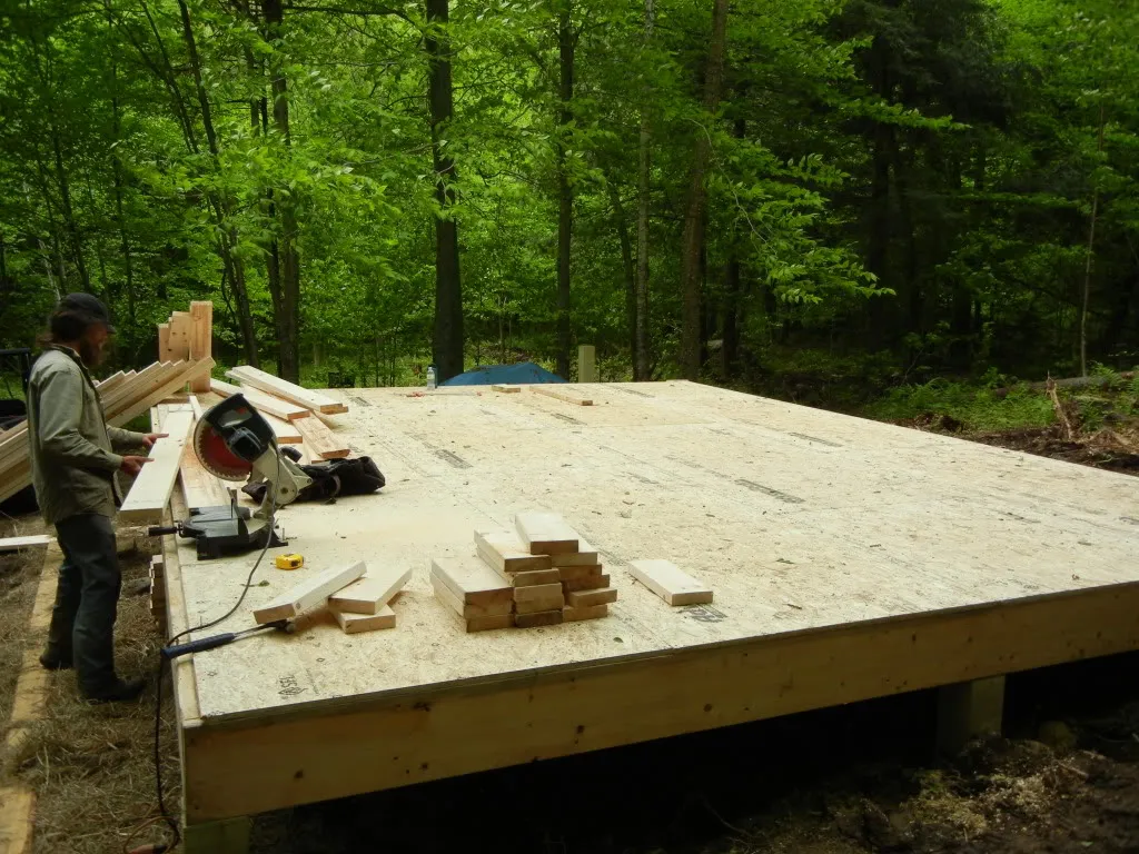

tlmartin

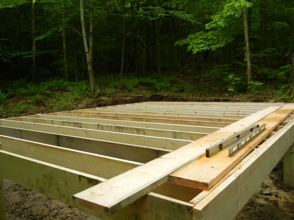

here are few pics of the floor.Next will be the walls and roof this weekend !

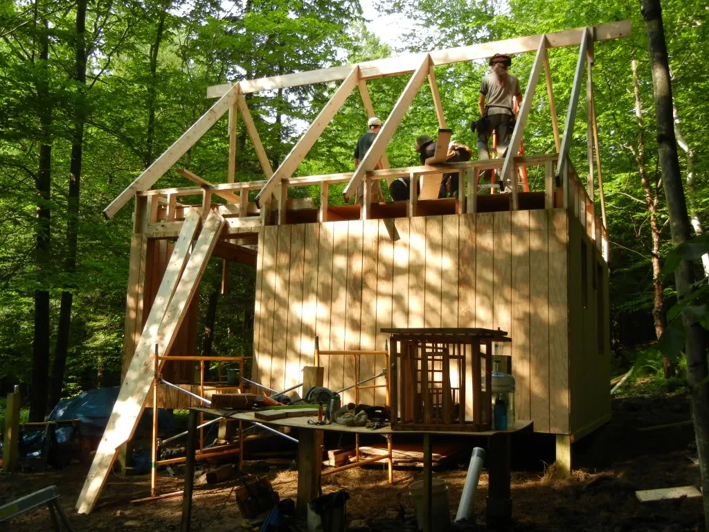

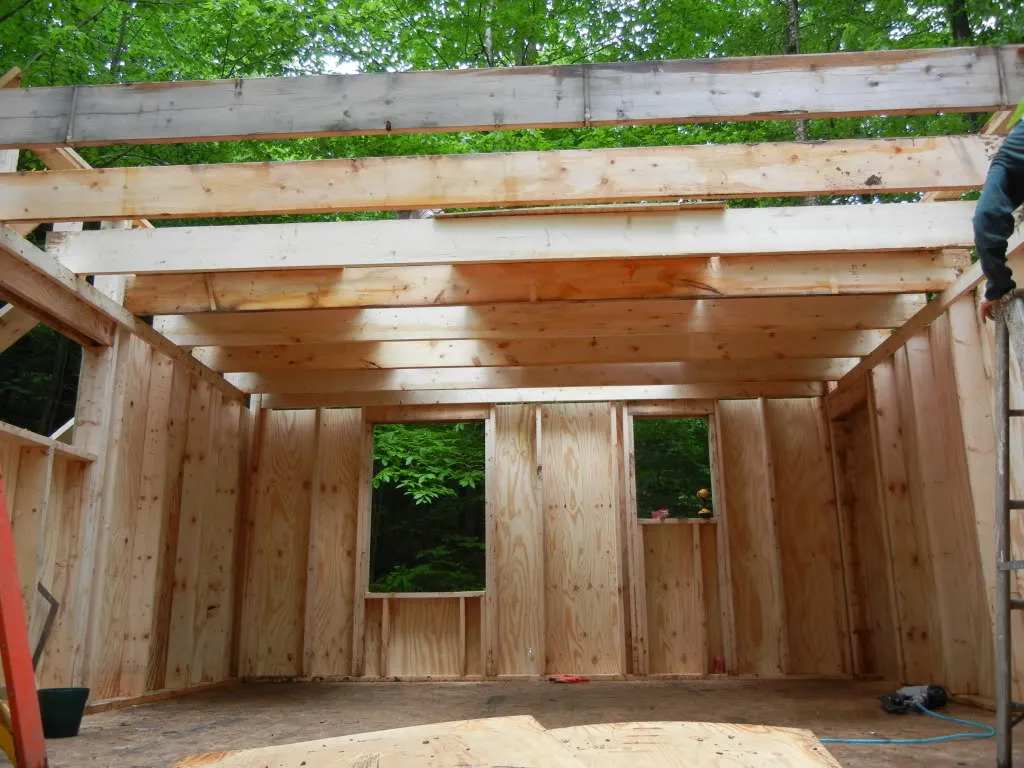

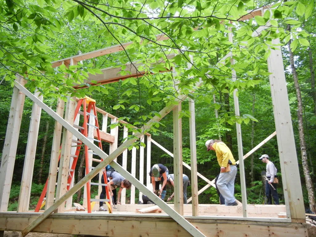

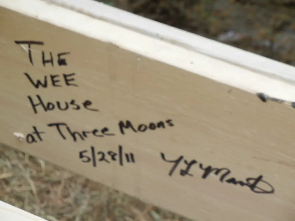

We had a very productive weekend  ;D but I am worn out now. Here are some pics for your viewing pleasure.
Tradtional pine bow on ridge beam at the end of the day
Tickhill
rich2Vermont
It looks great, Trudy! I love how nestled you are in the trees. I was worried you guys would get wiped out by the thunderstorms Sunday night, but it looks like you made some good progress.
Looks like you had great weekend.  The project is coming along nicely, just curious on two questions.
How did you attach the floor joists?  Did you use hangers or brackets or just flush nail them?
Do you have plans to add additional bracing on the piers?
tlmartin
We flush nailed the floor joists(five 16d nails per end). I will be adding some bracing around the posts as soon as I get the roof, doors and windows done. I'll be posting more pics soon.

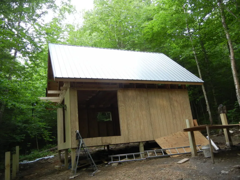

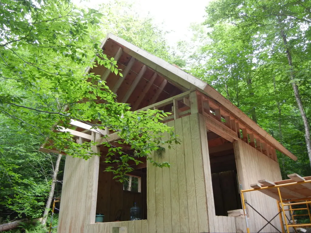

We are making progress on the roof, jeez thats a big job...
