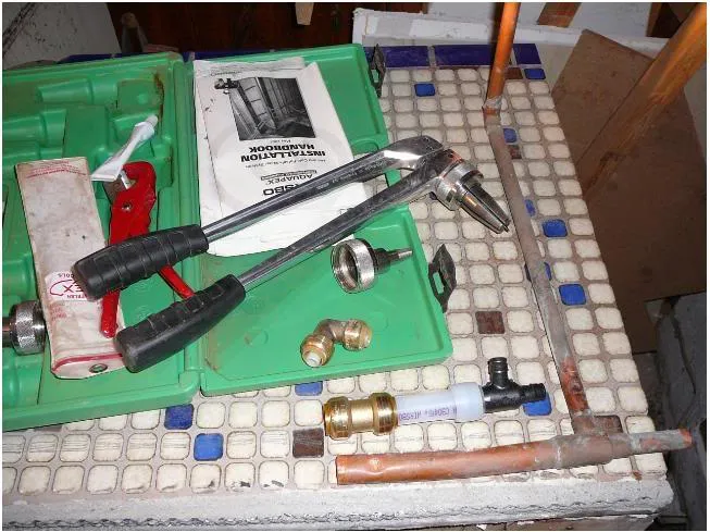

Our area is gold country and acidic water along with highly mineralized ground causes copper pipe to dissolve and disappear in a short time -- just a few years.  What I took out today was paper thin and had cracks spewing water.
I will be changing all of the lines in this house but in the meantime I wanted to stop the leak so I didn't have to crawl through mud in the crawl space.  This wall and floor had to come out anyway due to rot and pipes in the wall needing changing.

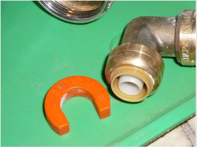

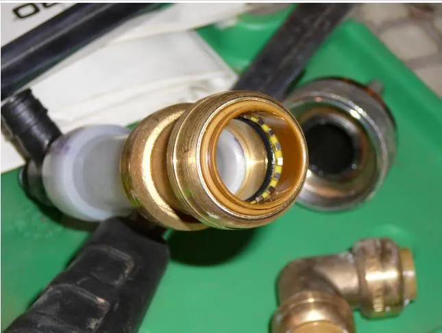

I ran a new line to the toilet but was not ready to go under the house so I used a repair coupling called a Shark Bite.
You can see the teeth and seals that make connecting it take about 1 second.
Here is the pipe I removed along with the manual Uponor/Wirsbo Aquapex tool.
The removal of the Shark Bite coupler only takes a couple seconds with the removal tool -- just slip it over the pipe - push on the collar and pull the fitting off.
