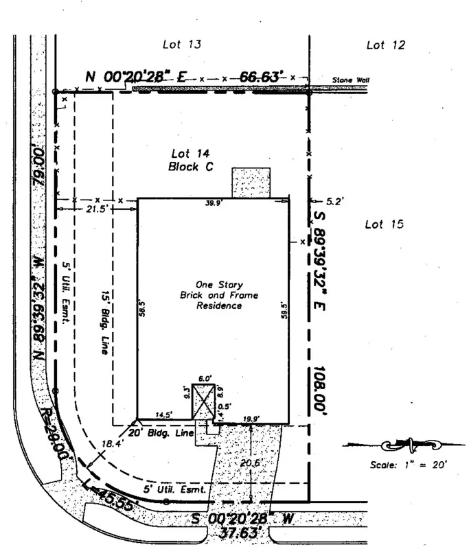

We are starting to develop the basic design. For starters, this is a survey of our suburban property:
Due to HOA restrictions, any utility building must be out of view when looking towards the property from the street in front of the house.  This being the case, will will have to build it somewhere inside a square area bounded between the the 39.9 feet length of the back of the house and the approx 30 feet between the house and property line.
Our first thought is to build it along the back of the property with the playhouse front facing the back patio, where we have a sliding glass door so we can see it from the kitchen.
