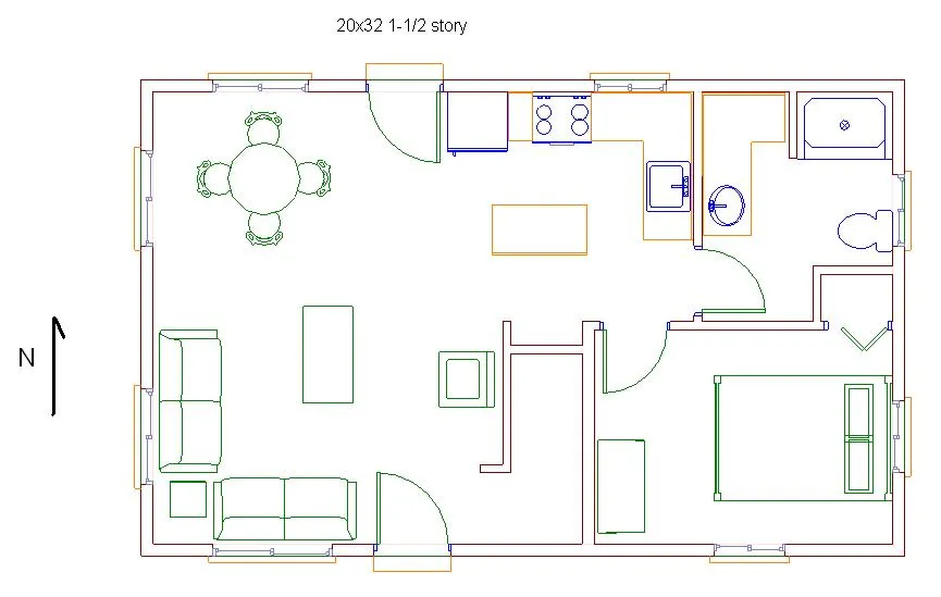

Real good looking project.  I'd love to see the floorplan if you have it.

Thanks for the compliment.  I don't have a scanner so don't have a way to get the floorplan into my computer. The floor plan is basically the Country Plans 20x30 1.5 story floor plan suggestion with a 6x6 pantry inserted on one side of a short hall and a 6x10 utility room on the other.  The bath and bedroom are at the end of the hall. Hope that helps.

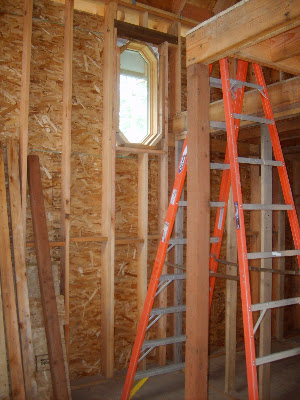

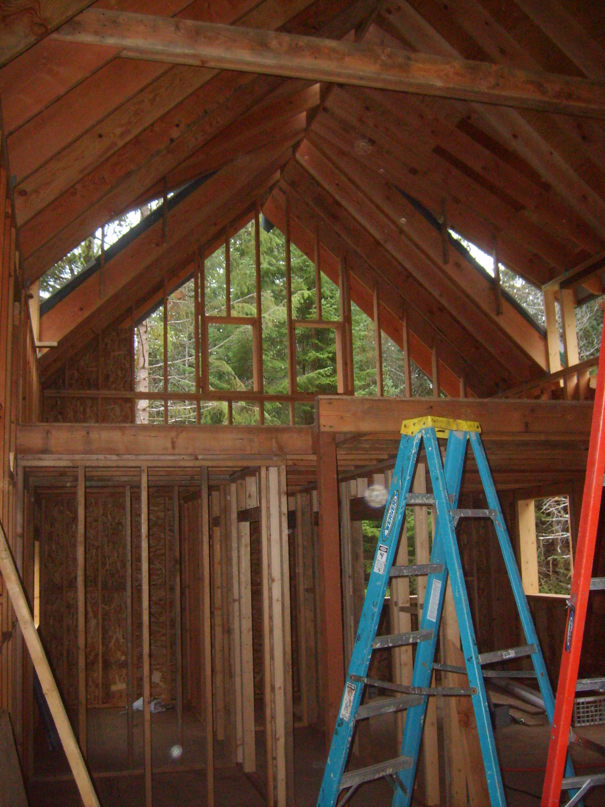

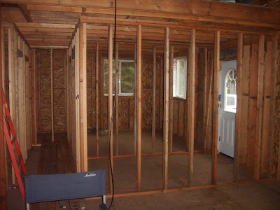

Instead of bringing the closest floor joist all the way across per the plans I am going to make the loft railing the rafter tie.  I opted for a more traditional stairs rather than a ships ladder.  We both have onset of old age problems and I wanted a less steep climb. On the other side of the issue we lose some floor space. That's the pantry behind the first wall, with bathroom behind that.
One of the custom windows I was given.  This elongated octagon window will be at the stair landing.

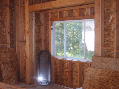

The windowed door is to the mud/utility room. That room will be for mechanical, water heater, water softener, laundry, jackets, boots, etc., with bedroom behind. The hallway is only 36" wide. At first I wanted slightly wider, but eventually realized I was thinking like a Californian. Up there most buildings are smaller in every way. Many twelve month residents thought I was building too many square feet and way too much openness with the cathedral ceiling and open loft. It is a lot of cubic feet to heat in winter, but we plan to insulate well. I suspect I'll have more to say about that two years from now.  Opposite the utility room is a pantry (not pictured). The plans suggest a stack washer/dryer between bedroom and bath. We opted for a slightly wider bedroom closet and will have a linen cabinet at the end of the hall instead of washer/dryer.
Paulette's bumpout. She really wanted this place where she could sit and read or do cross-stitch. I may or may not put the second octo window in the side of the bumpout. I framed for it but it just seems a little bit of a tight fit. I'm not sure it will look balanced from outside.
