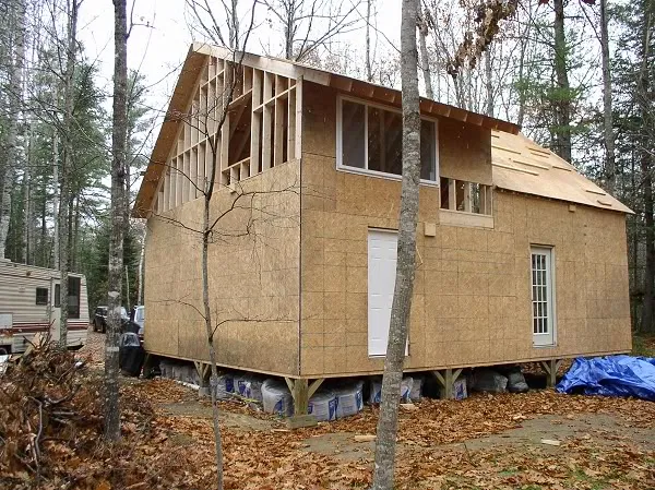

The loft will be the end over the bathroom, kitchen and bedroom.  The backside will be a full 8' wall with a shed style roof.  Basically half of the back will be a shed dormer.  So when you hit the top of the stairs it will be an 8' ceiling.
I hope it's ok that I'm borrowing an image from another members thread.  This is from Don & Ginger Lundgren's thread.  This is what the back will look like and why you won't hit your head at the top of the stairs.
