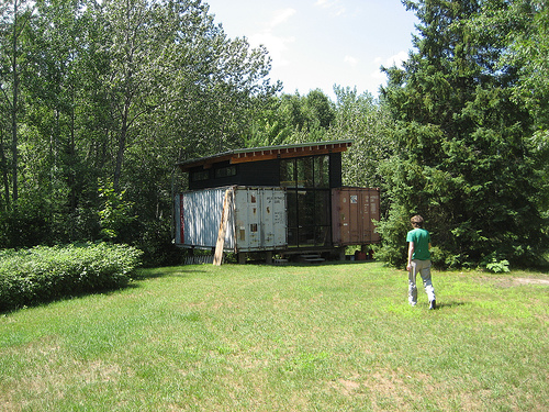

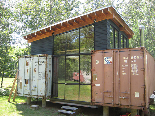

Not surprisingly, there is quite an extensive article on container architecture on Wikipedia.  Here is some pictures of a small house in Minneapolis that includes two containers:
http://www.flickr.com/photos/roludsgn/1036204298/
bayview
Quote from: Pox Eclipse on January 12, 2010, 12:57:19 AM
  Another eyesore . . . Is there a reason these containers can't be painted or sided with something?
