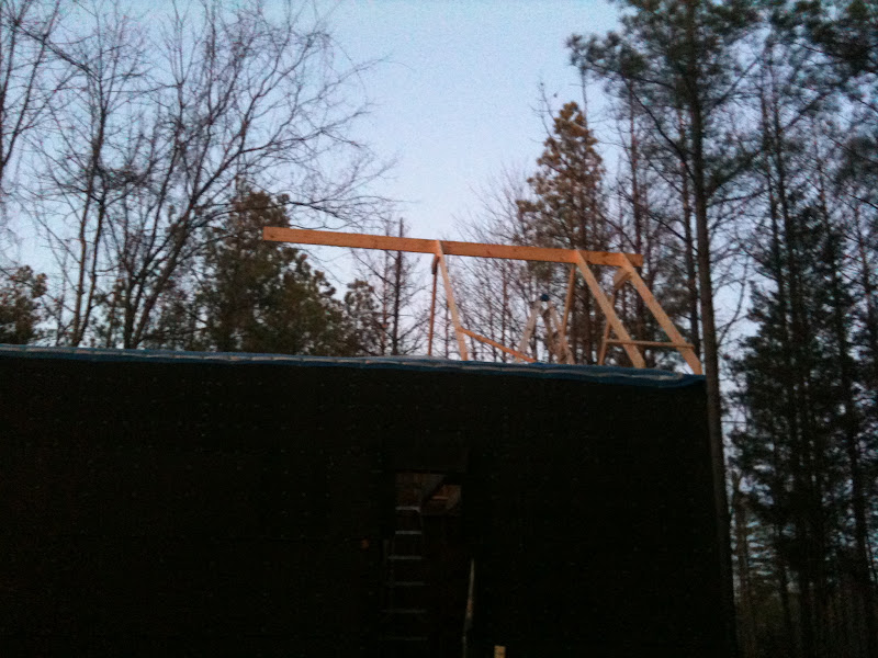

Hi Folks,

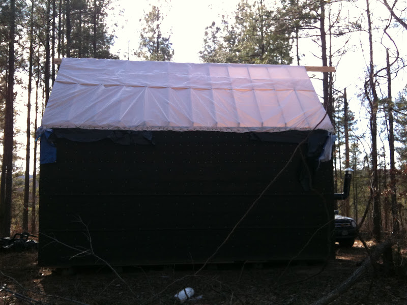

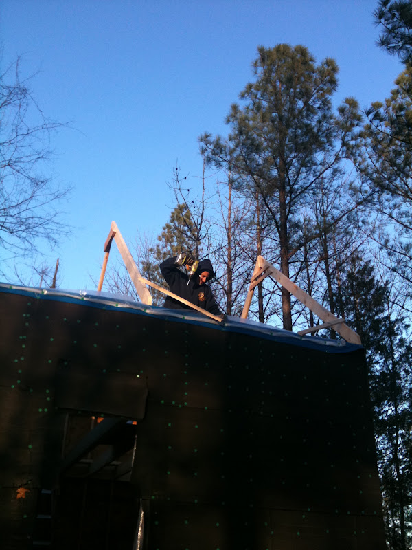

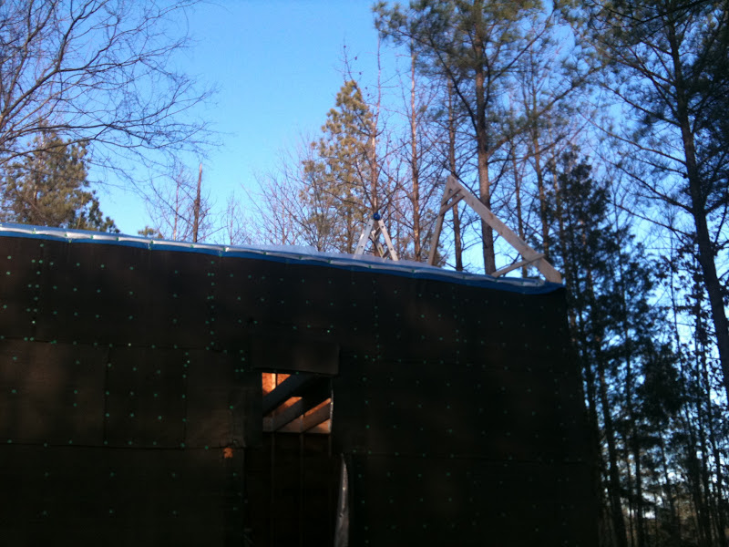

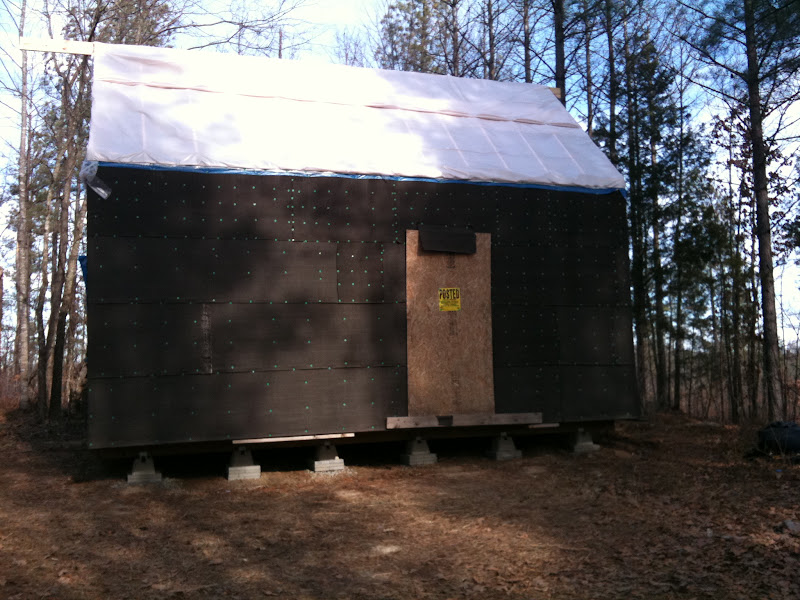

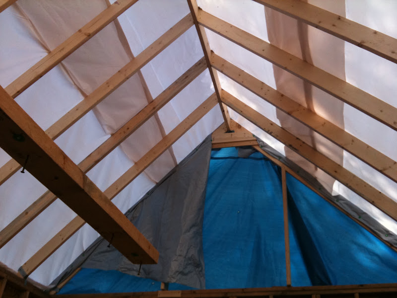

Just checking back in.  Thanks so much for the tips/help/support.  Ended up not having to go it alone.  My friend - who is very handy with a tool bag - came along.  Neither of us had ever framed a roof before.  I don't know how I would have done it without him and the help from this forum.  And man was it cold!!  A few pics:
Whew!  That's one!  :)
Starting to look like a roof frame!

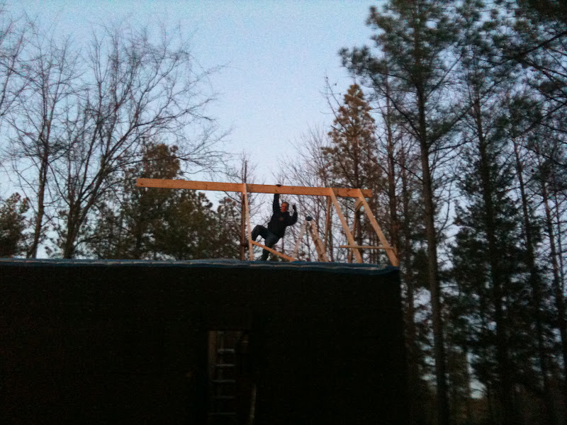

My friend John testing the ridge beam.
All rafters up and covered with 6mil plastic
Back of cabin
Buttoned up till next time
And you are right OJH - more space in the loft than I imagined!
Thanks again to everyone!

That's the best George!  Getting it closed in like that and having help to do it is awesome.  One thing I've found is that the 12x12 pitch allows the snow to fall right off too :)
I might worry a little about the plastic though and the collar ties...no chance you can get back for a quick trip to put a tarp on instead and a few collar ties?  Or did it feel strong as is?
