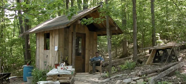

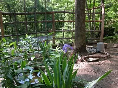

I'm so happy to see that someone else has their priorities straight!  We have two tiny cabins and an enclosed rose garden, which we've built while waiting for money to fall from the sky so we can begin the real house.  Of course, it helps a lot that we're living across the road from our own land.
And add us to the tarpaper fan club.  Our little front-porch-with-a-tarpaper-shack-on-it has weathered its first upstate NY winter like a champ, and has only recently acquired a bit of real live siding (and windows, since this photo!):
