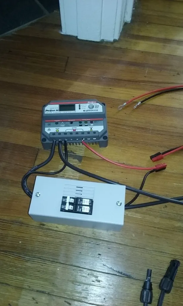

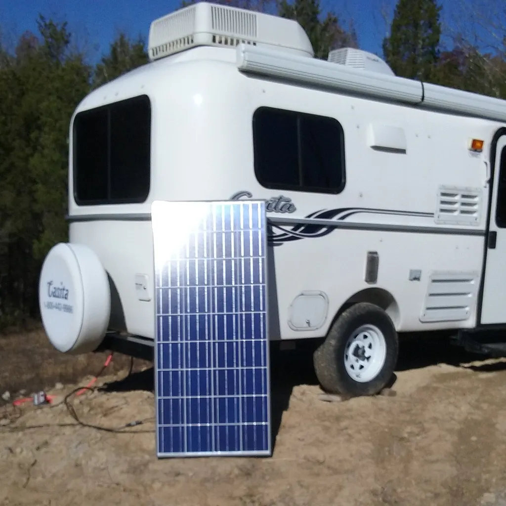

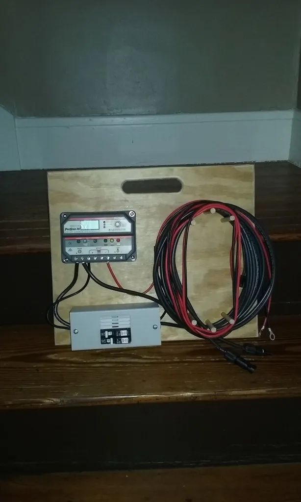

I ended up going with a self selected setup that I got from Northern Arizona Wind & Sun. Its a Kyocera 150 watt panel, a Morningstar ProStar 30 PWM controller and a midnight babybox with midnight breakers.  I bought a 30 foot MC 4 cable that I cut in half. I unded up having to upgrade the controller so I could be over $500 and get free shipping.  At lrast this way I can add another panel if I ever want to.   Below is a picture of my setup.  I decided to affix some cable with anderson connectors permanantly to my battery compartment so I can easily connect and disconnect.  The cable is incredible stuff it is the size of 12 guage but the strands are so fine with so much surface area that it is rated for 60 Amps.  The Anderson connectors I used ate rated for 45 amps.  I'm going to mount all this either inside a pelican case or just on a nice piece of furnature grade plywood cut down to size with a handle routed into it.
Mike 870
There we go, went faster than I thought.
