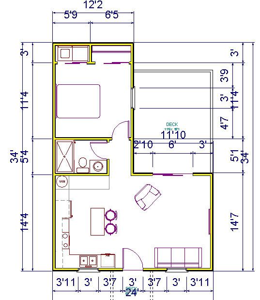

Soomb: Something like this:
I know what you mean about the kitchen on the left. The wife really likes it on the right, might have to let her know how much easier it would be on the left.

Selling points:  Less work, get up and morning coffee is right there (well with a small place, that will get you a stare), as you expand, the TV is further away from the bed room wall so one can sleep in on the weekend and not be disturbed by the other watching morning TV.  Or you could do as I would  "yes dear". ;D

Alright we are going to go with the last one with the kitchen on the left. Now I will have to modify my window framing between the two front windows, since on is 3' high and the other 4'.

BTW In one version you had the bath by the living area. Put that with the left kitchen and I think you got a winner. That way a guest wouldn't need to walk through your bedroom to use the restroom. Also puts the plumbing closer together.
It would be a real pain if you had a guest or two and you wanted to sleep in and they had to shower or do a doodoo.  They would have to go through the bedroom.
Taylor
Yeah the only guest that I have is my mom and she has a fifth-wheel trailer to stay in, or than that I don't have any other guest. I do really like having a bathroom in the bedroom for the late night call of nature.

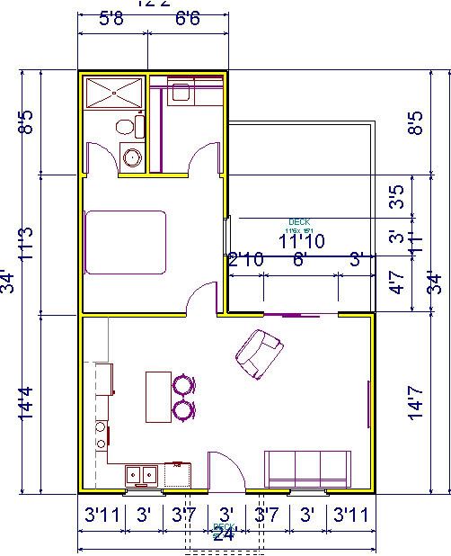

bayview

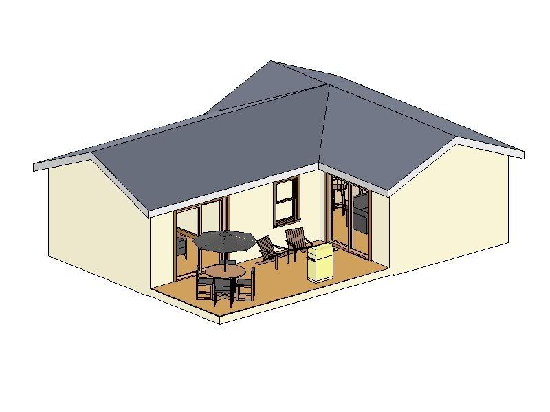

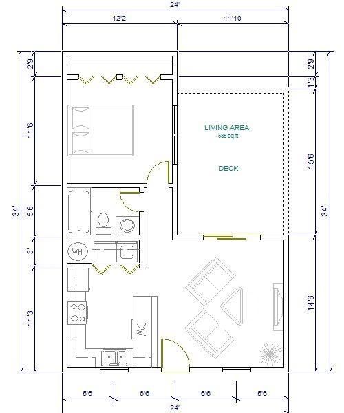

   Here is a plan I had previously worked. . . Similar to what you are doing. . . (Yes, I have no life) ;)

Bayview: That is a really nice floor plan. Looks like both sides are 14' wide, I would try it but my bedroom "wing" is only 12' and it would start to get a little tight.

bayview
Quote from: Taylor on January 14, 2009, 02:00:10 PM
  Ok Taylor,  I flipped it around and made the bedroom wing 12 ft.

bayviewps: You must like designing floor plans like I do, I don't know how many different plans I have done. That looks pretty good there. The only problem I think I would have is the wall between the kitchen and bath is a load bearing wall. And when I framed up my door opening in it I set it over from the right wall a little bit so I only have about 7'6" from the left wall to the door frame and I think that would be to small for a bath, so I would have to reframe that wall with a header for the opening. I wonder if I could double up the ceiling joist where the rafters/joist meet it and use some hangers to support them over that opening, but I don't know.
But I might have to look in to doing that since all the plumbing is right there in one spot.

BayView:  I hope you don't mind that I snapped your layout into EverNote for the future.  I am working on sketch-up to develop my first attempt, "an ATV shed" for land we are looking at.  I had the lay out as one long rectangle and was not sure, with the lay out I had, how or where to add on in the future.  Your design would allow an easy addition of another bedroom to the lower portion of the sketch where the door is now.  AND since I am following BishopKnight and SpeedFunk as they use earth berm designs, the left had side is window free and could be earth bermed.

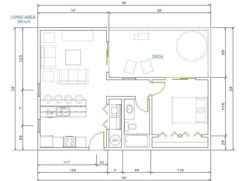

Taylor
Yet another idea we had, well it is a different version of a idea I had. We really like it. It has lots of storage in the kitchen with the full height cabinets.

Thanks for checking in. I did decide about 99% sure I am going to go with the last floor plan I posted.
