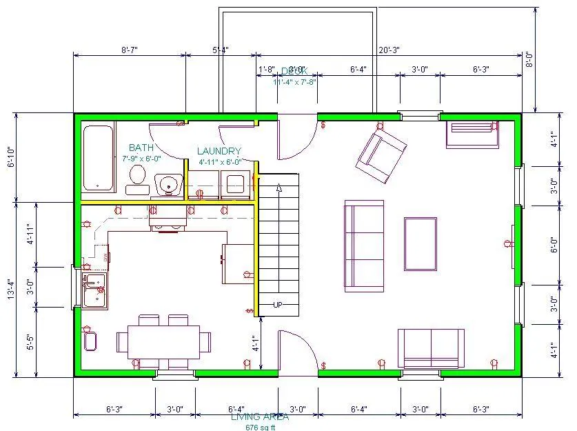

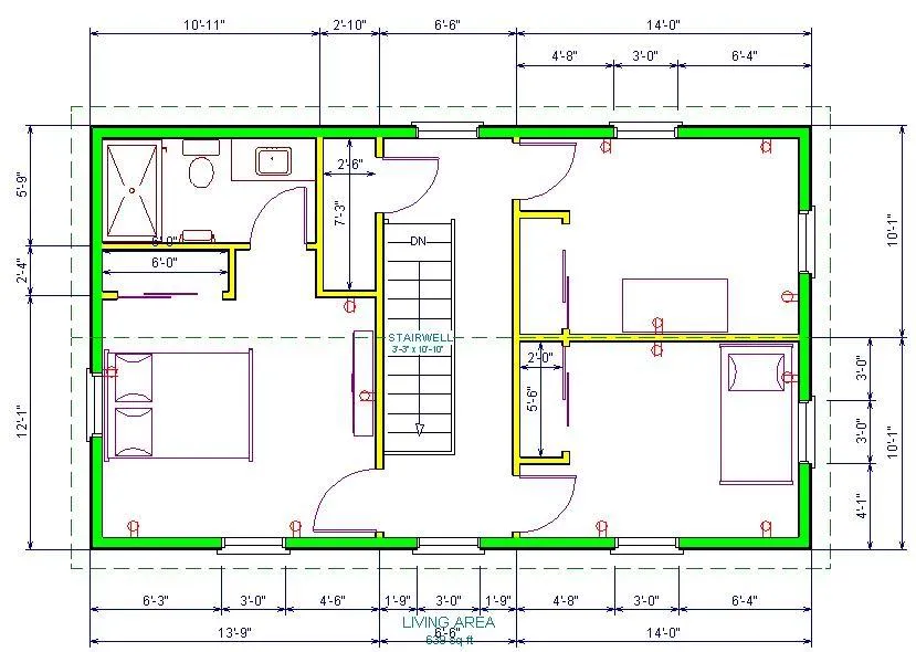

Here are the floor plans that I made with BHG Home Designer 6.0 have came up with for the house, it will just be me and my wife living in it full time. Let me know if you see any wrong with what I have, on the 2nd floor I made the hall closet bigger to run HVAC through which I plan to put the furnace under the stairs.
I plan on building this on a crawlspace which will be concrete block with rock veneer on it. I have a question about my crawlspace, I plan on putting a thick plastic down with gravel on top in the crawlspace, I was wondering if I have to put vents in it or not. I will post some pictures of the land and stuff.

 w*  Looks like a good plan to me  :)  The only thing I would change would be access to that closet you have at the top of the stairs - I'd want the access through th bathroom - if that is possible...  A woman never has enough closet space  heh ::)  But you may have other plans for it...  It's always nice to be able to get stuff when your in the bathroom or bedroom...  I know you already have a closet in the bedroom - do you have a linen closet in the bathroom?  Just a thought...  otherwise it looks like you've made good use of the space, in my humble opinion  :D
Taylor
Thanks for the feedback Sassy. I was planning to have a good size vanity in the master bath for storage about 5' long with dual sinks. I was planning to use the closet up stairs to store blankets and stuff and maybe I was think of putting a laundry shoot in there since it is over the laundry room, but not sure about it.
Thanks
Taylor
that sounds good  :)  Glenn asked me "why in the world would they need a closet in the bathroom?"   ??? heh

I put a lot of thought in the plan to get the most out of it. I tried a lot of different size foot prints and nothing came close to being as functional as that one. I don't think I have seen any floor plans like this one.

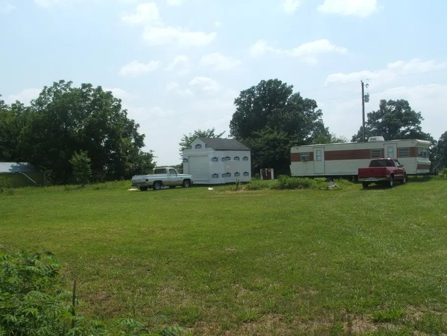

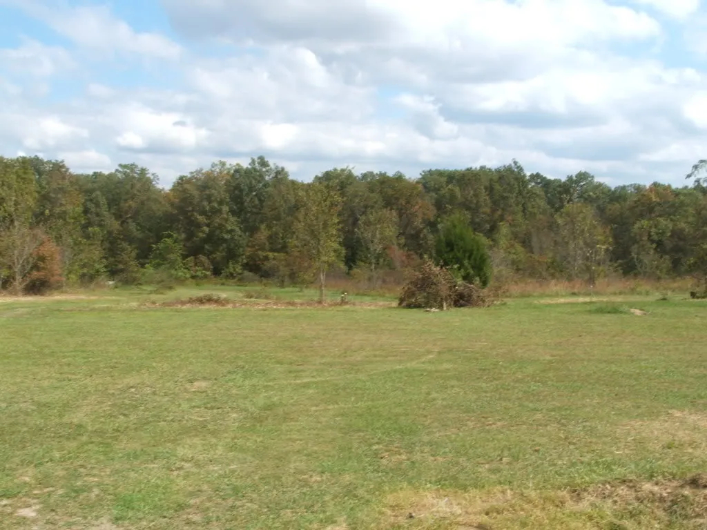

#11

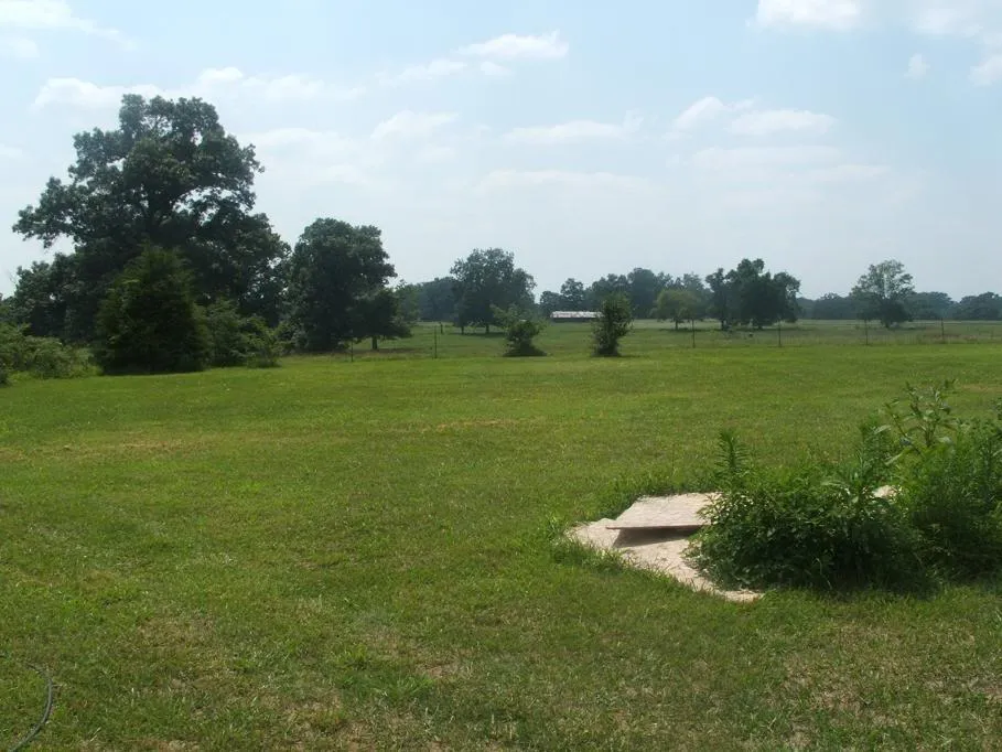

Here is a picture of my trailer and shed that is a couple months old. I plan on building the house about 5-10' in front of the trailer. I only really have one neighbor which you can kinda see in the picture, behind and to the other side of me is farm land and across the road is woods.
Out the back:
Out the back at sunset:
Out to the north at sunset:
Out the front of the trailer:
I still have a good about of brush to clean out, hope to finish it this fall.

Taylor:
Nice site and a good floor plan layout. I would work on the window layout and get more light into some of the rooms. The 2 bathrooms should have an opening window and I'd put at least a 5' wide window in front of the kitchen table.
Taylor
I was planing on putting some windows in the bathrooms, I just haven't decided on what size to put in there yet. I am not to big on windows, they are going to have blinds and curtains over them that are probably never opened, or that is how it has been in my other homes, lol. I really like stuff to be symmetrical, and that is why I have the windows like they are, kinda of a greek revival look. But thanks for the input
Taylor
I have some thoughts...
I'm looking at that back door... the one to the deck and thinking I'd prefer to have it hinged opposite to what you have. My rationale is that way it could be opened fully against the wall. In warm weather you could then have an outside opening screened door for the ventilation when desired. Just my thought.
The front door could be opened full against the wall as it is. We like to be able to have a screened door, or a full glass exterior door for the extra daylight they pass through to the interior.
I ditto John's thoughts on windows. The bathrooms should have windows (obscure glass if privacy will be an issue). Even the laundry room should have a window, IMO. Good windows will eliminate the need for turning a light every time the room is entered. On the main floor I'd prefer a 5 or 6 foot wide window by the table. With the one sofa facing that end wall, to me at least the end wall begs to have a 5 or 6 foot window centered, rather than two 3 foot windows off to the side. Unless that's where the TV is planned to be situated.
Unless one is using a refrigerated air conditioning system for much of the year, or it's too cold for open windows, all, or most windows should be opening, IMO. Both K and myself like windows for the both the sunshine and open feeling they provide. Yes, a window is a "heat hole", but using quality frames, at least dual panes, triple in the colder climates, Low-E glass, maybe argon filled, and so on is better than going for bargain windows.
The upstairs bathroom would be an ideal place to use a good skylight; once again that would eliminate the need for a light during the day. I don't like skylights in bedrooms though; too hard to make it dark for daytime sleeping if necessary. A skylight over the stairwell could work though.
... and speaking of windows... what type of opening window are you considering? I really like a good casement type for their terrific sealing ability. If mounted in opposite opening pairs you can catch breezes with them. They are pricier though. We like sliders over single/double hung by maybe 60/40.

On the open window thing, I live next to hay fields and they like to put chicken liter on it in the spring and fall, so having the windows open isn't really an option and I just like having nice cool a/c. I am going to be hanging my TV on the wall across from the couch, so that is why I got the two windows. I plan to go with double hung windows, just for the price and they probably won't get used much. I see what you mean about the back door, and I think I might chance it. The reason I have it opening the way I do, so that when I am carrying stuff to the grill, it is easier to get the door open and through it.
