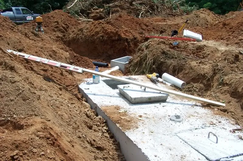

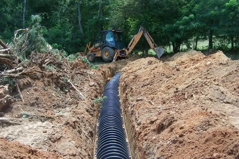

We spent aweek in hillsville on vacation, and finally got some things done. The entire septic system changed. It was supposed to be a 3br, but ended up going with a 2br. The reason behind thisis because the area on my property where we want to build is only about 130'x130' (then it drops off hard for about 100' and there's flat land at the bottom)and the drain field would take over most of my area. so after going around and around with the septic installer and the inspector we finally compromised on 2 65' lines.
here are my costs
1. 2br septic  -$2600.00
2. land clearing  -$800.00
3. well drilling  -$2624.00
4. bushogging  -$160.00
I wasted money on the bushogging. I didnt expect to clear the whole top, but at $85.00 an hour,and  the backhoe was doing such a great job I told him to just keep going.

The well driller only had to go 140' and hit water. I was so happy that I told him to go to 200'. they said I was getting about 5 gallons a minute. I was very worried about this Id heard horror stories about people in the area going a 1000' and coming up dry. the cost does not include pump or other well parts. I wont do that till later.
here are some pics.

Making good progress I see.  A little word of advice regarding your septic.  Yeah you know where it is but triangulate measurements from a couple permanent fixtures to the Septic tank lids.  You will eventiually have to go there some day and it makes it alot easier to find before it is covered up.  I took mine from the corners of the house to the lid.  If you haven't got the house yet take it to a couple of trees for now.  Then later you can go to that spot and then from the house corners if you decide to remove those particular trees.  I even went so far as to take measurments evey 20-30' of the drain going to the septic to find the line easier.  Make you a little map of the septic layout and include the measurements and put them with your other house papers.

thanks redover, I did map it out, they also put apiece of 4" drain pipe sticking up at the d-box and a 4" piece of schedule 40 sticking up in the center of the septic box that I could also ue as an RV drain.
I also wanted to mention for those who might want to compare pricing that I paid $8.50 a foot for well drilling. Everyone else in the area was $10. and I didnt know this, but they also charge you for casing(I paid $8.95ft@80') and grouting($150).This was all in the total.

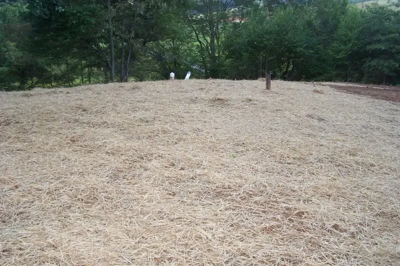

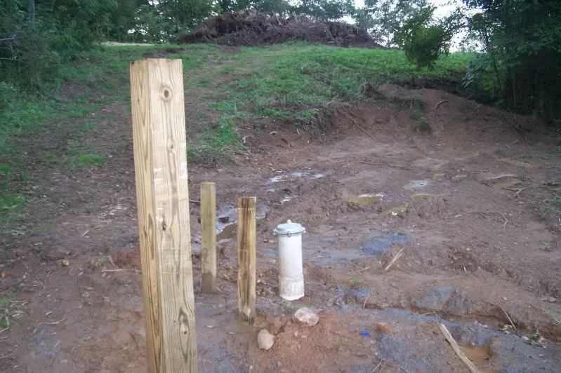

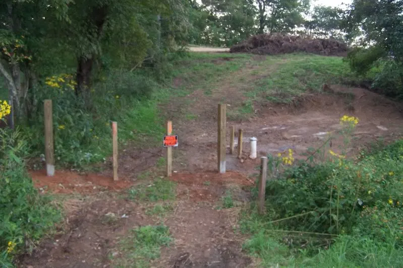

went to property this weekend. hand graded alarge area, mainly where the septic system is. put down tall fescue 31 and strawed it. did alot of burning, but as you can see I still have alarge pile left. I also put in and concreted 2 6x6 post where I will aventually put a12' cattle gate. but put 2 4x4 posts to try and keep people out. I also put post in front of my well head to protect it, because its right beside the drive way
