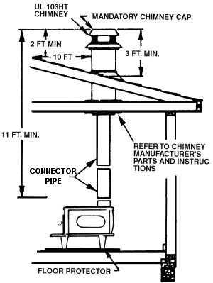

prohomesteader
I got most of the insulation turned around now and want some heat
I bought, and quickly returned a kerosene heater, now I want to install a stove, but I have some questions.
my main confusion is this, according to mountaindon and some internet reading
QuoteThe rule of thumb for chimneys is that the chimney should extend at least 3' above the highest point where it passes through a roof, and at least 2' higher than any portion of a building within 10'.
so because my peak is just 10 feet from the edge, that would mean my chimney needs to extend at least 2' beyond the ridge.
but then I see that peteH has an amazin looking chimney that breaks the rules above
so my questions are these:
1.  Will I burn my house down if the chimney is done like steve's? (I'm a wood stove newbie)  or better yet, any special considerations to think of?
2.  If it shouldn't be done like that, how would you build the chimney?  I want my stove in the front right corner of the house.  Maybe run the chimney up the cathedral ceiling to the ridge and then out the roof there?
Also, should it be this expensive?
$150 -stove, cheapest one from tractor supply
$80 - stove pipe to make it to the ceiling
$200 - a flashing kit with rain guard and roof brace at lowes
$120 -    6"x24" chimney pipe, $40 each, for on top the roof and through it, need at least three right?
$550 - TOTAL
Seems really high for installing the cheapest stove I can get.  You think?
(note to steve: sorry if you didn't like me using you as an example, but I'm really struggling researching chimneys for this place right now)
Jochen
If you have to follow code your are lost.
The minimum height of chimney required is the same for all support styles
and sizes. The diagram below shows minimum chimney height as
required by code. A quick way to calculate this dimension is to multiply the
vertical rise per 12" of horizontal distance (X in the diagram) by 10 and
add 24". When the chimney is installed within 10' of the peak it must clear
the peak by 24". The minimum chimney height is 3'.
But using common sense I would install the stove as you suggested, like Steve's example and see if you will have enough draft. Especially on windy, cold days. You can always extend the exterior chimney with another 24" piece. Maybe you have then to use brackets to support the chimney.
