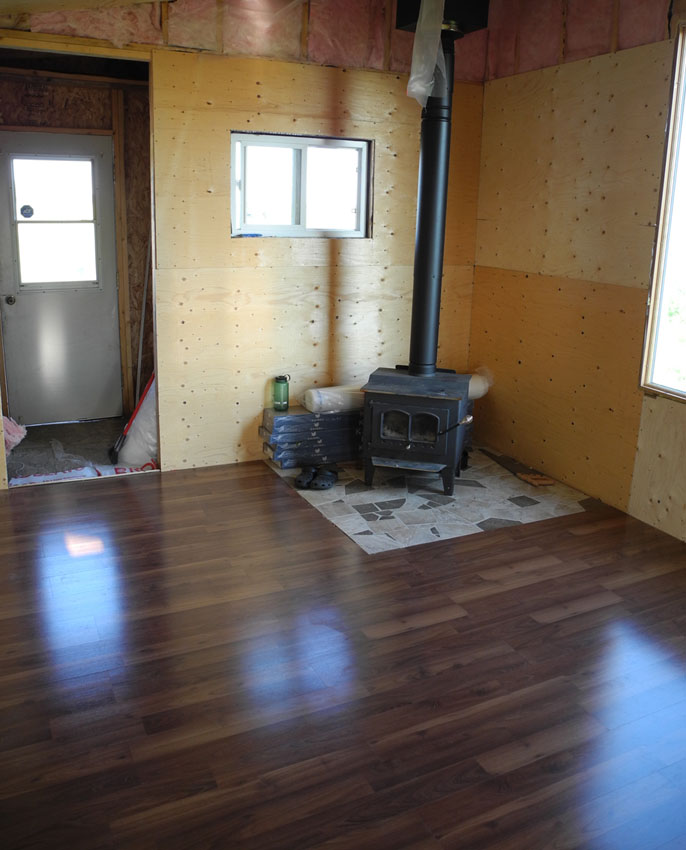

alrighty...got the stove in today.....
it is 18 inches from the back corner on the right and 14 inches on the left..just how it worked out......i am still planning on some tin or fireproof drywall...none the less this is where she is.

finally got part one of the floor in......
The floor looks really nice & I love the slate under the wood stove!
nathan.principe
Great work on the floors!
Kris
thanks guys....it went pretty good,,,the dome part is going to be trickier..lots of cuts to the end pieces..........

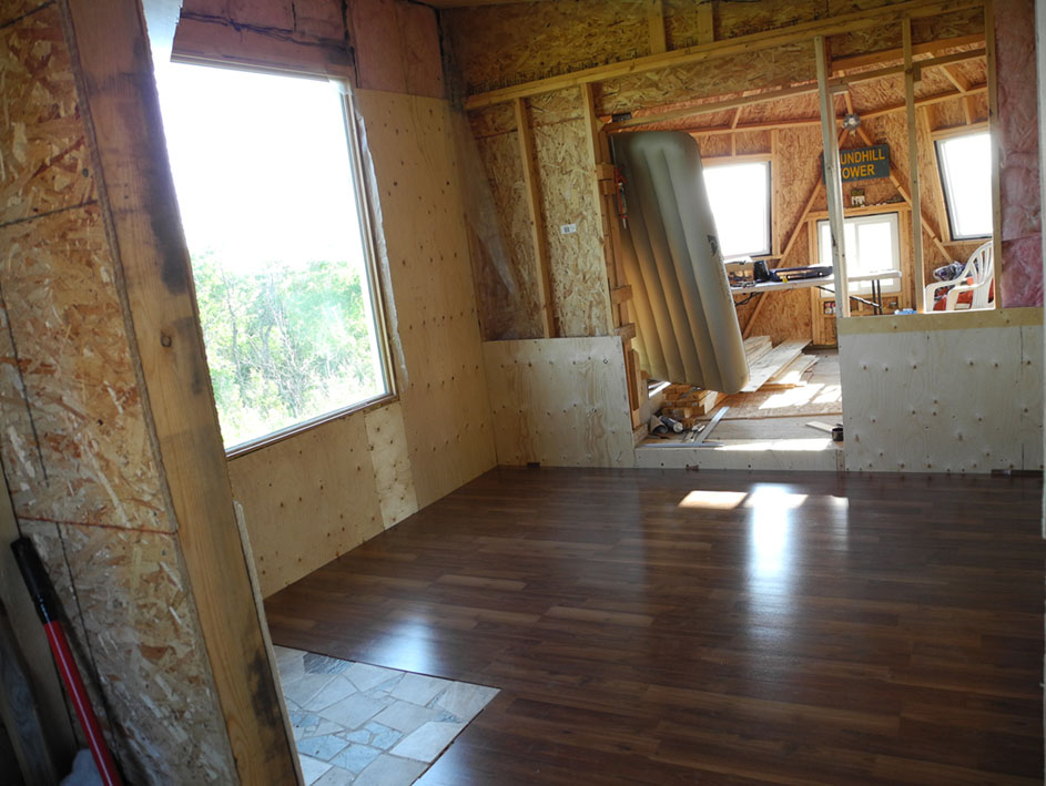

Kris
the icosa flooring,,halfway done....
Kris
Carla_M
I like all the windows in the Icosa room. I wonder how it feels when you walk from the normal room with perpendicular walls into the Icosa room? Does it challenge your senses? Definitely outside the box!  :)
The personal dietary habits of people kill more frequently than firearms. Eat healthy and carry a gun.
Kris
the rooms differ but seem to blend ok...
the lantern lights up the dome much more efficiently.  the main difference is the window placement. i arranged them to have different focal points...so depending where you are sitting you might get a canvas to the sky, one to the river and one to the ground.....i liked the idea of these different view points instead of one massive window to the river... it is all an experiment......
and the purpose of the large window is for passive solar. it really works in such a small space......i now need an over hang to cut the summer sun out!!!
