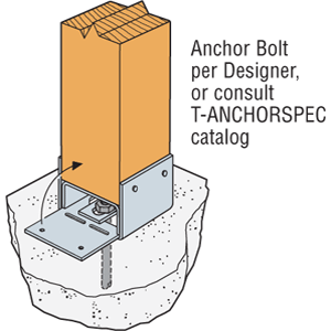

When you say rock do you mean , Large  rocks or ledge??

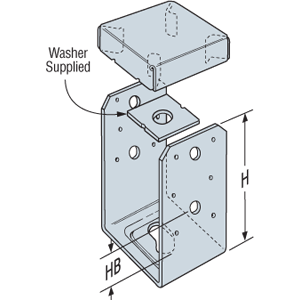

If it's ledge , I assume you'll have electric power , how about roto-hammering  a flat spots ,then attaching a Simpson bracket with  epoxied in bolts , drill whole inject epoxy , insert bolt into wet epoxy . Attach brackets to ledge via bolt when epoxy dries.
like this or similar ,
Place beams on posts , this allows for the posts to be different lengths to accommodate level beams .
How you line them up , string lines , laser etc , depend on local conditions.

Melonbob  w*.  I was also having trouble following you thread. I posted on the other before I realized this one existed.  If the rocks are substantial and willnot allow for convientional piers I think Peg has the right idea with the anchoring.  You had mentioned forming up on the rocks.  The only problem is that you have to form in most cases such a large area to conform to the different angles of the rock ( prevent it from slipping or slidding off) that you will end up with more concrete that the rock ever was as far as mass.  Then again you will have to pin the rocks to have something for the concrete to adhere to.
I guess that when you get it cleared you will have a better idea of what lays where and how to address it.  Shoot you may have rocks that will line up for what you want. ;D
I think a well set rock about 2 feet in diameter is good enough for a pier -- I just drill an hole in them with a rotohammer and set a pin or rebar with anchoring cement such as Rockite or Pourstone.
