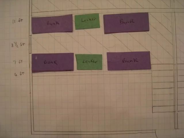

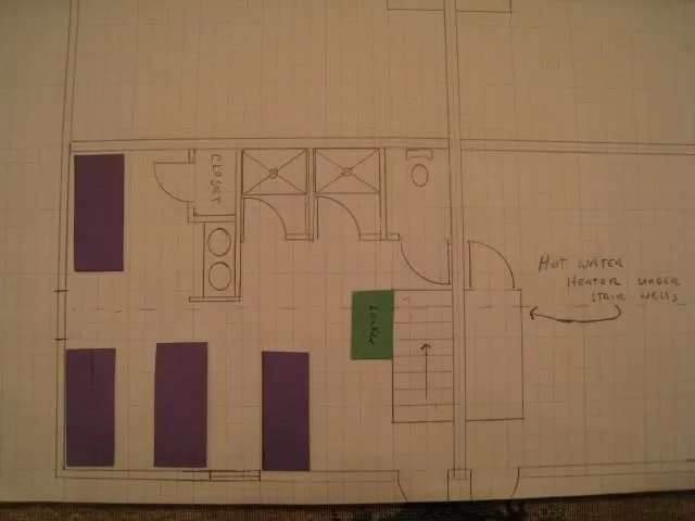

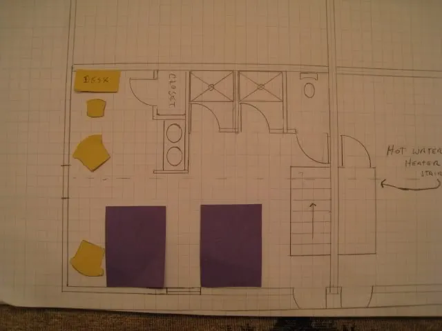

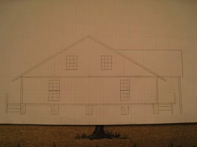

Here are the diagrams / plans of the camping lodge.  We will have a dining room in a separate building, so there is no kitchen here.  I've pictured four bunk beds up in the loft along with a couple of queen beds on the lower floor.  All the plumbing is located on the lower floor.  Have the front entrance covered, and would like to do the same on the back of the cabin.  Will likely not do so because of added expense.
Also pictured the lower floor with bunk beds and no adult furniture.
I'm open to any suggestions you may have.  Hopefully there will be some obvious gaffes that need correcting that you guys can alert me to.  And, better yer, maybe you will have an entirely new idea of how we can go about this project.

Shubutakid:   Great thoughts.  I realize your plans are in the rough stages at present, but would urge you to consider all building/fire codes in your area that have to do with housing/sleeping people in new construction.  Most states have them and some are stringent, even for "camps".  This is true of single story installations, but even more so with multi-story facilities.  Another concern I would have initially is that some provision be made for ADA accessibility, specifically, steps, exits/entrances, and access to toilets/showers.
Best of luck in your project.
Steve
