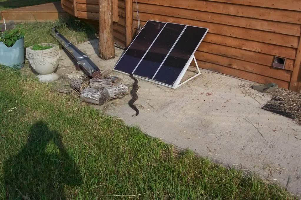

Well I guess it is the season.  I had went to my friends cabin on top of the mountain to remove a battery from his generator that had frozen during the winter.  This is what I found on his front stoop as I went to the front door.  I am sure glad that I saw it first.  Can you imagine walking out your front door to this in the early morning hours.  Apparently it wasn't socialable and slithered off.

Well I gave him a fighting chance but he refused to give up.  I returned to my friends cabin to work on his generator again this morning.  The snake was there again to meet me at the front door.  No mercy this time as it was apparent he was not leaving.  Come to find out that another neighbor had just killed a yellow ratler so I would imagine it was the mate.  Maybe my son can make a belt out of this one.  He might have to fight his sister for it though.

Yep plenty of black snakes lying on the road.  Maybe going for water as this week has been dry.  The ratler was using the concrete to warm up I guess as the nights on the mountain top are a lot cooler than in the valley. The owner is coming up this coming weekend and probably bringing the grandkids so I figure it was time.
Quote from: Redoverfarm on June 08, 2011, 07:07:46 PM
I wonder whats been using that dryer vent without the flappers on it for a entrance to the place??   :o

Yes Peg you are correct.  It is a dryer vent.  The louvers had fell out at some point.  They have been replaced.  But that was just a minor fix in comparison to the gas refrigerator that quit working at some point since last winter as well as the water pump.  The contents were [yuk].  Well all of that is cleaned up now. Am waiting for a battery for the generator which is on order and hopefully it will arrive before the owner does.  If not I will be making a trip every 10 hours to refill and start or come up with a replacement battery to temporarily to use since the owner is in failing health conditions and it is doubtful that he will be able to start it. As you can see the winters are a little brutal there with the snow taking down the gutters.  Well that is another day.  ;D
