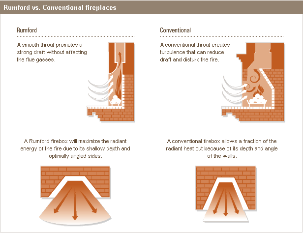

John, here is some more fireplace info. relative to Rumford type.
This is from the renaissancefireplaces.com web site showing some of the differences of conventional fireboxes to a Rumford design.
Your fireplace is likely more like the conventional design.  If your firebox is more than 13 or 14" deep then it's too deep.
It should not be a major problem to reshape your fire box, but making a smoother transition to the flue could pose some challenges.
Reducing the opening by extending the lintel down might help, but then the flue size may be too large.
The ratio of the flue cross-section area to the fireplace opening area should be between 1 to 10 to 1 to 12.
So if your fireplace opening is say, 36"x36" then the flue should be between 130 to 108 sq. in. which is about 13" ID to 12" ID for a round flue or about 12"x12" inside to 10"x10" inside for a square flue.  So for instance if your flue is say 12"x18" then it's probably too large.
If you reduce the fireplace opening say by 4" making it 36"x32" then the flue size requirement becomes even smaller or your current flue is that much more too large.
