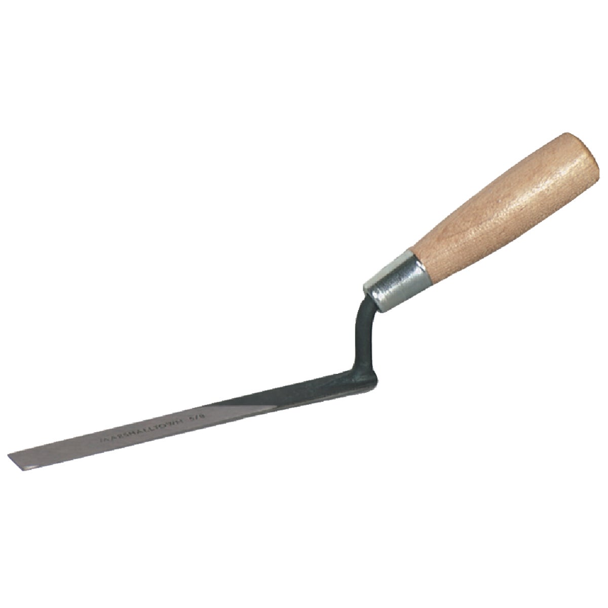

Are you using a hawk to slide it off of into the joint?  Seems that would work well for chinking too.  Like this.
benevolance
glenn what is that thing you pictured... a tool for putting mortar into joints... if so I need one badly!
There are two things there.  The bottom one - you hold the yellow handle - it is just a table for the mortar called a hawk.  You put a gob of mortar on it to lift it to the work area.  Set it beside it and push it to the joint.  The top one is called a margin trowel - about a 2 inch wide flat trowel you could push the mortar to the side with -- there is another one that may be of use to you.
Called a Tuck Pointer Joint Filler
http://doitbest.com/main.aspx?pageid=64&sku=323956&memberid=0129&associate=true
