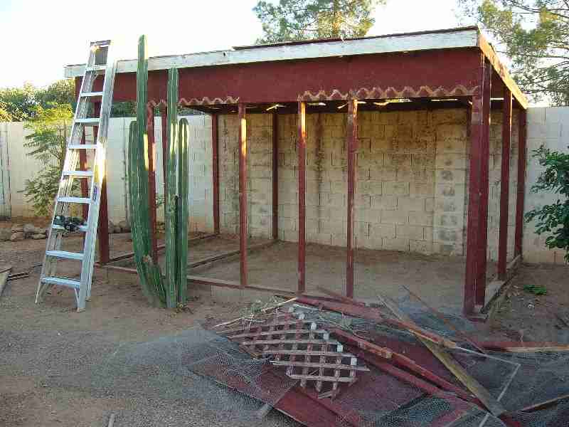

Ok, I'm posting this for all the do-more-with-less design geniuses that contribute here.  Here is my dilemma.  I have a birdcage.  Actually it's the former owner's bird cage. I have never had a bird in it.  Anyway, it is out in the back yard, and it measures 16x10.  I want to make something useful out of it, like a ramada-zebo sort of thing.
The floor is dirt and the roof is OSB. It was rather amateur-built with 2x4 framing and 2x6 roof joists. Nothing really on center. The back wall of it is actually the back wall of the yard, of block. The bottom plates sit on concrete blocks set more or less level around the perimeter.
I've thought about using pavers for the floor inside but I need to keep this low-budget.  The wifey suggested a ply floor which would be quicker and cheaper.  Out here in the west we like to set up those outdoor firepits and chairs and things which is sort of the idea here.
Any input, ideas, anything?

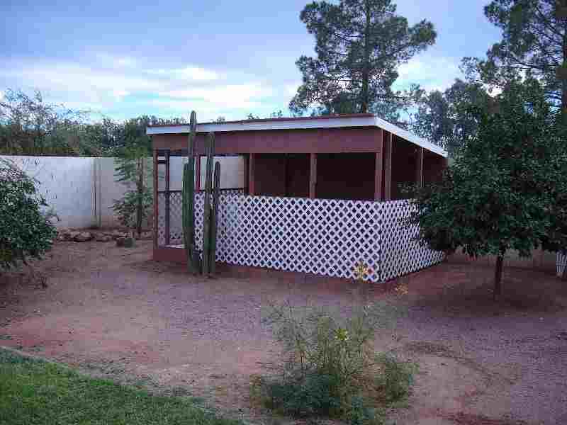

Well, it's done. I built a wood floor using 2x6 joists and OSB. I made a rail and added the wicker front.  I replaced all the roofing and painted the whole rig. I even added some solar lights inside (HD, $20)  Total cost was about $300.  I did get to buy a new Wagner Paint Crew painting outfit. It worked awesome.
This was the first time I ever built something like this - seems simple but I learned a lot - mainly, start it off plumb, level, and square and use standard dimensions as much as possible.  The original builder didn't get any of that.
I still don't know what it is though.  A ramada something or other.
Level and Plumb. Two excellent words all carpenters should live by. Everything else will fall neatly into place.
Looks better. :)
