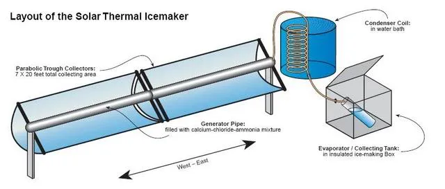

Don't forget about our member, Gary's website-- lots of free stuff there.  http://www.builditsolar.com/
Gary has a link to the Solar Ice project from Home Power. I thinke I have a copy of the PDF somewhere.  It used to be free but is now a $5 archive item from HP.
You could build one from the information in this PDF.
