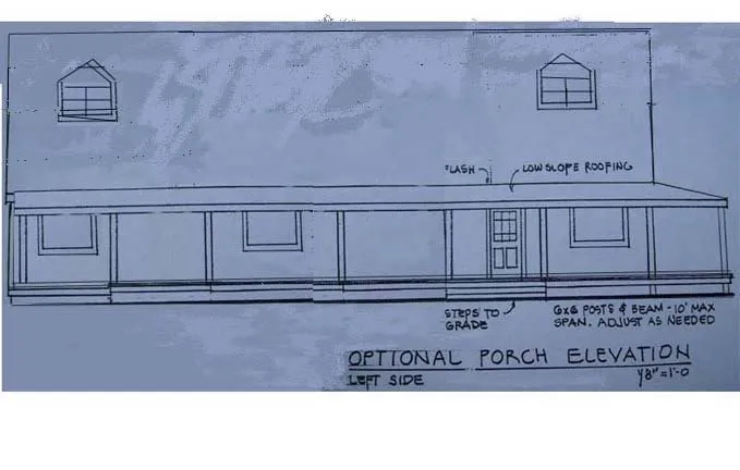

This was the basic 20X30 single story before the hatchet job.

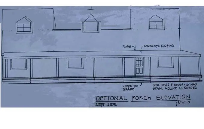

I spent the better part of the night playing with the pictured design is not to scale.
Total length will be 70'
I raised the roof on each end 4' with a loft under each raised section.
Assuming I place additional piers under the ends and use collar ties on the stick built 10/12 roof and that the raised sections are no more that 20'long,
will the I have any problems?

Single pitch on one side as pictured (all 3 sections on the same plane?) and back side only with shed dormers or 2 different pitches? :-?

peter nap
Single pitch all around with 2 Dormers on the front side.
The thing in the middle is my sad attempt at a cupola :-[
peter nap
OH....I think I see what your asking. I added a 4' knee wall to the end sections but the roof pitch will stay the same.
If I understand right and you are adding 4' to the sidewall height of the end sections (thus pushing the roof higher) wouldn't you have these sidewalls showing above the porch roof?
peter nap
Duh.....I need coffee. Your right. I raised the whole thing 4 feet. Does that present any loading problems?
#6
Not as long as the walls are tied together. But run it past your inspector first as there may be local issues such as high winds.
You might want to do a cross section through the place to make sure the walls and roof pitches do what you want. You can modify the one in the plan just as you have the elevation.
